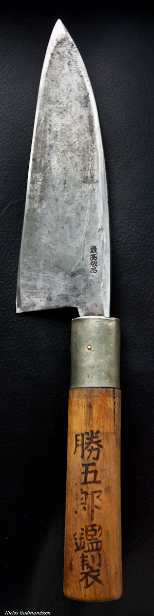

For some weeks ago I found a nice Deba kitchen knife that was in a bad shape, and I bought it really cheap.

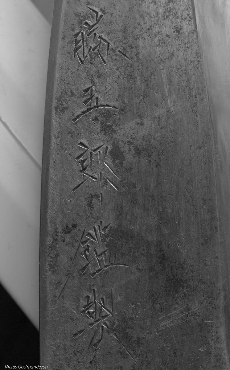

Now when I have been polishing it I would like to know what the signature says on this thick deba.
Thanks in advance
/Niclas

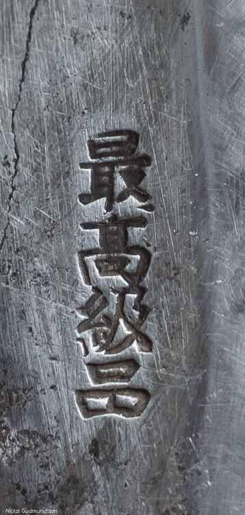

the stamp says "Saiko Kyuhin" (best grade)
the signature says (I think) "Shogoro Kan?sai" meaning maybe "Shogoro's pattern"....this is a Morita san or Moriyama san question I think.
The handle inscription is the same as the "signature" (only clearer), I think this is said "Shogoro Kansei"
I think this must mean "Shogoro's pattern/manufacture"

鑑製 equal 監製.

#2 pic says:
"Made by under supervision of Katsugoro/Shogoro."
In this case,Katsugoro/Shogoro means smith-name or style or work shop 's name.

Ok the blade are not made of the one that inscribed the blade ? It is just a inscription that a shop or so has.
