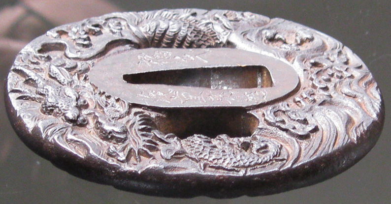

FlorianB Posted June 19, 2011 Report Posted June 19, 2011 Hello everybody, I want to show You a tsuba I own, probably from the late Edo period. The measures are 7,3 x 6,7 cm (about 2,88 x 2,64 inch) , thickness of the seppa-dai is 0,75 cm (0,295 inch). It is signed „Shigejuro“ or „Mojuro“ (thanks, Markus, for translation help!) with Kakihan, „Tachibana uji“ and on the reverse „Sesshu ju“. Because Tsuba are an ancillary interest of mine I have only a few reference books and I wonder if anybody can give me some facts about this man? My second question concerns the quality of this piece. On the one hand the body of the dragon is precisely cut and shaped, on the other hand the modeling of the waves appears to be flat in spite of the thickness. Furthermore, the design runs vividly through both ana, the rim, however, is plain. I would be grateful to hear Your opinions. Florian Quote

Soshin Posted June 21, 2011 Report Posted June 21, 2011 Dear Florian, Nice tsuba the low relief craving is really good. The dragon looks evil and angry possibly coming out of a tsunami wave. Could you show a photo of the tsuba rim? The style reminds me of some of the better work during the late Edo Period and thickness of the plate also points to that time period as well. Thanks for posting the tsuba for discussion. Yours truly, David S. Quote

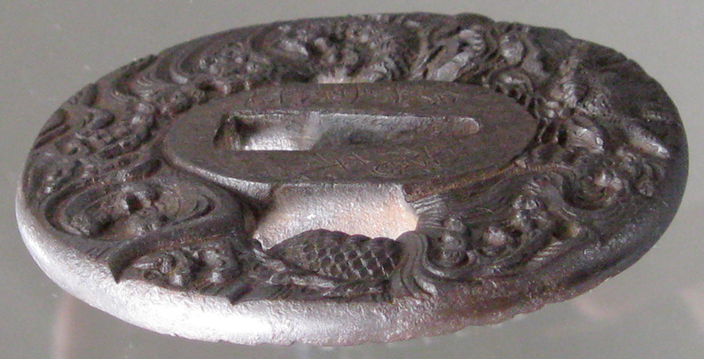

FlorianB Posted June 21, 2011 Author Report Posted June 21, 2011 Hi Guys, thanks for Your responses. At first I want to point out that I’m not fishing for compliments - thanks anyhow . Secondly, two additional photos: To specify my problem, I learned that the more detailed, precise and deep a carving is the better is the workmanship and thus the quality. In this tsuba I see a discrepancy between the shaping of the dragon and the mould of the waves. IMO due to the plain rim the tsuba appears to be incomplete, too. Did the maker lost his interest or did a student collaborate? Or are there practical or aesthetic reasons (i.e. an intentional contrast)? Greetings, Florian Quote
Soshin Posted June 21, 2011 Report Posted June 21, 2011 FlorianB said: IMO due to the plain rim the tsuba appears to be incomplete, too. Did the maker lost his interest or did a student collaborate? Or are there practical or aesthetic reasons (i.e. an intentional contrast)? Greetings, Florian Hi Florian, If a student collaborated in making the tsuba often it would bare two mei on the seppa-dai. I have one tsuba like this in my collection and have seen a few others like this as well. I agree the rim does look a bit unfinished or it could of had a fukurin or soft metal cover (like shakudo or copper) that was lost at some point. Overall I still think it is a nice tsuba and above average for the time period it was made. Yours truly, David S. Quote

Soshin Posted June 24, 2011 Report Posted June 24, 2011 FlorianB said: Could there be any details specified which prove the quality or is it necessary to compare this piece with other ones to get an impression? Hi Florian, The detail and deepness of the carving of the dragon is dynamic and intricate the first thing that points to the above average quality. This was noted above by others as well on the message board. The carving of the water waves is also good enough to produce the effect of obscuring parts of the dragon's body indicating that has just about to emerged from the "monster" wave to wreak havoc. Generally speaking there is master work from all time periods but the overall quality of pieces from the late Edo Period is fairly poor compared to earlier times in the Edo Period. You can get an idea of this by looking at many tsuba and start understand the characteristics that aid in determining their age. Having books are also helpful. A more detail discussion is best left to another thread as it is a complex topic. Here is an example of a late Edo period masterpiece produced right at the end of the Edo Period (circa 1855): http://kodogunosekai.com/. Yours truly, David S. Edit: Fix a funny typo between the words carving and craving. Quote
Henry Wilson Posted June 24, 2011 Report Posted June 24, 2011 Don't want to be a party pooper, and with all due respect to the tsuba and especially the members of this discussion... but I don't think the quality of the tsuba is that good. It is a good honest tsuba but the metal, the theme the workmanship, all to me suggest a mediocre Edo piece. Here are my opinions: The metal seems of a good colour but it lacks any "activity". It is basically boring. Maybe it is easy to carve as there are no hard lumpy bits that gives the plate depth. It took me a while to find the critters face and to me it doesn't look scary, it looks stoned.... The bottom of the seppa dai back and front are badly cut. The rim looks unfinished and I doubt a rim cover was fitted as the tsuba is too thick and the rim would have problems adhesing to the carving around the edge. The mei is nicely cut I suppose and the only eye catching detail of the tsuba is the way that "puff the magic dragon" is worked into the hitsu ana. Good quality stands out. It can be hard to detect at the beginning but when you see and remember lots of tsuba and then start seeing the same sort of thing again, the brain starts to naturally and intuitive notice quality and you realise the piece has a little something extra AKA quality. Just my thoughts. Peace, love, respect and by all means Quote

Ford Hallam Posted June 24, 2011 Report Posted June 24, 2011 I would agree with Henry also, especially his comment regarding This is a fairly decent piece of work but I wouldn't get excited about it being of above average. In my estimation I'd actually place it slightly below average generic work that is common in genuine Kinai work, for example. Depth of carving is not an indicator of quality in my opinion. Crispness, certainly can be but that can be achieved on very subtle works that appear to be almost flat. The actual carving, while expressive and bold is, to my eye, a little crude. However, with regard to the material I agree with David. I don't agree that one would expect to see any real activity in the steel of extensively carved work, even of the highest quality. The two qualities are in many respects mutually exclusive. I'll see if I can dig out some examples of what a very fine example of a carved steel dragon tsuba can look like. That's the best way to appreciate the difference. regards, fh Quote
