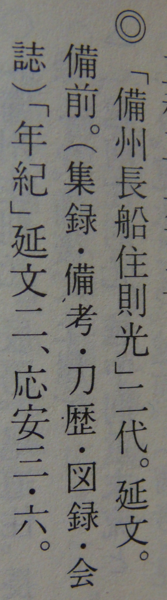

David McDonald Posted June 14, 2011 Report Posted June 14, 2011 Dear Jean When you said that ju was not associated with Bishu Osafune my first thought was that this can not be right. I was sure that there were many Bishu Osafune ju. I have a Norimitsu mine is signed Bizen Kuni ju Norimitsu. So go out Hawley’s -- you were right no Bishu Osafune ju but I did not give up so went to Toko Taikan – you were right no Bishu Osafune ju but I did not give up so when to Nihonto Meikan -- ha! there is a Bishu Osafune ju Norimitsu listed On page 751 the second listing with a date of 1356 (embun or yembun period) The listing has a double circle so must be a good smith. The sword at hand does not seem that old so later generation? Unrecorded signature style? Always fun getting out the books and doing some reading. Later david In early/Middle Murmachi the classical mei was: "Bishu Osafune Norimitsu", with often a Nengo (date) on the other side. In sue Muromachi : There were short mei without date, mostly kazu uchi mono. Generally "Bishu Osafune + smith name". What is very strange is the association of "ju" with "Bishu Osafune", unseen with this smith. Generally "ju" is associated with "Bizen Kuni" Later generation, unrecorded, why not but ..... Quote

David McDonald Posted June 17, 2011 Report Posted June 17, 2011 Dear All Look what happens when you have to work and can not read the Message Board!!!! Jacques – I agree most likely gimei but might still be just an unrecorded smith (but not likely unrecorded) Jason – I hope there is an attached image of the listing. In the listing there are notes of books but sorry my Japanese is not that good to translate. Here is what I can read. Bishu Osafune ju Norimitsu 2nd generation Engen (Yengen) period 1336 Bizen Then I think name of books Last dated swords I believe. Engen 2nd year Ooan 3rd year and 6th year Sorry not ju nin just the ju Jean – bashing heads???? When I read the posts about Norimitsu I got out my KATANA and looked at the mei. When you said that Ju was not associated --- “unseen with this smith” I recalled that I had seen Bishu Osafune ju Norimitsu when I was researching my katana. But as I listed in my email this was not an easy task as you were correct that almost all followed your note. But there is one. Wakizashi/Katana whats a few ‘sun’ among friends. Keith – Jōdan no kamae….. shomen Does a cut to the head beat a small touche'? Back to tsukamaki – I am working on a string style wrap where there are two strands and at the cross over the inside strans are hineri maki and the outside strands are rolled. Looks nice but took a while to figure out. Later david Quote
Jean Posted June 17, 2011 Report Posted June 17, 2011 David, When I read the posts about Norimitsu I got out myKATANA and looked at the mei. When you said that Ju was not associated --- Once again, you are extracting a sentence out of a context. You are cutting the interesting part which is the time/era which is "Muromachi" I split my post between early and Middle Muromachi and on sue Muromachi and added general comments. You are mentionning a mei in Nambokucho which is irrelevant with my post, no smith recorded with "Bishu Osafune junin..." in Muromachi In Bizen school, the era is fundamental as it enables you to detect Gimei from the Syntax Quote

Jacques Posted June 17, 2011 Report Posted June 17, 2011 Hi, David, Toko taikan latest edition : Quote
