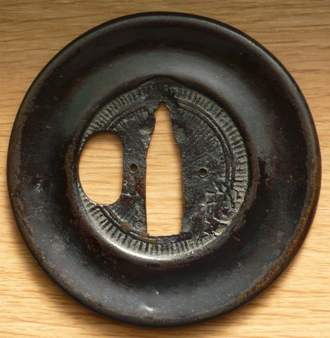

Lorenzo Posted June 13, 2011 Report Posted June 13, 2011 Thank you Bernard to let me use your tsuba pictures to ask this question. What is the exact and known purpose of the two holes drilled on this seppadai? It's not the first time I've seen it, Henry's ko-kagamishi papered tsuba has the same, but unplugged. Any idea? Thank you in advance. Lorenzo Quote

Henry Wilson Posted June 13, 2011 Report Posted June 13, 2011 For reference here is the Kagamishi tsuba with holes that Lorenzo mentions. I think they were drilled to hold seppa to the tsuba but that is just my opinion. BTW this tsuba will be in the 2011 KTK catlog which will be available from October this year :D Quote

IanB Posted June 13, 2011 Report Posted June 13, 2011 Lorenzo, Further to Ford's comment, at the weekend I saw a Miochin tsuba made like a helmet bowl from about 16 - 20 separate radial plates held together by three or four rivets on each plate. What struck me as odd was that each plate was slightly domed, which for helmets, was a Saotome construction rather than Miochin one. Around the edge you could see the gap between the domed plate and the flattened part of the plate below. The seppa dai was a separate flat plate on each side, held by about 6 rivets through the whole stack. Obviously in this case there was no alternative but to add the seppa dai as separate pieces. Note the burr around the holes in Henry's tsuba - that I think clearly shows the holes were done for some purpose other than for use on a sword. However on Bernard's tsuba the plugs in the holes have been made from the same or very similar alloy to the tsuba itself and patinated to match. That suggests it was done in Japan, at the very least, and by someone who knew about tsuba. Ian B Quote

Thierry BERNARD Posted June 14, 2011 Report Posted June 14, 2011 Brian said: Pssst.....I believe that is Thierry Bernard. Mr Bernard....or Thierry. At least I hope I have this right. With the Japanese way of naming, now I have no idea. Simply Thierry IanB said: Profuse apologies. don't worry even french people sometime make this mistake Lorenzo said: Ok. so. To proceed with the discussion, we should now know if Thierry tsuba is sanmai or not here is the answer ! Quote
Lorenzo Posted June 14, 2011 Author Report Posted June 14, 2011 Thank you Thierry. Remains the example where the tsuba is not sanmai; if nobody else have anything (nothing? Now I am scared to make mistakes) to add then should we consider the holes a westerner addition that has nothing to do with nihonto? Best, Lorenzo Quote
Curran Posted June 15, 2011 Report Posted June 15, 2011 Lorenzo, Eh..... It IS 3 piece construction. No???? _____________________________________ Your English is fine. Italian has too many VERB tenses. Italian Subjunctive is worse than Spanish Subjunctive. Quote
Lorenzo Posted June 15, 2011 Author Report Posted June 15, 2011 Curran, you are not understanding me. I KNOW about the sanmai and I see this one is, BUT there are examples with holes where sanmai is not the reason, and that is what I am asking about from the beginning Quote
Henry Wilson Posted June 15, 2011 Report Posted June 15, 2011 As for a lot of things if in doubt I tend towards Occam's Razor, that being the simplest theory. If the holes are not for sanmai construction, what else could they be for? Light switch plates, Victorian tables are all possibilities but ... Concerning my Kagamishi tsuba, the two holes are not drilled in line which to me suggest that they were done by someone not especially skilled and / or they were drilled with the intention of not being seen. Considering the position on the tsuba, ie. the seppadai were the seppa are placed, I still believe that the holes were used to hold seppa in place. As noted, the metal removed from the holes is slightly polished suggesting they were covered by a seppa. The tsuba is very thin especially around the nakago ana so for the tsuba to fit to a narrower sword there is not much metal present to able someone to use a chisel and make the hole narrower. It is possible that a seppa was fitted to the seppadai using the holes and rivets to compensate for the condition of the nakago ana. This to me is quite simple and applying Occam's Razor is the theory I find easiest to accept. That is all for now. I am off to Sensoji. http://www.google.co.uk/imgres?imgurl=h ... 92&bih=886 Quote
