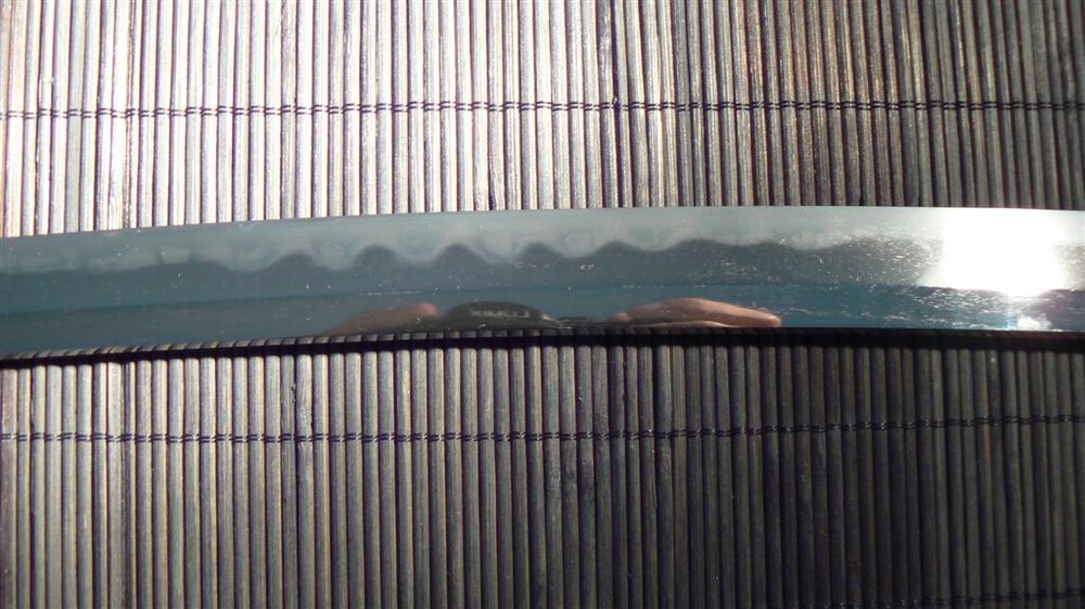

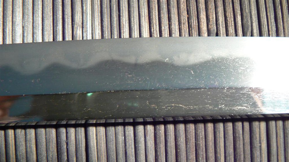

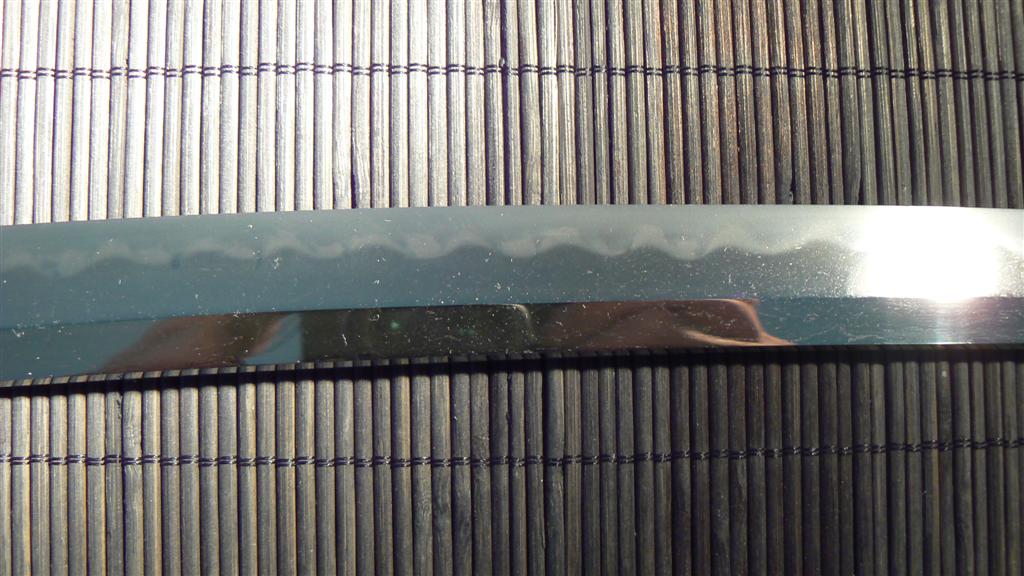

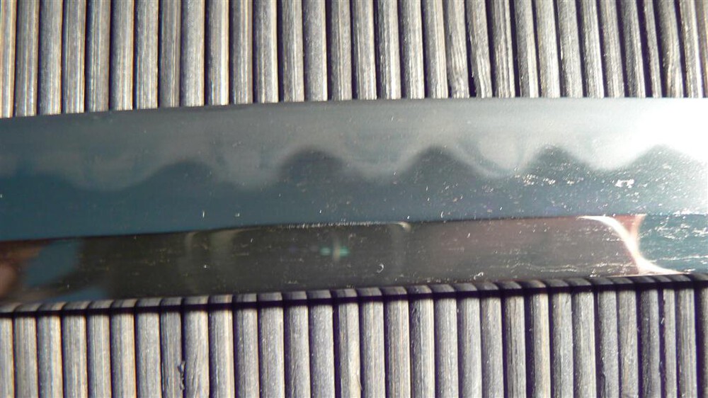

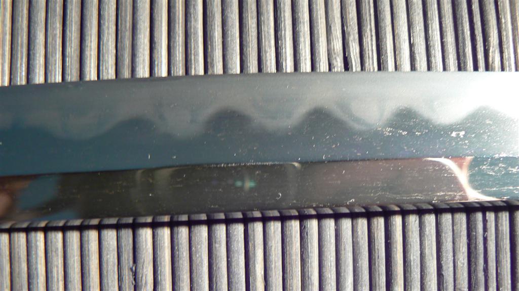

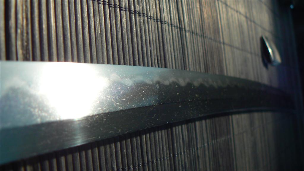

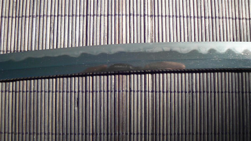

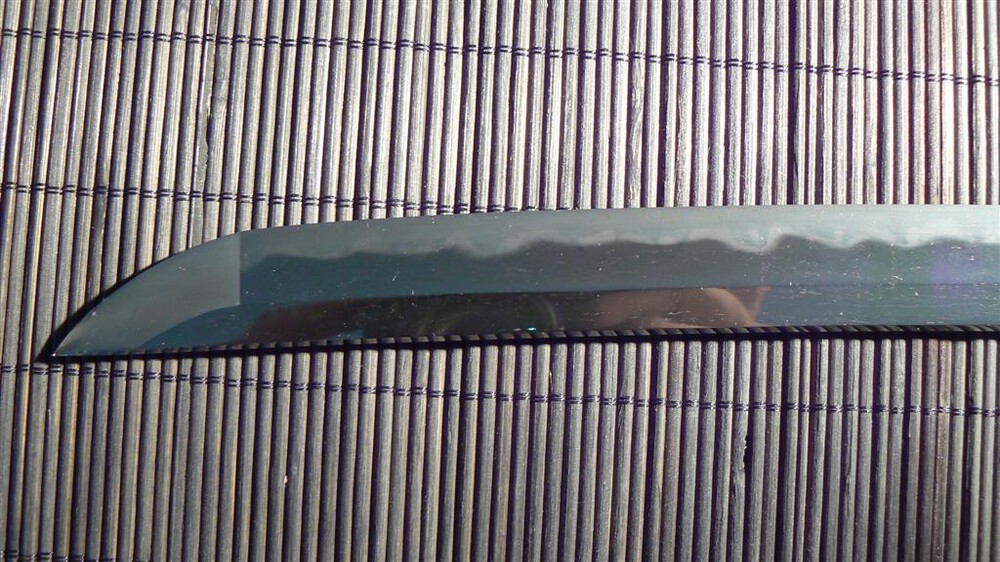

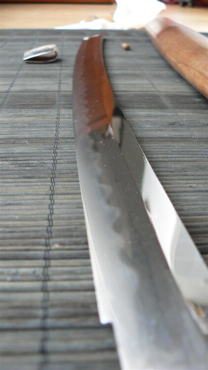

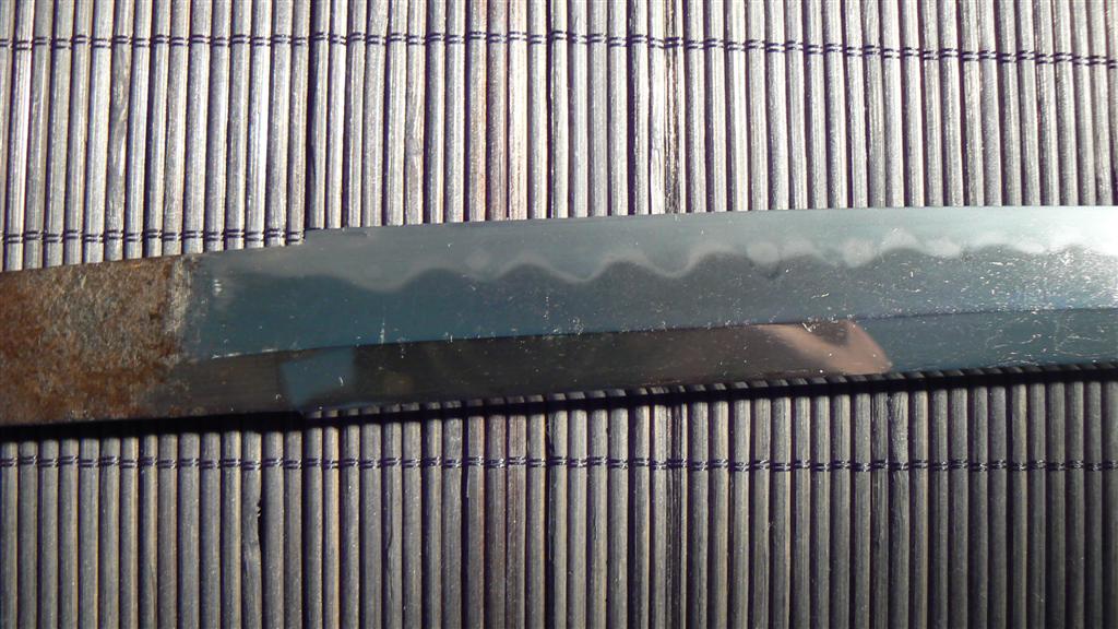

I bought this unsigned wakizashi 2 years ago but the seller gave no information about the sword. I'd like to know a little more about it (possible age, school...).
May I ask you some comments about it ?
Many thanks :bowdown:
Thank you :bowdown:
Just one more question: Are these crab claws also featured in other sword schools or is it a very distinctive feature of this school ?
Hello,
I also think for bizen, but I would rather think to shinto Sukesada school.
May I am wrong, but shinogi ji seems to be in massame.
crab-claw is a specificity of bizen den.
Thanks for your comment.

Francois,
I dont think Franco was commenting on your purchasing the blade. He was simply saying he had a different opinion about the origin of the sword than those already stated. i.e. he was suggesting it was Bungo Takada and not Bizen. BTW I also think he may be right!
best regards
Paul
OK, I'm completely off the mark then :glee: (I feel really stupid :lol:)
Anyway yesterday, I had a look to nagayama's book and Sukesada seemed to match pretty well. I'll check your suggestion.
:thanks:

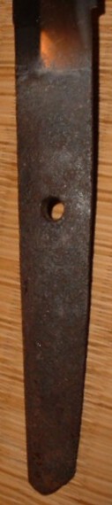

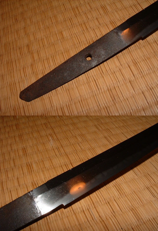

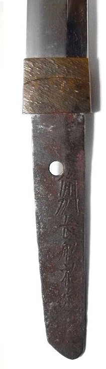

This nakago still doesn't look bizen it is too tapered. Has a normal shape.
I wonder myself how man can attribute a name on a blade without measurements, without seeing correctly hada, hamon, nioiguchi, etc.... :roll:
I made no attribution, simply indicated a possible avenue for exploration. Yes, the nakago is not a classic Bizen shape. Neither is the one I posted as an example. Have you ever seen a reshaped nakago? Have you ever seen atypical work by a smith or school?
Dismissing a possibility without seeing details, measurements, without seeing correctly hada, hamon, nioiguchi, etc., is tantamount to making at attribution. Please tell us how you do it and we will all have an answer to your question....

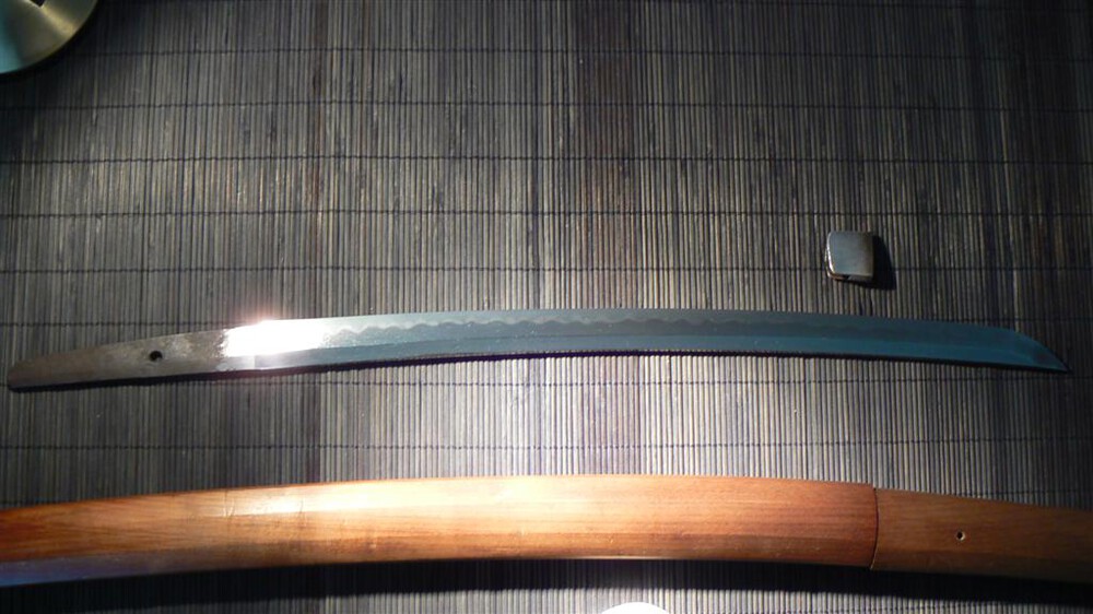

Sorry for taking so long to provide measures, it took me some time to find back my caliper.
Here are the features of the sword:
Nagasa: 42,8 cm
Nakago length: 13,8 cm
Motohaba: 2,5 cm
Sakihaba: 1,9 cm
Motokasane: 0,61 cm
Sakikasane: 0,5 cm
Sori: 0,7 cm
Hope this can help in narrowing down to fewer schools

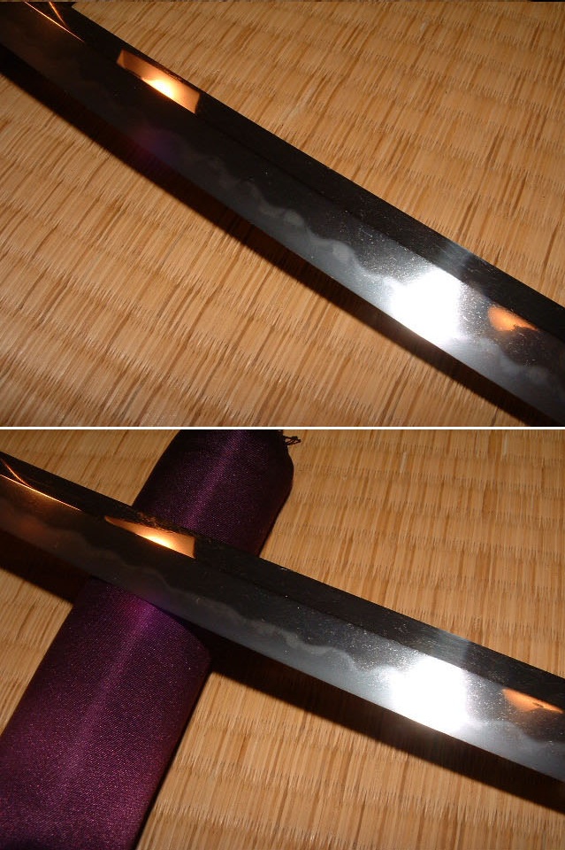

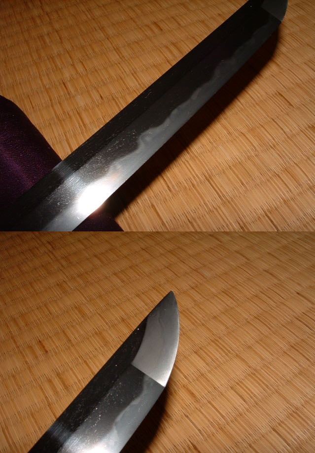

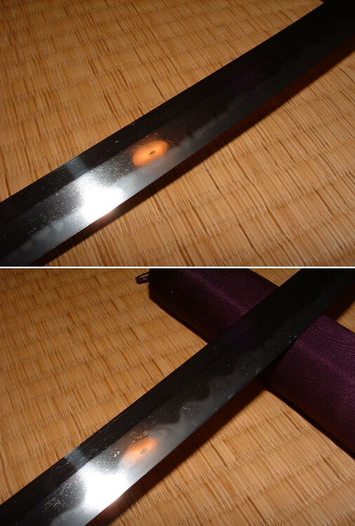

Attached are 2 pictures of a wakizashi signed Sukesada, similar shape as the one originally posted as well as the example Chris posted. I've had it for around 15 years, has a typical Mount Fuji/Crab claw hamon, although the pattern is much more regular and less free flowing than earlier examples as Koto turned to Shinto. I believe my sword was made by one of the many Shinto Sukesada, and is probably nothing special except to me (first sword and given to me by my father)
While most of the swords I saw signed or attributed to Sukesada over the years do have the typical Bizen nakago, I've come across quite a few with the other shape, but what's unusual is they most always seem to be wakizashi. Hope this is useful.

When we speak from experience, rather than rely on what we read in books, we learn there are plenty of exceptions.
You have also made another key observation: Koto Sukesada, in general, tends to have a more organic, less orderly hamon than Shinto. Another difference is the hada....
Regards,
Lance
Thanks for your post, I only saw it today. This confirms that one can never really know for sure what he has in hands, there'll always be a doubt. That's maybe the most frustrating part of nihonto for me, I'm a computer scientist, I like determistic things :)
Anyways, thanks for sharing. I may have one of the exceptions that confirm the general rule.

Funny discussion, :D i still wonder myself how man can attribute a mumei blade to a smith based on poor pictures and a speculation on a detail when the whole shape (specially the nakago) doesn't match the school; going straight on the reshaped nakago's version seems to me irrational. I recall a blade we had once to kantei. all the people present had given that blade Bizen, when the tsuka was removed, the sword turned to be Soshu and signed Fusamune.
Experience never protects anybody being wrong, it only reduces the probabilities, that depends of the "talent" too; its like musicians or painters, some are bad all along their life, some become good artists and few become masters.
