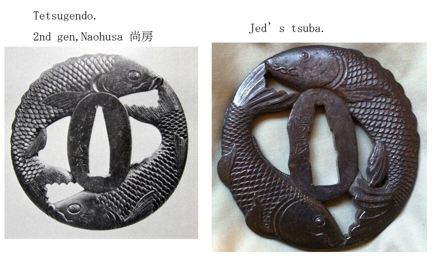

These photos were attached in a post in another section relating to my katana, and it was suggested I post them here instead. My question was whether the tsuba is in fact authentic, or is a replica of some sort - I neglected to ask the seller when I purchased the sword 13 years ago. Thank you in advance for your thoughts!

The first and last pictures are included to show the outer edge and an interior section - I don't see any seams.
Hi Jed,
The more I see of your sword the more I think the whole thing, blade and mounts, is a reproduction/fake. The notches in the nakago hitsu ana of your tsuba are unusual, and the thinned down top fin of the fish forming the outside rim of the tsuba seems unlikely (it would be too easily broken in use). The seppa (washer) with gear teeth is very unusual. The fuchi looks to be cast; not so with real Nihonto.

This is a weird one.
I lean towards believing it is a sword, but that the whole ensemble is sort of an amateurish construct by someone who kinda knew what they were doing.
The tsuba design pops up in late edo and thereafter. I've seen some cast, but others just kinda crudely done, and one or two that were done my true artisans.
The jigane looks legit, but the ha and hamon is off. Notice all the overly apparent masame running below the hamon along the length of the cutting edge. Ever seen that before?
The tsuka wrap shows the tell tales of an amateur (non-Japanese wrap). Very few veterans can do them right outside of Japan.
Habaki is a bit crude, but not like a chinese made collar.

Interesting comments. I should probably have clarified (although it didn't occur to me to do so) that I am certain that the sword fittings were put together by the seller (as in, the individual who sold it to me...). I recall him noting that he had acquired the blade at a show/convention of some sort and then paired it with the furniture. As noted, I did not ask if the fittings were authentic or not.

Hi,
The one looked like this tsuba(Jed's tsuba) on a book.
Tetsugendo, the 2nd gen,Naofusa.
The difference of the capability is understood well,and Naofusa's carp is more real.
