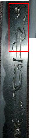

Marius Posted May 17, 2011 Report Posted May 17, 2011 spektrat said: In what way is it strange? Poorly made or poor as in not detailed enough? It is poor (as far as I can see from your pics, and what the heck is that sprawling vine that should in fact be a stylized dragon? The horimono is bad IMHO, ato-bori, possibly to hide some flaws. Here is a pic with the most offending detail. I cannot criticize the rest, as your pics are low-res. But the whole horimono seems crap (forgive me my bluntness, I might be wrong - in such a case shame on me)
Stephen Posted May 17, 2011 Report Posted May 17, 2011 mariuszk that just your lack of experience showing. many Hori are like that type of dragon edit to add ...yes shame on you for calling something crap when you dont know what your talking about.

Marius Posted May 17, 2011 Report Posted May 17, 2011 Stephen said: yes shame on you for calling something crap when you dont know what your talking about. shame on me, then I'll use a sword without a horimono for my seppuku, just in case it might be an ato-bori Still, allow me to think it is a bad horimono. Good pics (high resolution) will prove if I am right or wrong (I am not sure, of course). BTW, I think a more courteous reprimand would not harm anybody. I may not know what I am talking about, but you could have put this in a more agreable tone, sparing me the embarrassment that comes with such a merciless exposure of my blatant lack of knowledge. This could have been done without blunting the edge of your criticism - I think in such a case it would be called politeness. On the other hand, I must admit I have transgressed the rues of civility using the word "crap". For this, please everybody accept my apologies. I have deserved your remark. Thank you for that I will use more caution in the future. 1

Jacques Posted May 17, 2011 Report Posted May 17, 2011 Hi, I agree with Mariuszk, this horimono is poorly done and resembles in no way those of Heianjo Nagayoshi. A nice example of So no Kurikara (Heianjo Nagayoshi at the bottom of this page : http://www.japansword.co.jp/announce2.htm
