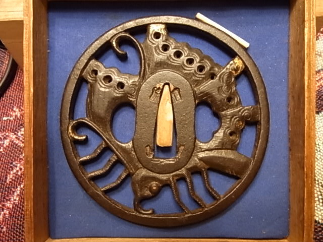

I am now, Keith. Thanks. I was thinking more of the Satsuma troops who believed in the Men stroke with a katana. This Tsuba was on sale at the Old Edo market for 70,000 yen. We haggled for a bit... :)

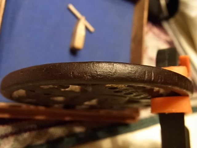

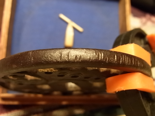

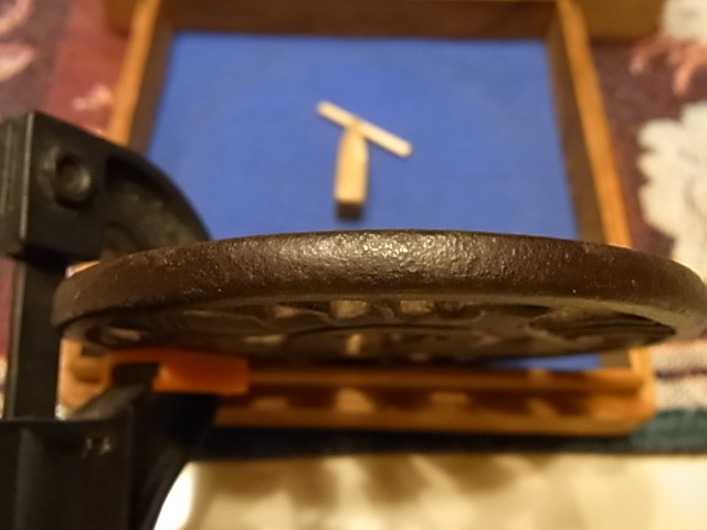

Here are some shots of:
a) the iron shoami tsuba; the edge in question marked with stick
b), c), d) the same area of mimi from different angles
e) an unmarked length of mimi for comparison.
These are not cut marks........ At least not IMHO. Too blunt. A blade leaves a narrow 'V' mark, at the depth shown, half as wide as these at the open end, more acute at the base, and is very clearly defined, even in an old tsuba.
I like the Seki Kamon motif though. :D Then again I would of course, its my avatar.

I should have mentioned that the nick shots were taken from 1~2 cm away.
They look too deep for someone casually placing the sword even on a concrete floor. The opposite rim bears no evidence of counter bracing. So I will assume that someone either used this tsuba for whacking the edge of something hard enough to dent steel, (ignorance, iconoclasm?) or they hit it with a Mozo-to or sharp-edged iron implement as an experiment in ... what?
I keep my initial position; the cut marks as a result of a fight is too unlikely. The perfect parallelism between them is a further proof.
I came to think about ara-tameshi instead. I won't discuss on the purpose of that, but the tsuba might have been inserted in a wood slot to keep it steady and then struck with some sort of blade or many blades, to test the swords or to test the tsuba :dunno: (sort of bullet tested armours)... however I fear that a full force ara-tameshi could break the tsuba mimi instead of living that shallow mark :|
