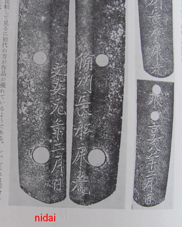

Grey Doffin Posted May 13, 2011 Report Posted May 13, 2011 Hi Martin, 2 pictures from Fujishiro Koto-hen. Grey Quote
Jean Posted May 13, 2011 Report Posted May 13, 2011 Martin, Your kanji Yasu has a top horizontal stroke which finishes like a arrow head. Never seen this on other Yasu (mitsu) kanji.... Your mitsu kanji have the 3 top atari misplaced, on the right of the below right leg. It should be right in the middle of the below horizontal stroke Quote
