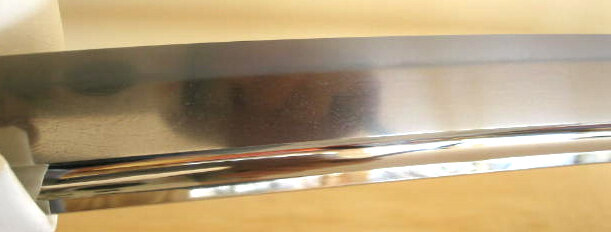

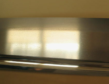

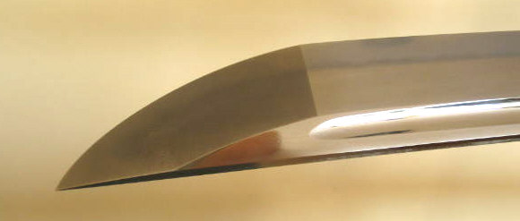

Grey Doffin Posted May 4, 2011 Report Posted May 4, 2011 Hi Jim, The paper has this to say about the hada (as translated by Harry Watson): "A mixture of mokume and nagare masame in itame, overall it is hadatachi, with ji-nie, chikei is inserted, jifu is mixed in, and there is a hint of faint shirake." "Hamon: A mixture of k0-gunome in chu-suguba, there is hotsure, yubashiri, and nijuba in the habuchi, there is fine ashi and yo, with thick nie, there are kinsuji and sunagashi, and the nioi-guchi is bright and serene." "Boshi: Shallow notarekomi, saki is ko-maru, and the nie is strong, and there is nijuba and hakkake." And here are 3 pictures; hope they help. Grey Quote
Jim P Posted May 4, 2011 Author Report Posted May 4, 2011 Thanks so much Grey,No run of the mill Ko-mihara, I thought it must have some interesting traits and it does. is hadatachi seen much Ko-mihara ? my understanding is its hada that has a easy to see texture ? thank you Quote
