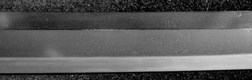

Jim P Posted May 1, 2011 Report Posted May 1, 2011 Hi all, I am looking at this ko-mihara (https://www.aoi-art.com/sword/sale/10480.html ) but am a bit perplexed why the blade if re polished may be judged to Aoe school.and also the blade might be Enju school so we have 3 possible attributions ? what would change it from ko-mihara as the polish is OK. Our ko-mihara is like this one if it was re polished is it possible the attribution would also change ?just trying to understand the attribution and why the maybe,s ?thanks Quote

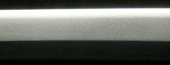

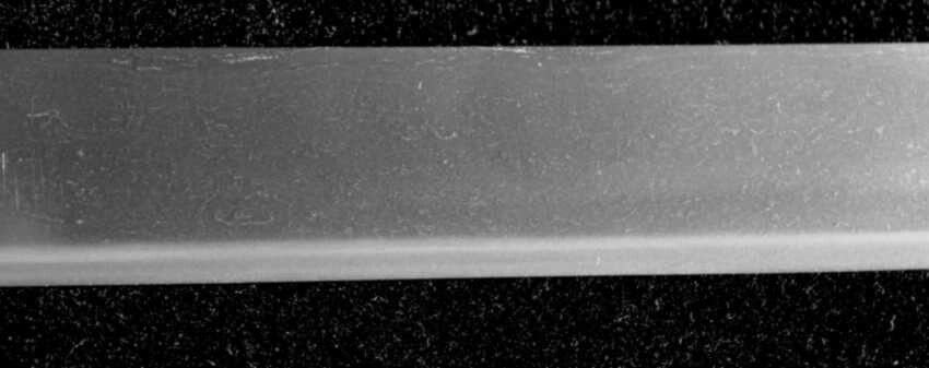

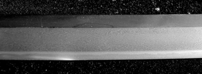

paulb Posted May 1, 2011 Report Posted May 1, 2011 Attached some first attempts to show differences between specific examples of Aoe, Enju and Mihara. The first is a Chu-Aoe blade, the second ko-Enju, the third is actually pared to sue-mihara but I think the hada is much more in line with chu or even ko-mihara, it lacks the whiteness and hard look associated with sue-mihara. Unfortunately by the time I get them to an acceptable size to show I lose a lot of detail (my excuse anyway) If you want better images drop me a pm with your email address and I will forward them on. Quote

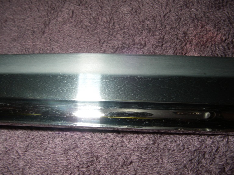

Jim P Posted May 1, 2011 Author Report Posted May 1, 2011 Hi paul, Thanks for the info, yes its hard to tell from the pics so I will take you up on the offer of better pics. Will PM you, This is a pic of the Ko-mihara hada on our blade what you would expect also can you elaborate on the Yamashiro influence appearing early in the schools work. Quote
cabowen Posted May 1, 2011 Report Posted May 1, 2011 The second picture resembles chirimen hada of the aoe group. The chikei are thick within the mokume and almost look like worms..... Quote
paulb Posted May 1, 2011 Report Posted May 1, 2011 Hi Jean It is very interesting to see the vairiability within a schools work. I know we have comapred notes before but if you look at your example against mine they are very different. I think it is an important point to remember that even within a well defined school there can be significant differences in appearance. I have attached another image of the Enju wakazashi mentioned above for comaprison to your own Quote
cabowen Posted May 1, 2011 Report Posted May 1, 2011 paulb said: Hi JeanIt is very interesting to see the vairiability within a schools work. ...I think it is an important point to remember that even within a well defined school there can be significant differences in appearance. Especially across time periods... Quote

Jim P Posted May 2, 2011 Author Report Posted May 2, 2011 Hi Chris, Its interesting that you see a resemblance to chirimen hada as in this sword the description was Ko-itame worked very well, and covered in much Jinie. I am starting to understand that descriptions are subjective to the one making them and picking up on fine minute detail is hard, and is from hard won experience which you have. Paul was just saying that It is very difficult to tell good Enju and ko-Mihara work from Rai pieces, it comes down to some finer minute details. I think you have to see them all side by side if its from photos to get some idea ? maybe we can do that one day with a good view of them for those who don't get the chance to hold them. Paul I think you are right about not much written about either as most of the books in English have much the same info on Ko-mihara and maybe the lack of recognition is starting to change I have liked sho-shin thoughts on them, (Ko-Mihara are excellent swords - exhibiting true master-piece quality. Hense Ko-Mihara have always been hearlded and revered works. Ko-Mihara are considered world-class, especially because of their conservative nature.) from sho-shin (http://www.sho-shin.com/sanyo13.htm) but maybe they don't appeal to some as they are conservative but Its good to see that is changing thanks Quote

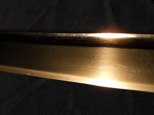

John A Stuart Posted May 3, 2011 Report Posted May 3, 2011 Here is a shot of my Mihara tachi, a very fine itame. John Quote

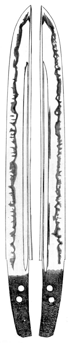

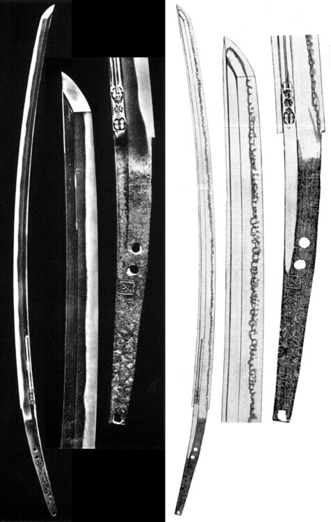

Grey Doffin Posted May 3, 2011 Report Posted May 3, 2011 If it will help, an oshigata of a very good Ko-Mihara. Grey ftp://ftp.cpinternet.com/homepage/124_2409.JPG Quote
John A Stuart Posted May 3, 2011 Report Posted May 3, 2011 Grey, that link keeps asking me to log on with passwords etc. John Quote
Grey Doffin Posted May 3, 2011 Report Posted May 3, 2011 Yep; I was afraid of that. The picture I have is too big for posting and I haven't had any luck resizing or linking to it. If any of you would like to see the picture, email me with the link below and I'll send it to you. Grey Quote
Brian Posted May 3, 2011 Report Posted May 3, 2011 Grey, Instead of trying to get us to hack into your account via ftp...maybe you should just link the picture instead. :lol: http://www.cpinternet.com/~gdoffin/124_2409.JPG Brian Quote
Grey Doffin Posted May 3, 2011 Report Posted May 3, 2011 Thanks Brian; that's exactly what I was trying to do. Glad I know more about swords than I do about computers. Grey Quote
Grey Doffin Posted May 3, 2011 Report Posted May 3, 2011 And, I should add, when I bought this sword it was signed Kunimura (Enju) and had saya-gaki to Bitchu Aoe. Grey Quote
Jim P Posted May 4, 2011 Author Report Posted May 4, 2011 Hi Grey thanks for the oshigata Grey what is the hada like ,and do you have a photo ? also if some of the other members have oshigata or pics of Ko-mihara or Chu-Aoe blades I would love to see them thanks Quote
