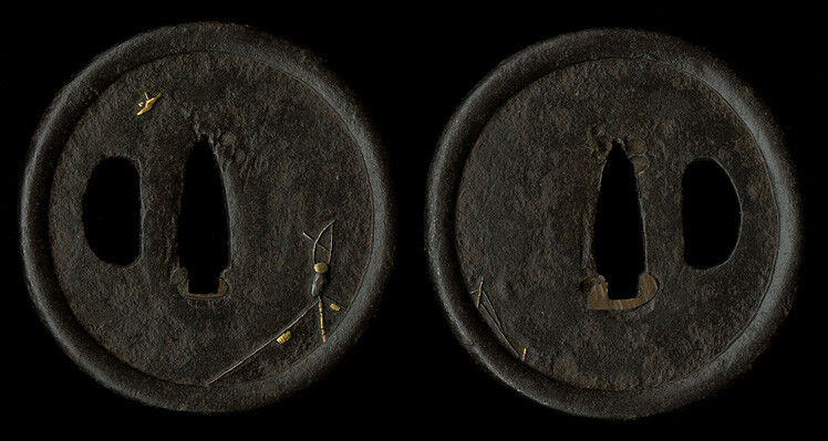

Marius Posted April 27, 2011 Report Posted April 27, 2011 Nice, deep patina and well executed mimi. Inlays in silver, gold and shakudo, representing a hunter shooting a bird. Small, granular tekkotsu on the rim. Could be Edo, maybe earlier with later added inlay. 6.8 x 6.5 cm. Thickness 2.5 mm at seppa-dai, 4 mm at rim. Quote
sanjuro Posted April 27, 2011 Report Posted April 27, 2011 Marius. Not trying to be a royal pain in the butt, but can you post closeups of the inlay please? I have not come across this type of stylisation before and it intrigues me. I rather like this tsuba. My gut feeling is that the plate is earlier than Edo. Quote
Marius Posted April 27, 2011 Author Report Posted April 27, 2011 Not trying to be a royal pain in the butt, but can you post closeups of the inlay please? I have not come across this type of stylisation before and it intrigues me. I rather like this tsuba. My gut feeling is that the plate is earlier than Edo. Keith, you are not :-) I was thinking earlier than Edo, too, but the inlay looks Edo, at least IMHO. I will try to do macro pics, but not earlier than next week, as I am away now. Quote
IanB Posted April 27, 2011 Report Posted April 27, 2011 Mariusz, The Deryk Ingham sword collection in the Royal Armouries' collection has a fuchi with exactly this image - a scarecrow with a bow and a rope with a bird rattle on it. The fuchi, is of shakudo nanako with gold and alloy inlays and is on a wakizashi with a horn kashira, the artist has lacquered the bird on the kashira. Ian Bottomley Quote
Marius Posted April 27, 2011 Author Report Posted April 27, 2011 Ian, I would say this is a fisherman, dressed in a straw rain coat. But the scarecrow version is very appealing. This would be a sophisticated scarecrow, mimicking an archer. Perhaps to scare off cormorants? Quote

IanB Posted April 27, 2011 Report Posted April 27, 2011 Mariusz, If you look carefully you will see the 'figure' is actually mounted on a pole. It is much more clear on the fuchi because it is larger in size and has more detail. On this you can see it is made using a straw raincoat and a farmer's hat. Also the bird rattle on the fuchi can be seen to be made of lengths of bamboo. You can see these are marked on your tsuba. A very nice tsuba and somebody has got a good deal. Ian Quote
Marius Posted April 27, 2011 Author Report Posted April 27, 2011 If you look carefully you will see the 'figure' is actually mounted on a pole. It is much more clear on the fuchi because it is larger in size and has more detail. On this you can see it is made using a straw raincoat and a farmer's hat. Also the bird rattle on the fuchi can be seen to be made of lengths of bamboo. You can see these are marked on your tsuba. A very nice tsuba and somebody has got a good deal. Ian, I thought this was a synthetic representation of a hunter, hence no arms, legs and details. But surely, you are right, thanks for the info The person who has got the deal is a real gentleman whom I like and respect. I am glad it was him who got it :-) Since I will not be able to ship before Wednesday, I may take some close-ups and post them here. Brian, maybe you would like to move this thread to the "Tosogu" section? Quote

IanB Posted April 28, 2011 Report Posted April 28, 2011 By chance I stumbled upon this painting which I think settles the matter. Ian Bottomley Quote
Marius Posted April 28, 2011 Author Report Posted April 28, 2011 Ian, lovely print, thanks There is no doubt now that you were right from the outset. Thanks a bunch for clarifying this. Pics will follow next week (macros). Quote
