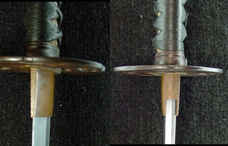

Just a little observation on the nakago. If you look at the pics from the link you can see on the ha surface where the tsuba rests the metal is shiny and worn. I am suspecting that this has been in use for cutting and that there might be some play in the fit of the tsuba as if this had not been used for at least 150 years that shouldn't be there -- it should be the same rust as the rest of the nakago. Perhaps it would also explain the condition of the polish as cutting targets quickly leads to scratches. Just doing some Sherlock Holmes work here but it would make sense.

There is something slightly odd about those bright spots on the nakago and the "scratches" on the blade look more like the foundation stages of a polish rather than sandpapering. The tamishigiri practicioners I know in Japan go back to the togishi for a basic touch-up polish every 6 months or so and the results, whilst better than this sword, are still no art-polish.

The nakago is signed "kunisada". I have no idea why it has been referred to as mumei. Even if the both of you are correct about the shiny spots on the nakago, it wont be hard to make the tsuba fit tight again. I also know of many tameshigiri practitioners in Japan who buy shinsakuto that are a dull greyish sort of colour, and no real hamon. Only put through the first stage of the polish such as you described. That is another reason why i wanted to purchase this blade, because i wont be damaging an art polish. The length of this blade also attacted me to it.

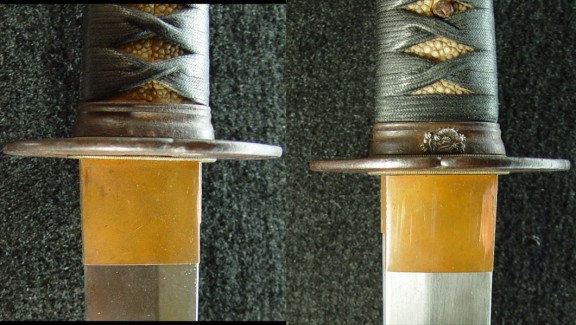

Thank you once again for participating in this discussion. I have attached another photo of the habaki. If you look carefully, you can see that the blade near the habaki is also a dull greyish colour as though its seen only the first stage of the polishing process. The hamon isnt all that visible unless you look really closely. BTW, I am just over 6 foot tall, that is why i needed a monster of a blade! :D

Heres your pix, i cut it in half and reduced the size, did you take the photos? If so well done, nice lighting on the top set, i think to help with the kante of this if you were to remove the fittings and show the area under the habaki where the rust on the nakago turns to polish would help us alot.
