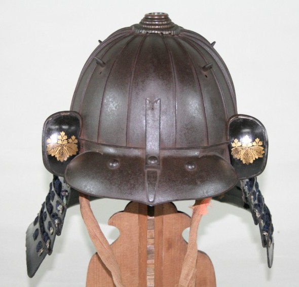

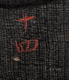

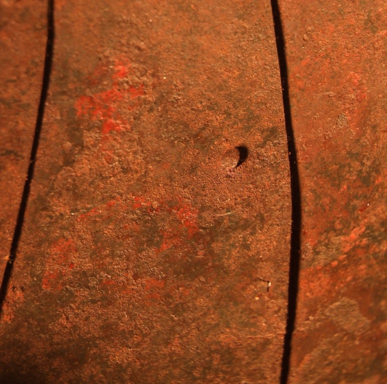

I kindly ask you for assistance on reading the inscription on my 16 ken suji Kabuto (second picture) and Dou (last picture). They are look quite the same for non trening eye.
Writing on kabuto is very hard to see and it is done with red colour.
Thank you for helping.
Bojan S.
Hi Bojan,
The Dou is ju yon (10 and 4) = 14
The red lacquer on the kabuto looks the same...I have seen numbers like this on kabuto etc before...maybe it is an inventory number (storekeeper's number)?
Regards,
George.
Bojan, You also get similar numbers on all the parts of one armour, so that the pieces don't get mixed up. In this case I am surprised because the helmet looks a high quality item and unlikely to be in an arsenal.
Ian Bottomley

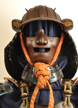

Hello,
thank you for your comments!

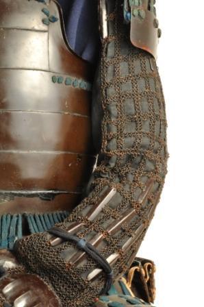

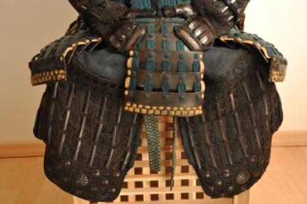

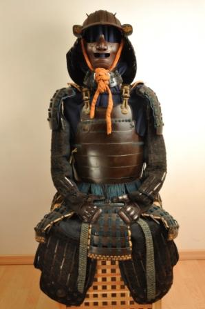

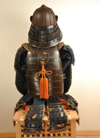

Yes, 16 Ken Suji Kabuto is heawy and wery beautiful. I would be interested to get some more information about it. Here, are some pix. of my whole Yoroi.
Regards,
Bojan S.
