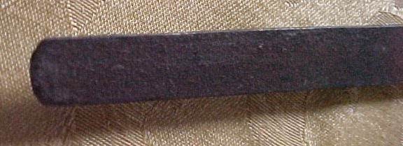

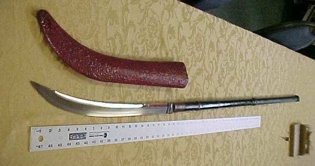

Cello Posted April 15, 2011 Report Posted April 15, 2011 Hi, I know very little if anything about the value of naginata and their mounts?Can anyone give me an Idea Of what would be a good price for this or one or a similar one??Not sure how to date these as well it's unsigned and seller thinks it's from the 1400's.It has one or two ware I could see in the pics. thanks Quote
Mark Posted April 15, 2011 Report Posted April 15, 2011 size and shape suggest Shinto. If an average Shinto naginata by no one special with ware' and mediocre mounts probably $1400-1800............ my opinion based on pictures and description Quote
Cello Posted April 15, 2011 Author Report Posted April 15, 2011 Thanks Mark....Also Do you know if naginata are not as popular for collecting because of their being less available,or because the are not generally forged to the same standards as other nihonto? Quote
estcrh Posted April 15, 2011 Report Posted April 15, 2011 Thanks Mark....Also Do you know if naginata are not as popular for collecting because of their being less available,or because the are not generally forged to the same standards as other nihonto?Very few naginata are for sale at any one time compared to swords. Most do not have an original shaft and many are not even in shirasaya. The ones I have seen for sale that were reasonably priced get sold. I have a couple, I think they look great in a collection along with yari. Being able to actually hold one of these weapons is an experience that few people ever get to do. Quote
Cello Posted April 15, 2011 Author Report Posted April 15, 2011 I'm really considering buying this one but I'm not sure what to offer?? He's looking for 2500.00I would like to get it for less...He also has a forged rope cutter arrow tip and quiver with signed arrow.I have no idea what the arrow tip and rest are worth either! Quote
Mark Posted April 15, 2011 Report Posted April 15, 2011 if you are buying it to keep it then the market value does not matter that much, pay what you are happy to, i have bought plenty of swords for more than they might have brought on the market because i wanted them, it came down to what was willing to pay to own them Quote
estcrh Posted April 15, 2011 Report Posted April 15, 2011 I'm really considering buying this one but I'm not sure what to offer?? He's looking for 2500.00I would like to get it for less...He also has a forged rope cutter arrow tip and quiver with signed arrow.I have no idea what the arrow tip and rest are worth either!In that case can you provide more pictures or either item, plenty of people here who can give you a thumbs up or down but not without some more pictures. I am sure if anyone knows of a better deal they will let you know also. Quote
Jean Posted April 15, 2011 Report Posted April 15, 2011 Yanone: http://www.aoi-art.com/yanone/main.html Naginata : Not more than 1500$. Seems to have been shortened referring to the Naginata hi ending at nakago level. Seems equally post Koto. Quote
sanjuro Posted April 15, 2011 Report Posted April 15, 2011 This specimen is almost certainly machi okuri, since the short hi ends beneath the habaki rather than before it. I strongly suspect later than koto also, despite the sellers claim of 15th century. (Wrong shape). Whereas a good Sengoku Jidai naginata will fetch prices commensurate with swords of the same period and condition, this one, almost certainly a shinto example, based only on what can be seen in the photographs posted, would be worth around the $1500 to $2000 US mark at most. Better pictures would reveal much more and make estimates easier to justify. At the end of the day one must ask "Do I like/want this piece and what am I prepared to pay to obtain it, regardless of the price being asked?" Quote
Cello Posted April 15, 2011 Author Report Posted April 15, 2011 Erick,Jean and Keith Thanks for the great info....I guess the board has saved me some money once again!I'll check out the link you posted Jean for some comparison..I'll post some addt'l pictures later, but probably a mute issue since it seemes it's nothing special and I don't think the seller is going to drop the price to what is suggested.But I'll post more pictures so I can learn from you guys. Quote

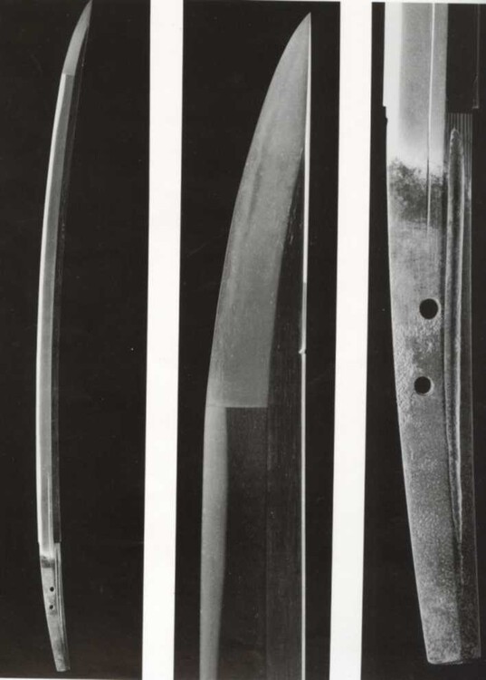

paulb Posted April 15, 2011 Report Posted April 15, 2011 Hi Keith, Sorry I think I may have been less than clear. The Unji is in the Armouries, the other two are from a private collection. The Unji was originally part of the A.Z. Freeman collection and formed part of the group dontated to the Armouries by the family of Deryk Ingham. I have attached a copy of the image from the Sotheby's catalogue. This sword was named Ishi-Giri (Stone Cutter) by A.Z. Freeman after he dropped in on to a stone fireplace. When he first looked he thought he had chipped two inches out of the ha but on examination found the blade had sliced a piece out of the stone! Regarding shape, My understanding is that the term naoshi simply means shortened or changed. therefore a nagamaki which as you say can be any number of shapes becomes naoshi when it is altered to fit in to either daito or shoto mounts. likewise naginata/naginata-naoshi. This shape change generally requires shortening of the nakago and removal of at least part of the dramatic upward sweep of the kissaki. This is why the majority of naoshi sword boshi have no or very little turn back. see what you think of Ishi- Giri Quote
sanjuro Posted April 15, 2011 Report Posted April 15, 2011 Hi Paul. Ok...... clear on the references you gave. I wondered why there were two missing blades in my data. Makes sense now. So with all naoshi types we are dealing with an altered blade, and yet we see some blades that still have the turn back in the ha at the tip and appear to have been deliberately made in the style. Is this a case of the swordsmith reacting to demand for this style do you think? Man, that Ishi-Giri is one helluva blade! I would have thought ( and may still be correct) that this was originally a kanmuri otoshi blade but for the boshi that has no curve and no turn back in the ha. Still it remains spectacular after all these years and the alteration to the boshi etc....... I would give one gonad and the remainder of my sex life for a blade like this :D Quote

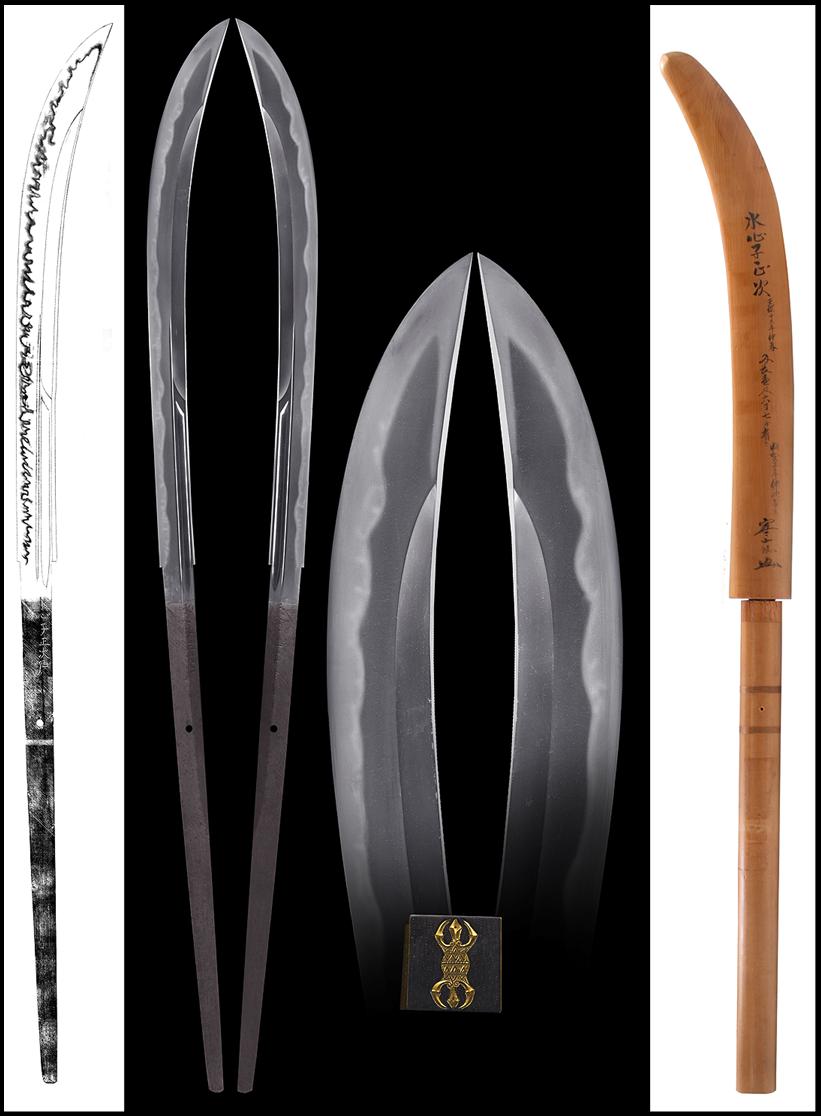

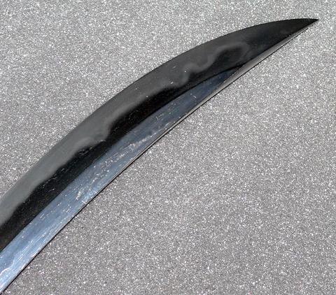

drbvac Posted April 17, 2011 Report Posted April 17, 2011 I always liked the look of them regardless if it was the weapon for the women. I bought this one a while ago and love it ! Dotanuki Quote
Carlo Giuseppe Tacchini Posted April 17, 2011 Report Posted April 17, 2011 Nice one Doc. Nagasa ? Quote
drbvac Posted April 17, 2011 Report Posted April 17, 2011 Nagasa 46.3 cm Nakago 47.1 cm - nice beefy! Quote
watsonmil Posted April 17, 2011 Report Posted April 17, 2011 For someone who pulled teeth for a living, .... all that laughing gas has not damaged your taste. Very nice Naginata ! Thank you for showing it off. Do you have the Koshira by chance ?? ... Ron Watson Quote
drbvac Posted April 17, 2011 Report Posted April 17, 2011 I wish - No it is in shirasaya. Mei is Dotanuki Matahachi - 1573-1592 I really like the hamon Quote

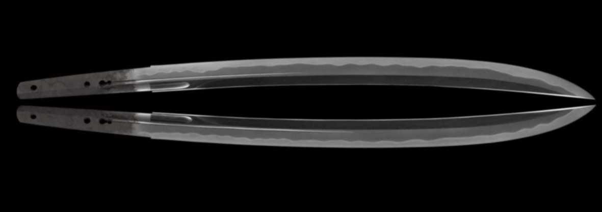

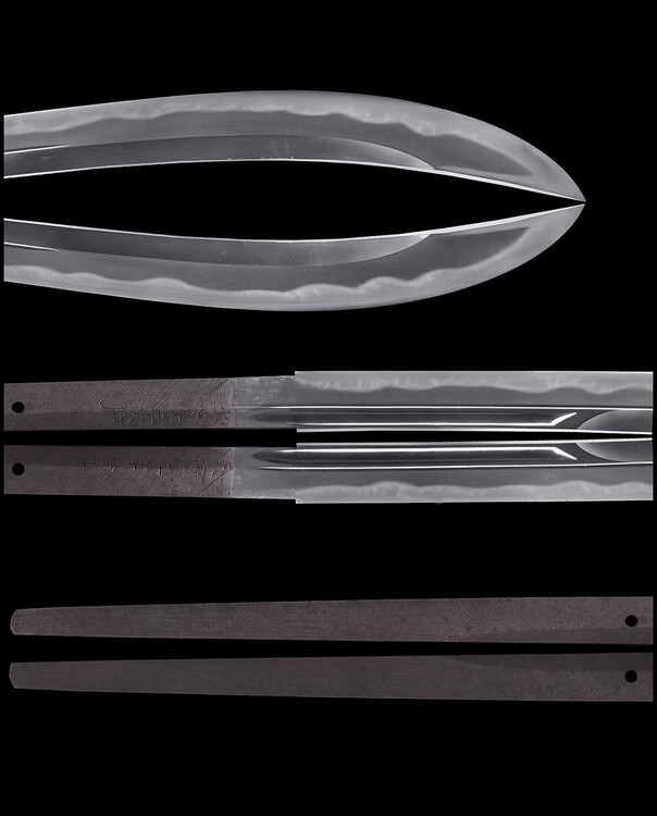

Justin Posted April 18, 2011 Report Posted April 18, 2011 I bought this from Tsuruta-san a few years ago. It is a beast of a thing by Suisinshi Masatsugu (Masahide's grandson). Dated 1842. Nagasa - 50.5cm. It is amazing to hold. The shirasaya has been reinforced with hardwood around the opening to handle the weight. Quote

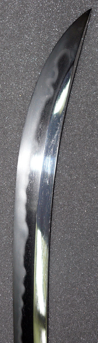

DirkO Posted April 18, 2011 Report Posted April 18, 2011 Here's a Echizen no Daijo Fujiwara Kunitsugu I used to own (sold it a good year ago, sacrifices must be made if you only have a small collection) - nagasa 53cm, but I especially liked it for it's unusual shape Quote

Jacques Posted April 18, 2011 Report Posted April 18, 2011 Hi, I know this naginata very well. Not an outstanding work but an unusual tsukurikomi. Quote

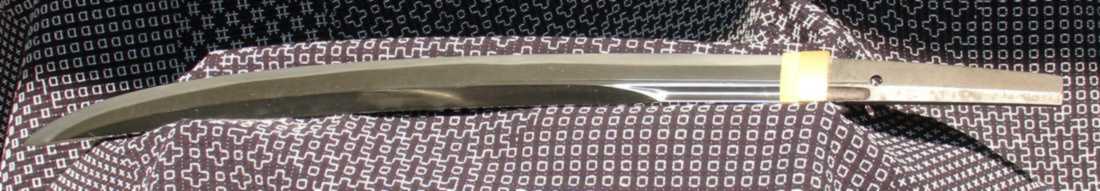

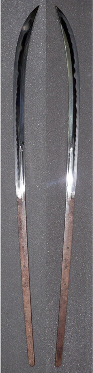

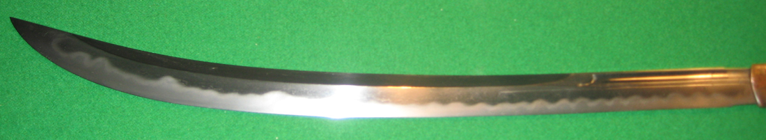

rkg Posted April 18, 2011 Report Posted April 18, 2011 Aside from their cool shape and the acres of hada they have to study/enjoy, naginata are interesting because they're difficult to make and really show off how good (or bad) a swordsmith is. I think these pieces with the sharpened back side were a late change for them so they could be used more like yari. Here's a couple I have that are made this way (sorry for the old pics - maybe I'll have time before too long to reshoot so they can be better appreciated - I still don't know about restoring the Fukuro one - it apparently was never mounted (or final polished), and I don't know whether to leave it as-is, have it fully polished, or just have one side polished) http://home.teleport.com/~rkg/photos/ku ... blade1.jpg http://home.teleport.com/~rkg/photos/ub ... verall.jpg Decent ones aren't that hard to find (you kind of have to ask around, as it seems most online sites don't put them up anymore (must have gotten tired of them sitting)), but here's a couple that aren't too bad :-) http://www.sanmei.com/contents/media/T1 ... _PUP_E.htm http://www.aoi-art.com/sword/sale/10568.html Best, rkg (Richard George) Quote
