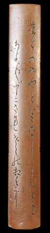

I have one that has a signature on the face, but, it is in no way by the artisan. It is a tribute to a poet, in this case Shokusanjin (Ota Nampo). A Tanka is on the reverse. Quite a while ago Morita san translated it for me. I think it is similar in concept to the kozuka signed with Touu.
(雀とのお宿はとこかしらねともちよちよこされ(御座れ)ささの相手に).
"Flying Mr. Sparrow (bird),I don't know where your home (nest), chiyo , chiyo, come here as a drinking partner".
John
