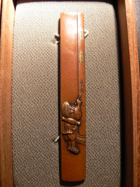

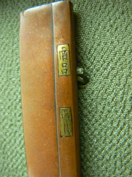

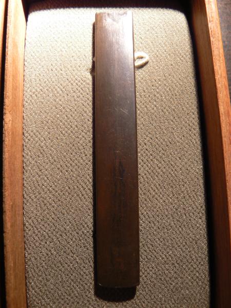

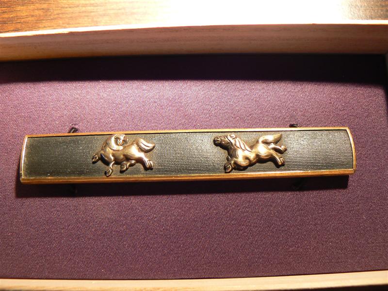

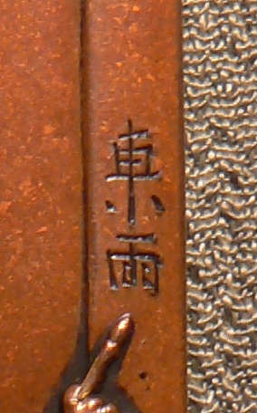

fritaly Posted April 11, 2011 Report Posted April 11, 2011 Hello, Please find below some pics from 2 kozukas I bought several months ago. I'd like to share them with you. First kozuka: Two horses on a nanakoji with gilted back. I don't know the metal the horses are made of (I suppose it's gold but I could be wrong) Second kozuka: A traveller writing with a paint brush on a column. The written kanjis are the artist's name (I guess since I didn't translate it). Any comments appreciated.

John A Stuart Posted April 12, 2011 Report Posted April 12, 2011 I wonder if this is 車両 or something to do with rain 雨? John
fritaly Posted April 12, 2011 Author Report Posted April 12, 2011 Here is a closer shot Does it mean that these kanjis are not the maker's name ?
reinhard Posted April 12, 2011 Report Posted April 12, 2011 Kanji read: TOU This is the alternate artist name of Tsuchiya YASUCHIKA. He is probably not the maker of this kozuka. I like the sense of humour though. reinhard
John A Stuart Posted April 13, 2011 Report Posted April 13, 2011 I didn't know he signed Touu, Reinhard. 東雨 Touu, eastern rain. John

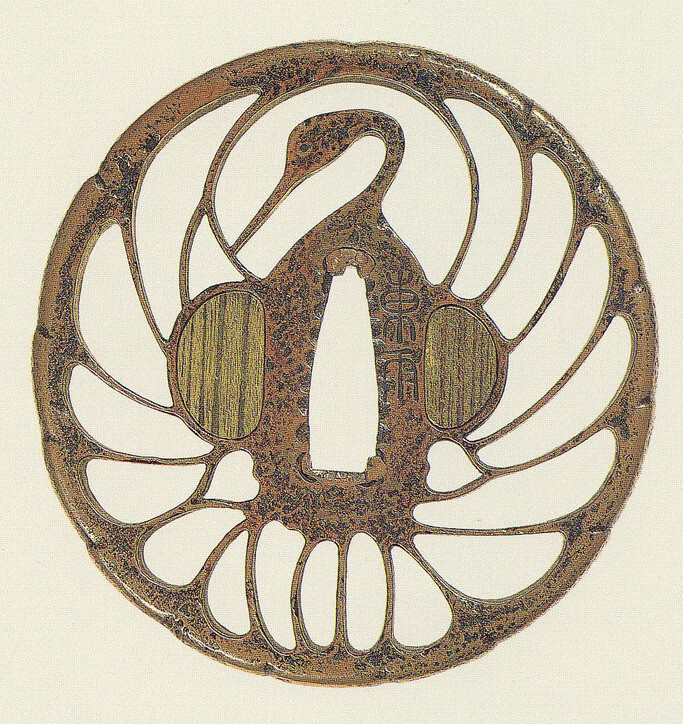

Lorenzo Posted April 13, 2011 Report Posted April 13, 2011 That is the latter (monk) name of Yasuchika, Reinhard is spot on. There are few tsuba signed like that, one of the most famous being this one: I don't think the kozuka is made by Tsuchiya Yasuchika though. The kanji could be a tribute by a latter artist.
fritaly Posted April 13, 2011 Author Report Posted April 13, 2011 Thanks for your informative comments. I doubt the second kozuka is from this known artist simply because it was a bargain on ebay and I can't imagine being so lucky
Lorenzo Posted April 13, 2011 Report Posted April 13, 2011 You are welcome. While we are on this topic just another thing you can see on the tsuba about his name; while the mei Yasuchika was signed using Kaisho 楷書, the regular script calligraphy, Touu 東雨 is often (always?) written in Tensho 篆書. Tensho is the seal script calligraphic style.
Brian Posted April 13, 2011 Report Posted April 13, 2011 I don't think the kozuka is made by Tsuchiya Yasuchika though... Let's not be so diplomatic in the name of education. The kozuka isn't made by Yasuchika. No chance at all I'm afraid. But then I suspect that the OP knows this and won't be crushed. It is average work, nice enough but late Edo probably. I think it is better than the 1st one which looks more touristy. Good examples of useable kozuka of the type that were commonly used. Brian

fritaly Posted April 13, 2011 Author Report Posted April 13, 2011 Let's not be so diplomatic in the name of education. The kozuka isn't made by Yasuchika. No chance at all I'm afraid. But then I suspect that the OP knows this and won't be crushed. It is average work, nice enough but late Edo probably. I think it is better than the 1st one which looks more touristy. Good examples of useable kozuka of the type that were commonly used. Brian Regarding the first kozuka: I got to show it once to a person who sells Japanese antiques here in France and noticed his face when I handed out to him but (unfortunately for me) he didn't comment on it. So thanks for your comment, at least I have an idea of what's it's worth.

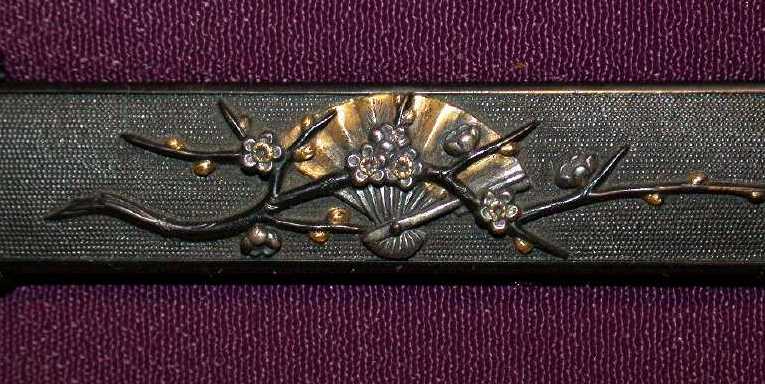

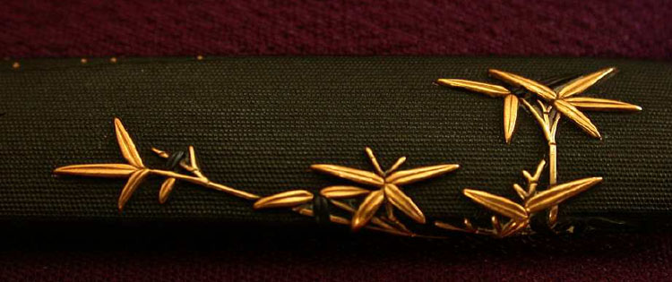

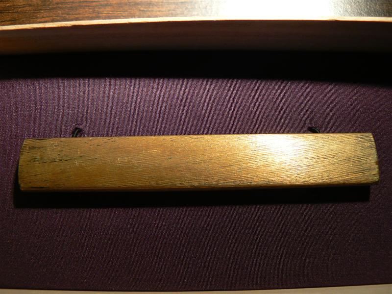

Brian Posted April 13, 2011 Report Posted April 13, 2011 Francois, I think the key is in the nanako. To the untrained eye, most nanako looks good. But when you study it close up, you can start to get an idea of what very good work looks like. An example of poor to mediocre nanako: Then you have pretty good nanako And finally...what to look for in great nanako: All the dots should line up, and be almost perfect. You will know it when you see it. Brian

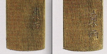

reinhard Posted April 14, 2011 Report Posted April 14, 2011 Touu 東雨 is often (always?) written in Tensho 篆書. Tensho is the seal script calligraphic style. Lorenzo, the TOU mei is found in both writing styles. Tensho style is most commonly found on his tsuba, whereas the "regular" style is often found on the backside of kozuka (see attachment). Francois, although this is probably not the work of great YASUCHIKA/TOU, it is a nicely crafted piece of work with a good sense of humour. It is much better and far more interesting in many respects than the poor horse-theme kozuka. I would love to see a sharp image without reflections, if you please. reinhard
estcrh Posted April 14, 2011 Report Posted April 14, 2011 Francois,I think the key is in the nanako. To the untrained eye, most nanako looks good. But when you study it close up, you can start to get an idea of what very good work looks like. An example of poor to mediocre nanako: Then you have pretty good nanako And finally...what to look for in great nanako: All the dots should line up, and be almost perfect. You will know it when you see it. Brian Brian, This is a great way to get the idea across, by not only explaining the difference but by also posting images of each type at the same time. Anyone seeing this will have no doubt if they are looking at poor, medium or excellent nanako in the future.
Lorenzo Posted April 14, 2011 Report Posted April 14, 2011 Thank you Reinhard For my education, can you please tell me if I am seeing correctly your image? Are the two traits I marked in red not written or very short? (could be a kantei point) and is the blue trait done as I marked? Thank you in advance Lorenzo

Lorenzo Posted April 15, 2011 Report Posted April 15, 2011 François, I would forget that Tou to be the signature. Believe me, it's not. Do not concentrate on it; you have an average Edo Jidai Kozuka, which exhibit a nice humor and a clear "kesho" copper grain. Be happy with it but don't fool yourself in trying to establish any link with any great artist of Japanese history. That Tou isn't the signature of the piece, it is a decoration Regards, L
Muki Posted April 15, 2011 Report Posted April 15, 2011 Will someone elaborate more on other one as well? What is the metal it is made from and what makes this a "tourist" creation? jim
Lorenzo Posted April 15, 2011 Report Posted April 15, 2011 In my personal opinion, I don't think it is a tourist item. It is a simple kozuka, but genuine of the period. The material may be gold gilded shakudo, and the horses probably gilded copper or silver (can't figure out by that picture alone)
