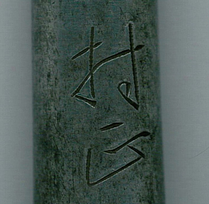

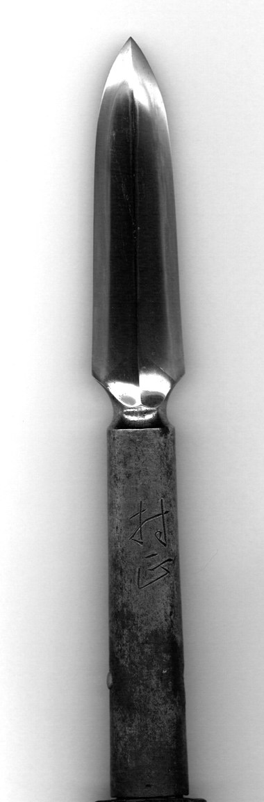

A friend of mine has acquired a fukuro yari. What do you think of the signature? It has some history and is accompanied by an origami by Hon'ami Koson.

Can we see some pictures of the Yari.
Micha,
one pic is attached to the first post.
Gimei? Maybe. What is the reasoning behind your statement?
Dear Mariusz,

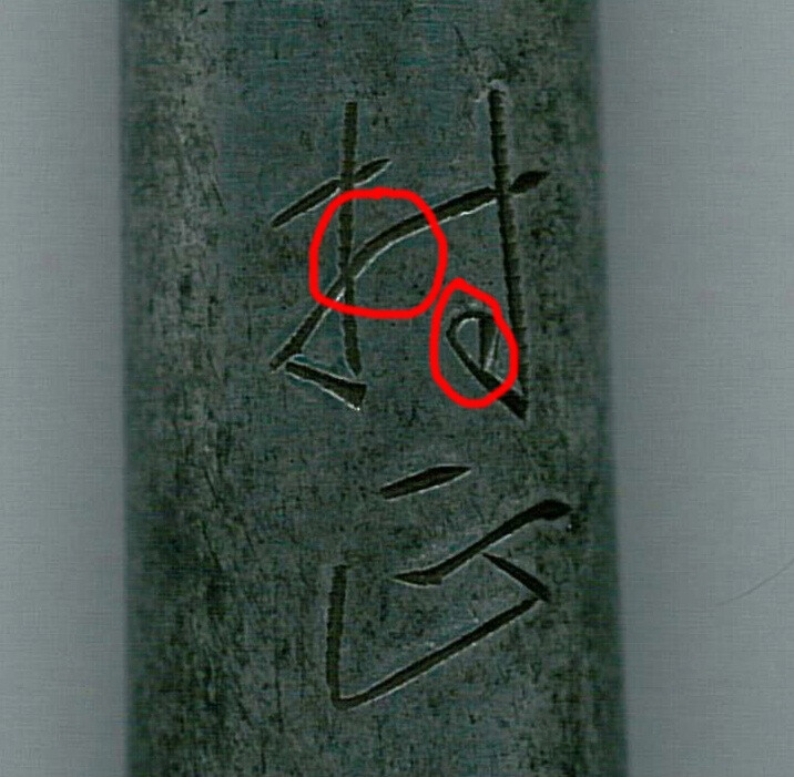

I've seen many signatures of this smith and yours doesn't look like it at all.
If you have much fantasy you can say the Masa character looks like a first generation. But even with this fantasy you can't say the MURA character is genuine. Read the article again.
OR .... maybe there's a generation I haven't seen yet.

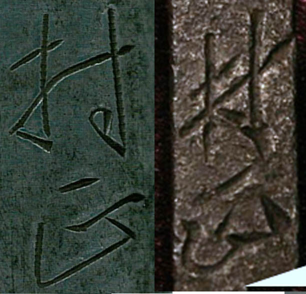

Here's signature of a genuine second generation Yari (sold by Darcy).Even if you don't see to the details you notice that it feels stronger.
M.
Thanks for the pic. This is completely different and the signature here shows that it was done in a very confident manner. It is strong indeed.

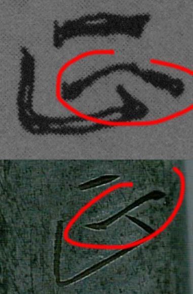

Hi,
The Masa character below is the one I meant when I said 'with some fantasy'. Like you can see you need a lot of fantasy.
The first generation is the only one who signed this way.
The second picture shows the more usual way.
