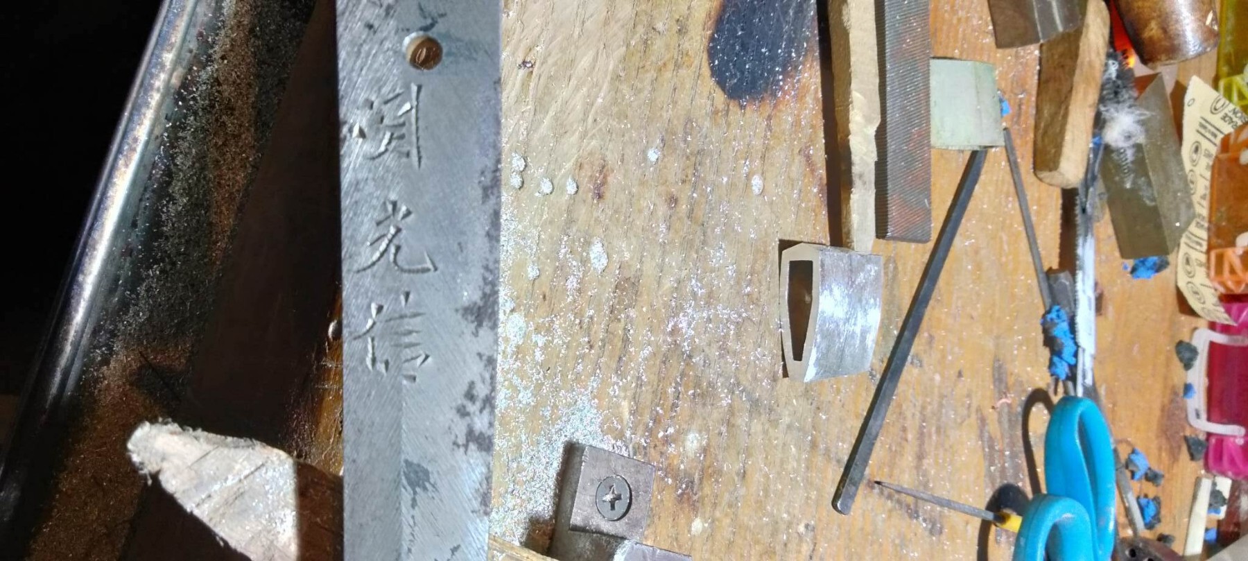

David Flynn Posted April 20, 2011 Report Posted April 20, 2011 Don't be fooled by thinking any sword signed with Seki in it, is not a Gendaito. I have a sword signed Seki Kanenobu Which was chosen by Yoshikawa sensei, at the 2009 Sydney shinsa as the outstanding Gendai, when best of show was being presented. Unfortunately, someone had removed the date, and Yoshikawa sensei gave it reduced points due to this. I was told, that had the date not been removed, it would have scored more points than the Shigetsugu I also submitted. Quote

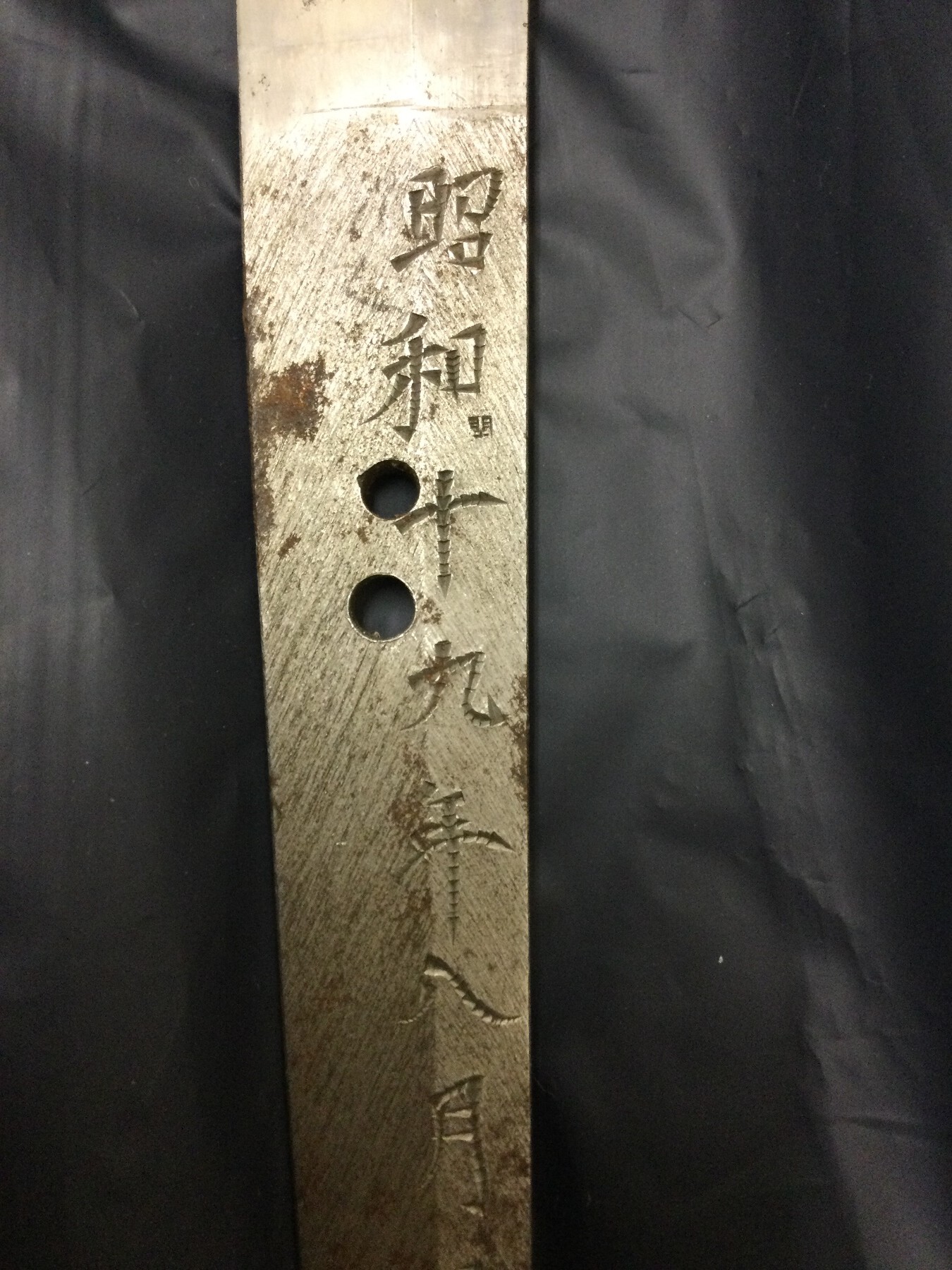

John C Posted August 4, 2023 Report Posted August 4, 2023 Not sure if mine is included in the chart, however I too have a Kanehide (Aug 44) with small seki near date AND on the mune. John C. 1 Quote

lonely panet Posted August 4, 2023 Report Posted August 4, 2023 On 4/20/2011 at 8:05 AM, David Flynn said: Don't be fooled by thinking any sword signed with Seki in it, is not a Gendaito. I have a sword signed Seki Kanenobu Which was chosen by Yoshikawa sensei, at the 2009 Sydney shinsa as the outstanding Gendai, when best of show was being presented. Unfortunately, someone had removed the date, and Yoshikawa sensei gave it reduced points due to this. I was told, that had the date not been removed, it would have scored more points than the Shigetsugu I also submitted. Expand also please remind them of the RJT uses of sho stamps on nakago munes Quote
