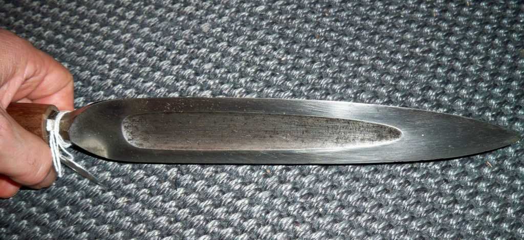

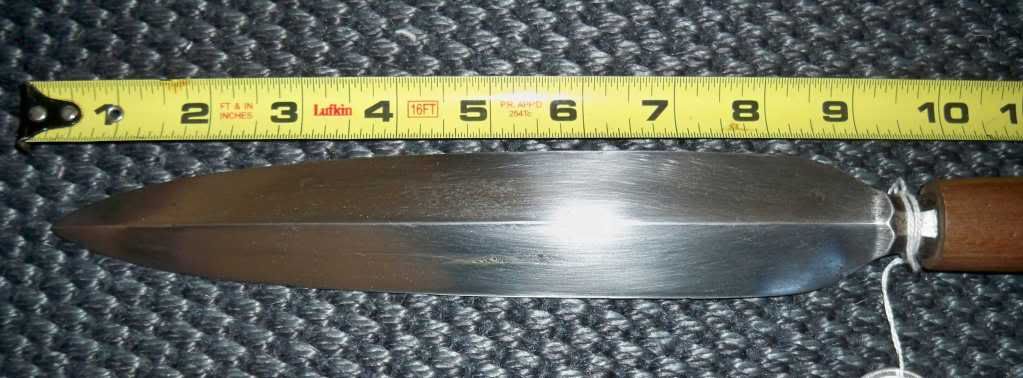

estcrh Posted April 8, 2011 Report Posted April 8, 2011 I have been looking for a name for this type of yari and have been unable to find pictures of another one. It has been suggested that it may be for hunting. If anyone has any information I would appreciate it. Quote
sanjuro Posted April 8, 2011 Report Posted April 8, 2011 Sasa marugata........ Bamboo leaf shape. Not for hunting but a legitimate style for war . For a famous example see 'Tombo giri' Honda Tadakatsu's yari. (incidentally, his is bigger than yours, but they tell me size doesn't matter). If you are of a mind to sell this example, I know someone who would love to own it. :D Quote
estcrh Posted April 8, 2011 Author Report Posted April 8, 2011 sanjuro said: Sasa marugata........ Bamboo leaf shape. Not for hunting but a legitimate style for war . For a famous example see 'Tombo giri' Honda Tadakatsu's yari. (incidentally, his is bigger than yours, but they tell me size doesn't matter). If you are of a mind to sell this example, I know someone who would love to own it. :D Keith, I could not find anything online under that name but when I searched for "leaf shaped yari" this term came up "sasaho yari", and searching with this term got some results, thanks. http://www.ricecracker.com/japanese_swords/s17.htm Quote

Jacques Posted April 8, 2011 Report Posted April 8, 2011 Hi, IMHO this kind of yari is called O sasaho hira sansaku tsukuri yari. Quote
sanjuro Posted April 8, 2011 Report Posted April 8, 2011 Jacques D. The Tombo giri example I referred to is referred to as 'O' sasaho...... etc....etc, because of its extreme length (over 43 cm, if memory serves correctly). Eric's example I think would just be sasaho hira sansaku tsukuri yari. (Its still enough of a mouthful, even with the slight abbreviation). :D Quote
estcrh Posted April 8, 2011 Author Report Posted April 8, 2011 Jacques D. said: Hi, IMHO this kind of yari is called O sasaho hira sansaku tsukuri yari. I thought that "sansaku" refer to a diamond shaped blade? Quote
sanjuro Posted April 8, 2011 Report Posted April 8, 2011 I thought it was a three sided blade. The Japanese word 'san' means three. Ichi, ni, san, shi......... etc. Quote
Jacques Posted April 8, 2011 Report Posted April 8, 2011 Hi, You're right Keith, O is only for the tombo giri. Quote
Jacques Posted April 8, 2011 Report Posted April 8, 2011 Hi Eric, Quote I thought it was a three sided blade. The yari we talk about is made like this even if its cutting edges are not straight. Quote
sanjuro Posted April 8, 2011 Report Posted April 8, 2011 As a postscript, Kanzan Sato In his book 'The Japanese Sword' gives this bamboo leaf style as 'sasaho tsukuri'. I dont know about you guys but I am more than prepared to accept professor Sato's word on anything nihonto. The 'O' used in the description of the tombo giri is not only due to its length but also to the fact that it is one of the three great spears of Japan and it is considered the greatest work of Masazane. The 'O' meaning great or indicating a masterpiece. Quote
estcrh Posted April 8, 2011 Author Report Posted April 8, 2011 Jacques D. said: The yari we talk about is made like this even if its cutting edges are not straight. Jacques, yes your right. I was not thinking about the cross section correctly. I meant triangular not diamond but it is a triangular shape. Quote
estcrh Posted April 8, 2011 Author Report Posted April 8, 2011 sanjuro said: As a postscript, Kanzan Sato In his book 'The Japanese Sword' gives this bamboo leaf style as 'sasaho tsukuri'. I dont know about you guys but I am more than prepared to accept professor Sato's word on anything nihonto.Keith, do you know what "tsukuri" refers to? Quote
sanjuro Posted April 8, 2011 Report Posted April 8, 2011 I believe that the word tsukuri literally means 'make' or style. In this sense 'bamboo leaf make' or style. Sasa is bamboo, Ho I'm not sure about in this context. 'Leaf' or 'leaf shape' would be as close as I can get. Hence, 'bamboo leaf shape style'. My Japanese and its usage which I find rather complex to say the least, leaves much to be desired. Quote
Bugyotsuji Posted April 8, 2011 Report Posted April 8, 2011 Eric, Tsukuri means 'made' but more particularly 'the way it is fashioned', and in this case 'fashioned into the style of' sasa-ho. Quote

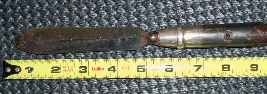

estcrh Posted April 8, 2011 Author Report Posted April 8, 2011 Bugyotsuji said: Eric, Tsukuri means 'made' but more particularly 'the way it is fashioned', and in this case 'fashioned into the style of' sasa-ho.Thanks everyone, I see now, tsukuri refers to the body shape as opposed to the cross section shape. Now I have one more question. This yari is diamond shaped, it is not flat, it has two cutting edges and two ridges so it is ryo-shinogi, but would this shape be considered as sasa-ho? Quote
Bugyotsuji Posted April 8, 2011 Report Posted April 8, 2011 This is a different yari, right? My guess is that with the bulge further forward, it would not be called a Sasa-ho tsukuri, but a 'Ryo-shinogi Choku yarimi' 両鎬直槍身 Using 日本の甲冑武具事典 p402 Quote
sanjuro Posted April 8, 2011 Report Posted April 8, 2011 Eric. This second example is simply the wrong shape to be called bamboo leaf shaped. I refer here to the outline only not the presence or absence of ridges. The first example in silhouette looks exactly like a bamboo leaf. This second example has a forward flare to the blade, most unlike a bamboo leaf, hence not sasaho tsukuri. Quote

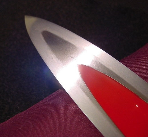

Mark Green Posted April 8, 2011 Report Posted April 8, 2011 First yari, looks to be a very nice, good size, standard, "sasaho yari". Very nice! Nice fat bo-hi, without the lacquer you often see in these. Love it! Mark G oops, that's a pretty one too mariuszk Quote
Carlo Giuseppe Tacchini Posted April 8, 2011 Report Posted April 8, 2011 estcrh said: It has been suggested that it may be for hunting. If anyone has any information I would appreciate it. As suggested the topic's one is Sasaho Hira sankaku tsukuri Yari. But this type is also made in Ryo shinogi form, which the hunting ones belong to. As a not-so-strict rule, difference between hunting and fighting types of the Ryo Shinogi variation is in the carving. Hunting ones used to kill inoshishi usually have carving(s) that completely pass thru the blade. Quote

estcrh Posted April 8, 2011 Author Report Posted April 8, 2011 sanjuro said: As a postscript, Kanzan Sato In his book 'The Japanese Sword' gives this bamboo leaf style as 'sasaho tsukuri'. I dont know about you guys but I am more than prepared to accept professor Sato's word on anything nihonto. Quoting from "The Japanese sword" By Kanzan Satō p.63, he seems to imply that sasaho-zukuri is a blade cross section type along with ryoshinogi-zukuri and sankaku-zukiri. Am I just understanding the meaning of this this wrong? Quote Of the large yari which became fashionable at the end if the Muromachi, the ryoshinogi-zukuri ("two ridged form"), the sankaku-zukuri ("three corner form"), sasaho-zukuri (ridged in the center of one side only) all originated in the same period. Is Kanzan Satō calling the three sided yari with unequal sides "sasaho-zukuri" and the yari with three equal sides sankaku-zukuri? Is sasaho used to describe cross section as well as body shape? It is confusing as some sources describe sankaku as being triangle shape with three equal sides and other sources use sankaku to describe all three sided yari even the yari with one wide flat side and two equal sides. Quote
sanjuro Posted April 9, 2011 Report Posted April 9, 2011 I see your dilemma........ It has always been my understanding that sansaku is a generic term for all three sided yari, most of which have parallel sides for the majority of their length. The sasaho tsukuri whilst being technically a sansaku (Three sided blade) is distinguished in having a taper at both ends of the blade thus giving it the bamboo leaf shape. If one were to be totally accurate then the sasaho is correctly described as a 'sasaho sankaku tsukuri' blade. The name simply describes the nature of the blade as a three sided blade with the shape of a bamboo leaf as opposed to a three sided blade of the more common parallel type. However, I could be wrong here, and am quite willing to be corrected. Quote
