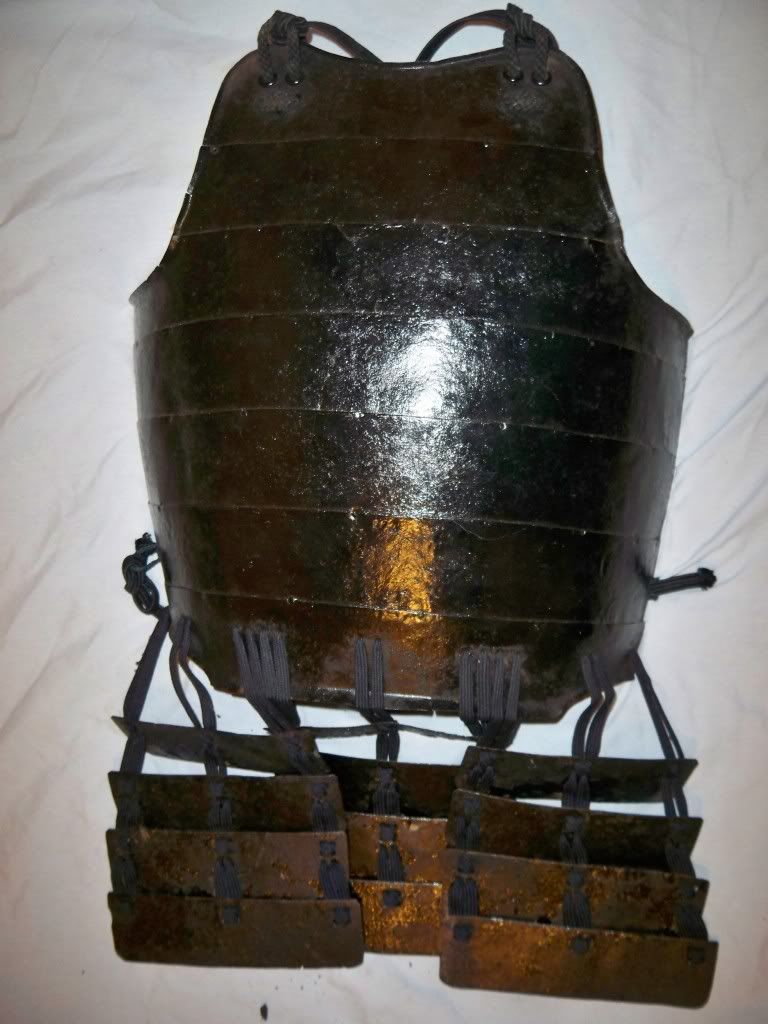

Birdman Posted April 6, 2011 Report Posted April 6, 2011 I want to try to make a replica of a hara-ate dou. Figured on using 18 gauge CRS for the plates, and rivetting it together. However, I am wondering if any were made with protruding rivets, as on some okegawa dou I have seen, or if they were all flush-rivetted. I am trying to make it as authentic-looking as possible, with regards to available materials (obviously, I can't use urushi or kashu lacquer, as both are banned from import into the USA, and hand-hammered and forged plates would be seriously cost-prohibitive). Eventually, I want a complete set of ashigaru armor that can be worn as well as displayed (I wouldn't want to wear antique armor - I'd be afraid of accidentally chipping the lacquer against something, besides being sized for the average Japanese...). Can any of you who are familiar with armor please help me out with this? Quote

estcrh Posted April 7, 2011 Report Posted April 7, 2011 All the ashigaru dou I have seen has had flush rivets, maybe someone here has seen some with raised rivets. Here is a link to a couple that I have. http://s831.photobucket.com/albums/zz23 ... ?start=all Quote

Birdman Posted April 7, 2011 Author Report Posted April 7, 2011 Arigato gozaimasu! Eric, it looks like the rivets are visible on the dou in the first photo. Could you possibly post a photo with close-ups of those, please? Hyper-cafe is one of the places I checked, but last time I checked them they were out of EVERYTHING in the lacquer department. Guess I will just have to keep checking in every week (or every few days) until they restock. Quote
estcrh Posted April 7, 2011 Report Posted April 7, 2011 Arigato gozaimasu! Eric, it looks like the rivets are visible on the dou in the first photo. Could you possibly post a photo with close-ups of those, please? There is a link to all the photos I have along with the pictures. Did you see it? Quote
Birdman Posted April 7, 2011 Author Report Posted April 7, 2011 There is a kink to all the photos I have along with the pictures. Did you see it? I dunno... sounds kinda KINK-y to me! Seriously, I did miss the link. Thanks! I also managed to contact A.J. Bryant, who has the http://www.sengokudaimyo.com website. Good site, with information on the construction of Japanese armor (and other info as well). He says that dome-headed rivets are perfectly acceptable on a hara-ate. Quote
