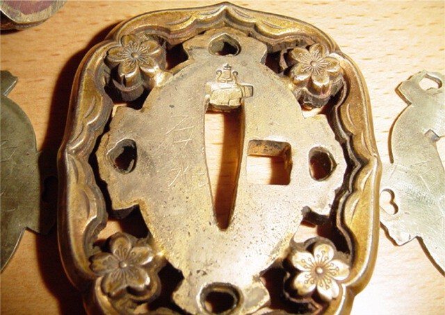

Pelleman Posted March 21, 2011 Report Posted March 21, 2011 Hi! My first post here. I guess you guys get a million "is this sword genuine?" questions but I don't know where to turn. I have spent a whole day searching and reading about shin guntos as I have found one on a Swedish auction house. They claim it's an original but I know that even though they are a respected firm, even those make mistakes. I am leaning towards it being a fake actually. I only have three pictures to go on and what raises my suspicion is the Tsuba. The wrapping is all wrong also but that culd have been messed up by anyone during the past 60+ years. Regarding the tsuba, I have compared it with pictures of genuine shin gunto tsubas from known collectors and if you look at details like the flowers it just doesen´t have the same finesse and detail. Or did they become less delicate in the production later in the war? Pics are too big to post so you'll have to cut & paste the address http://193.238.185.184/images/2182372?s ... al&index=1 http://193.238.185.184/images/2182372?s ... al&index=2 http://193.238.185.184/images/2182372?s ... al&index=3 Quote
Pelleman Posted March 21, 2011 Author Report Posted March 21, 2011 If you look at a known genuine tsuba like this, the details like those on the flowers are more detailed and less "messy". Quote
kusunokimasahige Posted March 22, 2011 Report Posted March 22, 2011 Pelleman, who tried to sign your Gunto tsuba ? I never saw a "signature" on a Gunto tsuba. The stamp intrigues me though ! KM Quote
Pelleman Posted March 22, 2011 Author Report Posted March 22, 2011 It's not my tsuba, it's just a picture I have for comparison. Found it on a collectors site. From what I gather, there were at least six different types of tsuba and two with an open design like that of the sword in question. Quote

Bruno Posted March 22, 2011 Report Posted March 22, 2011 kusunokimasahige said: who tried to sign your Gunto tsuba ? I never saw a "signature" on a Gunto tsuba. I did and can garantee everything was guenine, furthermore the signature had the same cheappy style. Quote
Stephen Posted March 22, 2011 Report Posted March 22, 2011 Quote kusunokimasahige wrote:who tried to sign your Gunto tsuba ? I never saw a "signature" on a Gunto tsuba. not really a mei but more of a stocking number Quote

BenoitD Posted March 30, 2011 Report Posted March 30, 2011 Stamp on tsuba is for the Suya Company of Tokyo who worked in 1934 through 1936 in conjunction with the Kokura arsenal in making swords and fittings. This company known as the Suya Sho Ten was used by the Suikosha, or Navy Supply Center. The company made gunto koshirae. The owner of the company was Mr. Shimada. This company started back in the Meiji era and had a long history of making koshirae, including those for members of the Imperial family and many high ranking officers and diplomats. Benoit D Quote
