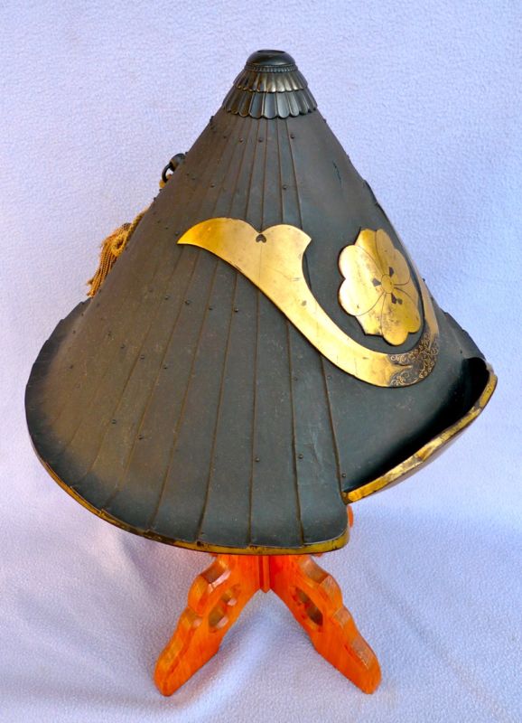

estcrh Posted March 29, 2011 Report Posted March 29, 2011 Here is a jingasa of the same style as yours that is for sale on ebay right now, just for reference. http://cgi.ebay.com/ws/eBayISAPI.dll?Vi ... 346802252+ Quote
Birdman Posted March 29, 2011 Author Report Posted March 29, 2011 Interesting! And the same basic kamon, too (minus the circle, or "maruni"). That one looks like a piece for a higher-ranking official rather than a lowly ashigaru. I showed the pics on the Toraba collectors forum. The forum admin, who also collects and sells antique gusoku, said that mine is very late Edo (post 1800), as this style did not come out until then. Quote
