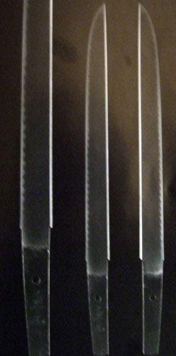

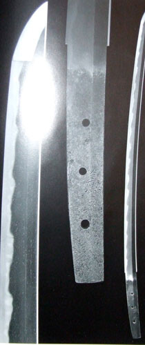

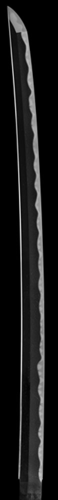

IchiNi Posted March 13, 2011 Report Posted March 13, 2011 Dear all, i've been offered this blade (see attached pics) it really does look nice but comes with an obscure ceritficate (pics attached). the seller claims it to be KANEMOTO of MINO. i'm sort of doubtful. any advice|comments would be greatly appreciated cheers vlad Quote
Stephen Posted March 13, 2011 Report Posted March 13, 2011 I think you shold buy it and send to me for study it wont take long maybe five years...smile...really its very nice id not worry about the mei, or kami, study the blade. Quote
cabowen Posted March 13, 2011 Report Posted March 13, 2011 Very nice though not Magoroku the famous Kanemoto, one of the later Kanemoto is very likely....As the comments mention, very well forged.... Quote
John A Stuart Posted March 14, 2011 Report Posted March 14, 2011 Yes, looks like a very fine Seki Minoto, but, Chris it does attribute to Magoroku Kanemoto, I believe. 孫六兼元 in kinmei 金銘. John Quote
reinhard Posted March 14, 2011 Report Posted March 14, 2011 but comes with an obscure ceritficate Show us the opposite side of this obscure certificate, if you please. reinhard Quote
Curran Posted March 14, 2011 Report Posted March 14, 2011 Sort of heavy handed on the sambontsugi. I would think this later generation Kanemoto. Quote
Surfson Posted March 14, 2011 Report Posted March 14, 2011 Looks like a very attractive blade and worthy of study. The sanbonsugi appears to be there, and to move through the kissaki, one indicator that it may be an older blade. Unfortunately, the kesho polish seems to obscure the hamon throughout. Quote
cabowen Posted March 14, 2011 Report Posted March 14, 2011 Yes, looks like a very fine Seki Minoto, but, Chris it does attribute to Magoroku Kanemoto, I believe. 孫六兼元 in kinmei 金銘. John Yes, I noticed that....the sanbon sugi seems much to uniform compared to the Magoroku blades I have seen....everyone is entitled to their own opinion... Quote
Jean Posted March 14, 2011 Report Posted March 14, 2011 By its design (difficuly to see) it is typical Mino hamon. One thinks immediately to sanbonsugi. This one is so shy that it makes rather me think of Kanefusa : http://www.aoi-art.com/sword/wakizashi/07559.html Probably 3rd Generation Quote
John A Stuart Posted March 14, 2011 Report Posted March 14, 2011 This is one of the things about Kanemoto. He was the student of Kanesada of Akasaka as was Nosada. His hamon had enormous variety and some were quite regular, although the sanbonsuji hamon he creates is often described as irregular especially when compared to later smiths of the line. The sanbonsuji hamon that Jean linked to at Aoi Art is irregular. Another thing is that Kanemoto was not noted for jizo boshi although this does have it. I show two Kanemoto regular hamon, one of which is sanbonsuji. The larger photo is a Minoto that by hamon alone would never be attributed correctly. This sword needs to be studied closely no matter the origami or kinmei. John Quote
george trotter Posted March 14, 2011 Report Posted March 14, 2011 Show us the opposite side of this obscure certificate, if you please.reinhard An interesting sword Vlad. In the interests of learning/teaching the memebers, maybe it would be helpful to NOT show the other side of the origami until others (and some have already) give us their opinion on the maker/age/mei/quality etc. Your pics are quite good. There is quite enough shown to at least offer an opinion. The origami gives a long comment on Kanemoto from among the Kanemoto name generations from MeiO to Showa. I know some people buy/sell and like/dislike based on what an origami says but most learning is done without this aid...it is always a good learning tool to listen to the knowledgeable come to an opinion and then see if it is confirmed (or not) by the standing of who issued the origami. It is the same principle as kantaei of the blade and then look at the mei. I for one would be interested to see this happen here. How about it knowledgeable members? Regards, George. Quote

Brian Posted March 14, 2011 Report Posted March 14, 2011 I am sure others will be along to mention the few down sides here..but let me just point out that the kissaki has been repaired sometime, and not exactly perfectly. Must have had a broken kissaki and they didn't repair the lines perfectly in the ko-shinogi etc. Nice looking sword, but you mention it is pricey, and I would love to know does that mean $3000 or $30,000..or where inbetween? Nice sword at the lower end of that, maybe not as much at the higher end. So depends on your idea of pricey I guess. I am guessing Reinhard also had other motives besides simple identification when he asked for the additional origami pics.... Brian Quote

Jean Posted March 14, 2011 Report Posted March 14, 2011 BTW, if sanbonsugi is a Kanemoto trade mark, there were not the only Mino smiths to have implemented this style of hamon. I know of a perfect Kanehisa with a splendid sanbonsugi 16 K$ for a O suriage Magoroku is Ok, otherwise too expensive (it is not the first generation neither) Quote
John A Stuart Posted March 14, 2011 Report Posted March 14, 2011 Very true, Jean, and others. Unsigned Minoto are very hard to attribute, especially suriage. This sword does exhibit (by these pics) a very nicely forged itame (mokume, let's not start that again) hada and that at least leads one to believe the sword is of a certain quality. Because of Mino swords having such a white steel kesho is used a lot to accentuate the hamon. It makes photographing them more difficult. I have noticed that earlier period Minoto have a darker steel and this includes Magoroku Kanemoto. This whiteness becomes very clear in sue-Koto and shinto blades. Another feature that Magoroku swords sometimes exhibit is utsuri, but, rarely. John Quote
