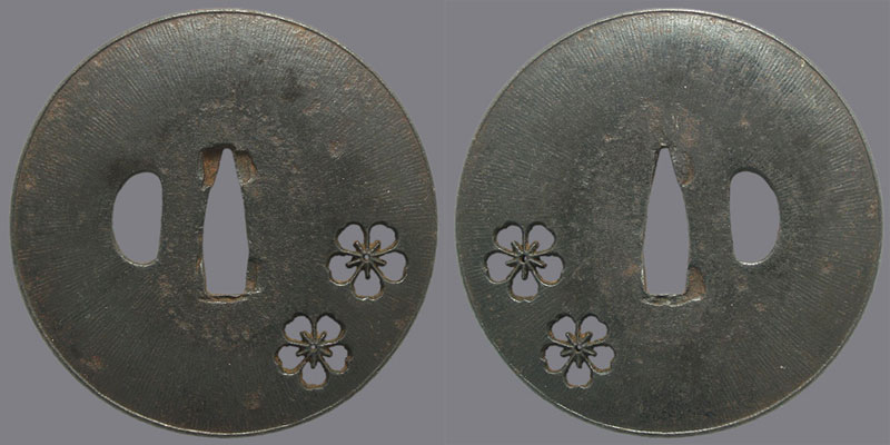

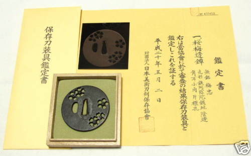

andreYes Posted March 10, 2011 Report Posted March 10, 2011 Please help me to identify the following tsuba: mumei iron tsuba, slightly goishi gata, with fine amida yasuri. Mimi is slightly raised (itobuchi ?). Ko-sukashi of two sakura flowers. Size: 7.34 x 7.30 cm, thickness 0.43-0.25 cm. Could it be an Umetada school tsuba? Age - Edo? Middle or late? Quote
John A Stuart Posted March 11, 2011 Report Posted March 11, 2011 I would definitely attribute this tsuba to Katchushi group. The amidayasuri, the kiku sukashi and the uchikaeshimimi are all within their techniques. I don't subscribe to it being Umetada style. I am not sure of the age, but, could conceivably be Momoyama, early Edo period. John Quote
Curran Posted March 11, 2011 Report Posted March 11, 2011 Would mostly agree with John. Peanut gallery quick opinion: Katchushi, early Edo. Nice one. Well done. Walls of the sukashi would give a partial clue to age. Quote

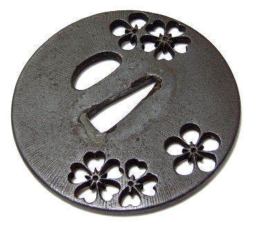

Thierry BERNARD Posted March 11, 2011 Report Posted March 11, 2011 here an umetada tsuba Length 77mm Width 77mm Thickness 4.3mm age about from 17 to 18 century Quote
andreYes Posted March 11, 2011 Author Report Posted March 11, 2011 Thank you, John and Curran! Katsushi was first guess, but I got some doubts when I found in "Nihon To Koza" that amida yasuri, slightly raised edge (called there "itobuchi") and ko-sukashi are characteristics of some Umetada school artists' works. Then I found a similar tsuba with inscription "Umetada" here... Interesting example, Thierry. If there was no shinsa paper, my opinion would be also Katchushi... Quote
docliss Posted March 11, 2011 Report Posted March 11, 2011 Andrey's tsuba is, to my eye, very reminiscent of Umetada Tadatsugu work. John L. Quote
John A Stuart Posted March 11, 2011 Report Posted March 11, 2011 Doesn't the uchikaeshimimi eliminate it as later Umetada (of course with exceptions), unless ko Umetada? John Quote
Soshin Posted March 12, 2011 Report Posted March 12, 2011 Based upon similar tsuba in my collection and what I have seen I would say early Edo Katchushi. I really like the tsuba. :D This is all just my opinion. The ko-sukashi designs I don't think are as complex as you see in the Umetada school during the early to middle Edo. The mimi is also characteristic of Katchushi. The provided Umetada example shows this more complex ko-sukashi design I am referring to as well as the difference in the mimi. Yours truly, David S. Quote
Curran Posted March 12, 2011 Report Posted March 12, 2011 Soon to bed and tired as one can get, so forgive me if I am not laser precise on this. I always forget that this design is common in the later Umetada works. However, the Umetada work seems to usually be of flatter plate without worked mimi. Also, the sukashi usually has an overlapping image at some point- as illustrated by the two examples of Umetada tsuba posted. I could be wrong and it is Umetada, but I agree with John about the mimi. I also see a raised surface similar to what I call go-stone shape that seems to have been slightly in vogue among certain smiths during the 1600s. I own a very nice example of this sort, but no images of it. Also, the sukashi says to me that it has naturally aged (thinned) a bit more in keeping with slightly older work. My gut feeling was and is that this is 1600s katchuchi style work. I'd date it somewhere between 1650 and 1700s. Confidence level is not absolute, but I lean away from an Umetada attribution. Quote
John A Stuart Posted March 12, 2011 Report Posted March 12, 2011 I think the shape is goishigata 碁石形 John Quote
Pete Klein Posted March 12, 2011 Report Posted March 12, 2011 This to me looks to be classic Den Umetada Edo jidai work and does resemble Tadatsugu work as John pointed out. The fine amida yasuri and uchikaeshi mimi were used with different sukashi work themes from shells to snow flakes to blossoms in differing numbers. There is usually a bit of a curvature to the plate as well but not always. And you not? Quote
Curran Posted March 12, 2011 Report Posted March 12, 2011 Peter, When it comes to kantei, especially in anything pre-Edo, I'd rather see your name on the issued papers than mine. I could easily be talked into a _den_ Umetada Edo Jidai attribution. Observing from a photo and processing what I see, I remain inclined to date it a bit earlier and less likely to be one of the (Shoami)-Umetada works. Sukashi is less. Shape is slightly different than I think as common Umetada works of this sort. Age in the sukashi looks older to me, but not that old. Another answer is it could be somewhat earlier Umetada work than most I have seen. For now I will stick to my initial opinion. John, I described it as go stone shaped because it looks to have the identical shape as the signed tosho tsuba I have from early Edo. Jim Gilbert described it as go stone shaped, but reviewing textbook illustrations of what is meant by goishigata, this is not quite what I meant. I don't know if Jim's use of the terminology was wrong at the time, or if it can include tsuba that swell up slightly from the seppa dai and wave down to the mimi. Quote
Pete Klein Posted March 12, 2011 Report Posted March 12, 2011 OK -- let's see if this helps. When I see tsuba which are repetitive in design (meaning I have seen many/countless examples) with semi-refined features (such as fine amida yasuri, fine mimi, etc.) I tend to think Edo period. Pre-Edo work was less inclined to 'mass' production (using this term loosely) and more toward individualistic design and shall we say a more 'rustic' expression (think what are called 'pre-Edo Owari' sukashi and 'wabi'). (This is not to say that refined work was not produced pre-Edo but that it would have been unique or low production). The fundamental goal of the Tokugawa Bakufu was stratification and control by strict hierarchical rule in all facets of society. Confucianism ruled and individualism was crushed. In this environment once a design was deemed 'acceptable' it was worked over like annual car models. Samurai being held under control of the Bakufu had little say as to what they could wear as sword furniture, at least 'on duty' as it were. What we see later around Genroku in the Machibori work was supported by the 'Chonin' class (merchants) and was somewhat 'outside' of the Bakufu's direct influence as the merchant class was considered the lowest and therefore beneath the dignity of the samurai. What is interesting is that around the time of Iyeasu where there was a window of radicalism (think 'Kabuki') where the samurai, now without wars to fight, went toward extremes in culture, clothing and actions. By 1630 this had been successfully quashed by the Bakufu but I have come to believe that much of what we see in tsuba design under the term 'sukashi' began in this time frame being influenced by Ikebana design concepts the practice of which was flourishing. There is little actual evidence of these tsuba existing before this era (take a look through 'Uchigatana Koshirae' and note that there are practically no sukashi tsuba on the koshirae shown from times prior to Edo). Interesting, no? In any case, tsuba produced in numbers with repetitive design components yields the rationale for my attributing the tsuba in question to Edo Jidai, and in this case den Umetada from previously observed examples in hand and literature. 1 Quote

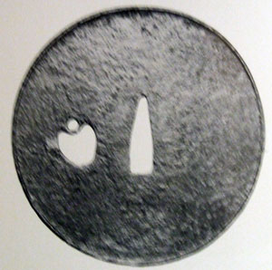

Pete Klein Posted March 12, 2011 Report Posted March 12, 2011 PS: The papered 'Umetada' tsuba on the previous page is most likely a Toda Hikozaemon of Owari piece. Quote

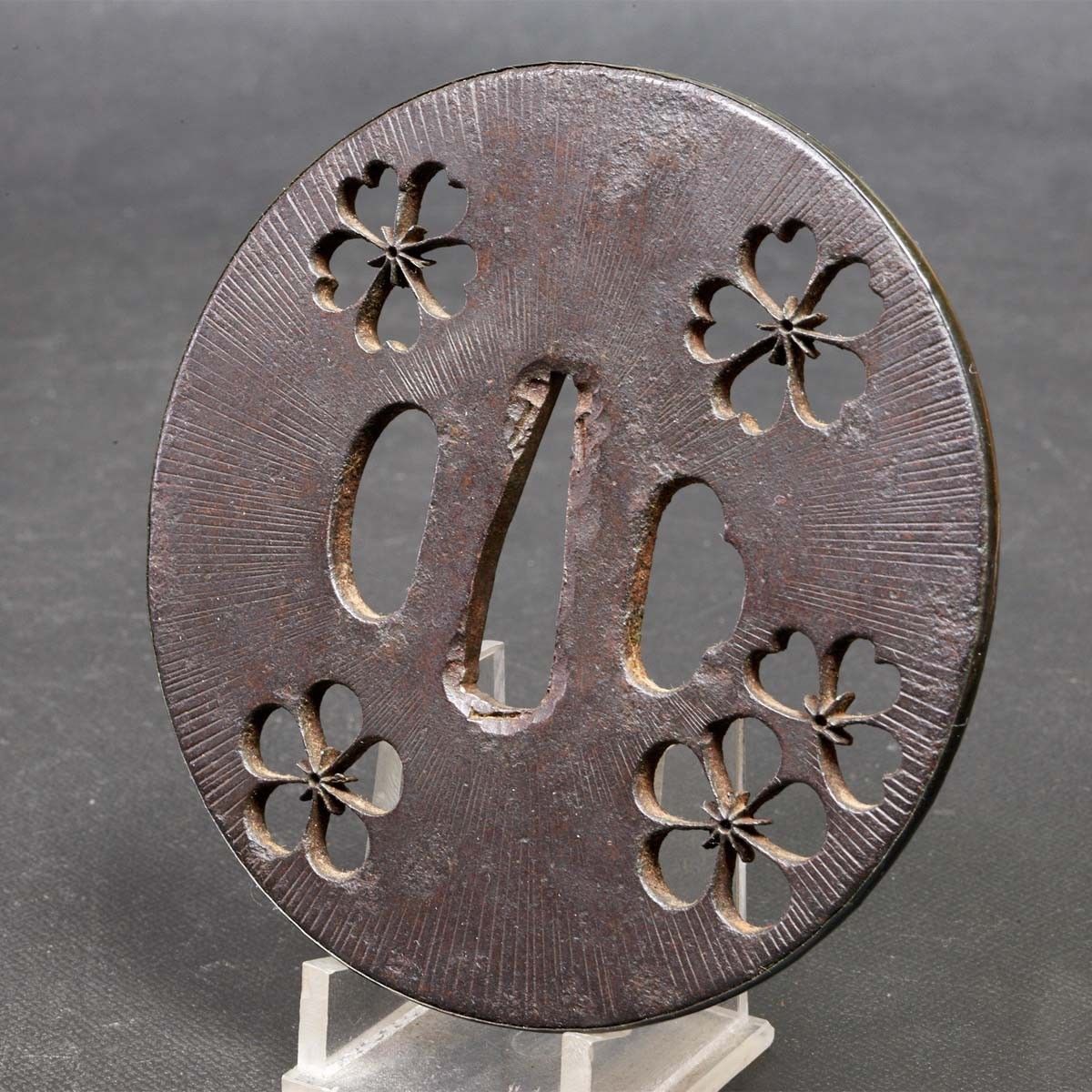

lonely panet Posted May 31, 2018 Report Posted May 31, 2018 was just reading this old post, very interesting. I bought a tsuba simular to the above papered umetada I assumed this tsuba was tosho from the mid Edo but they share similarities Quote
