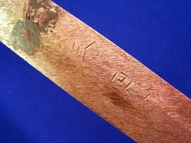

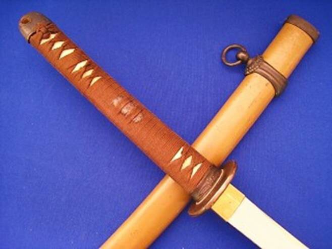

TTyMiller Posted March 6, 2011 Report Posted March 6, 2011 Hello I'm new to the board, learning so much so fast. Can anyone tell me anything about this sword is it real or fake mainly. thank you. Quote
Grey Doffin Posted March 6, 2011 Report Posted March 6, 2011 Hi, name please, This is a real Japanese military sword. The signature is Yoshitada and the date looks to be Showa Ni Ju Nen (1945). There is an oshigata in Fuller & Gregory's A Guide To Showa Swordsmiths, #85, that is a match. Grey Quote

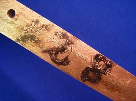

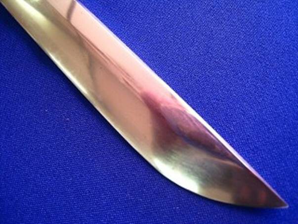

TTyMiller Posted March 6, 2011 Author Report Posted March 6, 2011 Thanks Grey, my name is Terry. Do you have any idea what seems to be dragons represent which first look to me as the number 28? The blade and forgive my ignorance , I still learning the terminology seems to be mint; how ever it is not as sharp as I would have expected. I assume this is a hand made sword by a smith and not machined? It's good to be here! TTyMiller Quote
Brian Posted March 6, 2011 Report Posted March 6, 2011 Terry, The painted numbers are of no real consequence. They are military rack or arsenal markings, nothing to worry about at all. I think this may be a Showato..which means non-traditionally made sword, made by a smith but considered partly machine made. Basically your average wartime sword. I could be wrong, but it seems as such. I think what is giving the impression of a minty blade is actually buffing or overcleaning of the blade at some point. The high gloss finish and rounded edges are indicators of this. Might just be the photos. Anyways, at worst, an example of a genuine wartime Japanese Sword, and at best, a handmade WW2 sword. In hand inspection might be necessary to tell more. Brian Quote
cabowen Posted March 6, 2011 Report Posted March 6, 2011 This is not a traditionally made blade. Oil quenched, probably western steel. Has anyone ever seen a traditionally made blade in these olive green, iron fitting, type 3 mounts? I have seen hundreds of these (maybe more!) and not one has ever contained a traditionally made blade.....One of these was my first sword, purchased when I was 12 years old..... Quote
Bruno Posted March 6, 2011 Report Posted March 6, 2011 I agree with you Chris, it seems all of them are mass produced oil quenched sunobe to(almost all the same except for the mei). But those in semi rought lacquered saya seems to be of much better quality. Quote

TTyMiller Posted March 7, 2011 Author Report Posted March 7, 2011 Yes this is a Type 3, Type 98 had painted wooden scabbards. Chris was that the type you purchased as your first sword at the age of 12? Quote
