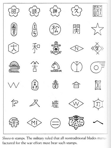

Ed Hicks Posted March 2, 2011 Report Posted March 2, 2011 Yoshichika katana with REALLY Odd Stamp! Okay, someone explain this one to me...I recently acquired a sword made by Yoshichika, a good quality sword with a fine hamon and strong construction...Signed with a deep stamp at the tip of the nakago with what I believe is a helmet and the word WARRIOR in English!!! It resembles Pacman with a Mohawk! Quote

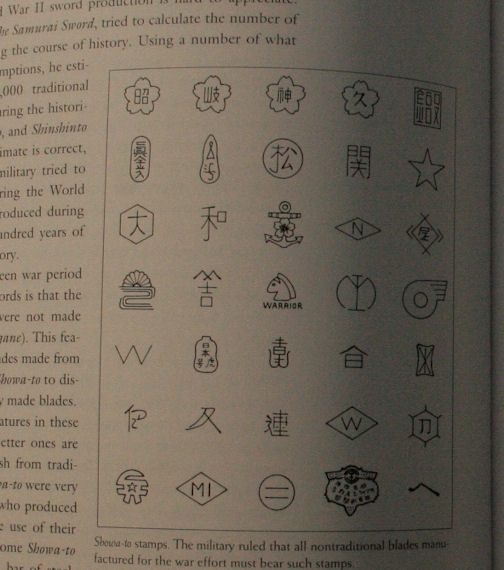

george trotter Posted March 2, 2011 Report Posted March 2, 2011 This stamp is a horses head...it has been noted before. See page 62 of "Modern Jap. Swords & S/smiths" by Kapp & Yoshihara (sorry, can't post it). I think a showato...mei is typical of nakirishi-mei...not gendaito in my opinion. Regards, George. PS...just checked Seki Kaji list Yoshichika...real name Yoshioka Kojiro...started swords Sho 18-04-26. 2 Quote

John A Stuart Posted March 2, 2011 Report Posted March 2, 2011 It certainly looks different now. Being a recessed stamp with english could this sword be post WW II make? From the fifties and made for export? George, I don't have that book, but, is the stamp you mention pictured? I am gobsmacked!! John Quote
Daniel Posted March 2, 2011 Report Posted March 2, 2011 This stamp is pictured on page 227 in Japanese military and civil swords and dirks. I quote what the authors say. Unidentified. Noted only on the reverse of signed, but undated, tangs (one of which had a Seki stamp) by the Showa period smith Shimada Yoshisuke. Probably the logo of a private manufacturer/retail company. Regards Daniel 2 Quote
george trotter Posted March 2, 2011 Report Posted March 2, 2011 Hi John, yes stamp is pictured on page 62 (cute too). If I wasn't such a techno trog and it wasn't 27C temperature at 12.28 am I'd try to post it...someone capable must have this book? I think definitely a WWII stamp...I have seen similar period WWII black lacquer scabbard with leather cover which had paper labels that are in Japanese and English and have a stylish logo. I also think that the pic posted here was "quirky"...one second I'd look at it and it was concave, the next blink and it was convex...just wouldn't stay one or the other...but at last a pic that shows it clearly as a proper concave stamp. The blade IMHO looks reasonable but I think definately showato. Regards Geo. oops, Daniel beat me to it! I see there is more than one Seki kaji using this stamp...must be as stated, a "company" stamp. Quote
Ford Hallam Posted March 2, 2011 Report Posted March 2, 2011 Well that'll teach me not to trust images Yes, clearly a stamped mark. The much referenced illustration from page 62. Quote
