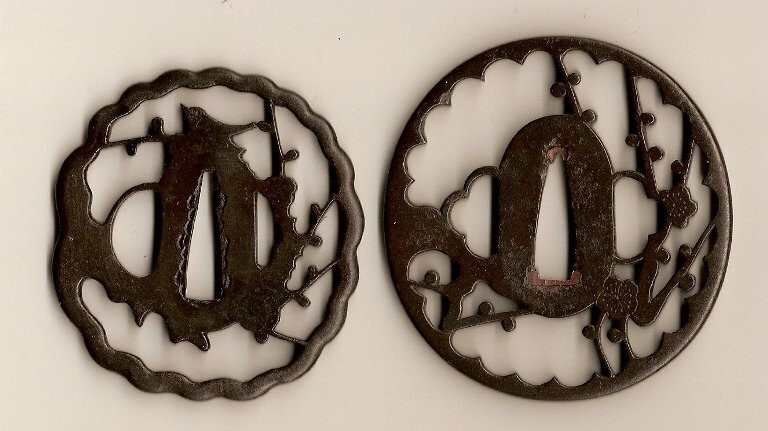

Jean Posted March 1, 2011 Report Posted March 1, 2011 On the same design, 2 tsuba I got from Fine Sword, years ago Quote
