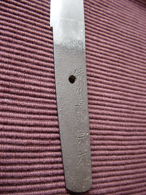

Martin Posted September 2, 2006 Report Posted September 2, 2006 Hi, I bought a koto tanto some time ago that has the following mei (at least that´s what I found out...): Bichu Osafune Munemitsu Could anyone help me in judging this mei? What I want to know is from what exact time it is from and if the mei is authentic. In this context I would also like to know how you can recognize if a mei is authentic or not. Is it the way the chiseling was done or what other hints are there? I have to admit that I am still much a novice regarding nihonto and do not know which books I could consult that would help me to answer my questions. I have got a few books on Japanese Swords (amongst them the "Conaisseurs book of Japanese Swords") but I don´t know if that is the right book to consult in this case. Does anybody have a recommendation of what english language books to buy as a beginning collector of nihonto that really give you profund information on Japanese Swords and their identification. Any help would be highly appreciated. Kind regards, Martin Quote

Darcy Posted September 2, 2006 Report Posted September 2, 2006 What are the measurements of this tanto? In style it does not look like the typical Muromachi shape. You can see an example of that here: http://www.nihonto.ca/yosozamon-sukesada/ The "standard" shape is about 22cm of cutting edge, a longish looking nakago , with obvious uchi sori. You should consider getting it into the hands of someone like Bob Benson, who will tell you if it is worthwhile to submit for papers or not. The following is just my personal opinion and could be wrong. The nakago patina on your tanto also looks almost unnaturally uniform and the sharp line of distinction between the patinated area and fresh steel in the ji looks odd to me does not seem overall to be that old. Note the crisp edge of the mekugiana. A sword that is 500 years old will tend to have these sharp edges and flat surfaces become more organic through the action of time and rust. This is not a hard and fast rule, some are exceedingly well preserved (see below). This tanto though seems to me to be a shinshinto piece. Below: well preserved 720 year old nakago. Even still, imperfections and wear cause sharp lines to become rounded. 500 year old nakago: mekugiana still retain some crispness, but areas of deeper pitting become evident in the nakago, making the surface uneven. Note the organic contour between the patinated nakago and the beginning of the unrusted ji. Compare to the razor sharp line in your tanto. The spray of rust above this line on your piece is the natural process that is beginning to assert itself, and if all of that patina were natural I think that you would not see that black-and-white distinction over that line. Quote

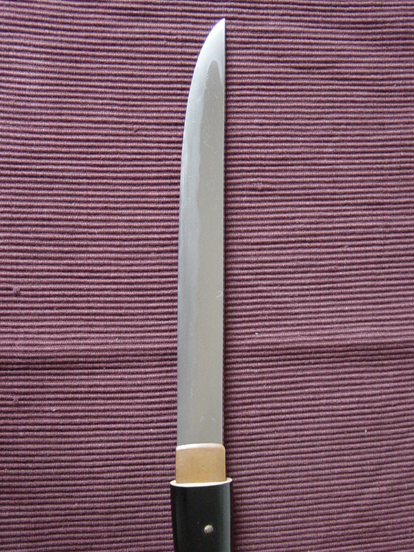

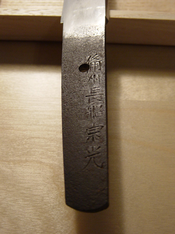

Martin Posted September 3, 2006 Author Report Posted September 3, 2006 Hi, thanks so far for your great effort and informative replies. I´m a bit astonished (and definately disappointed if this would be confirmed) to hear that this piece may not be a koto tanto. Here are some pieces of information that the seller gave to me before the purchase: A KOTO Japanese TANTO BIZEN SCHOOL SIGNEDTOKORU paper dated Showa 32 / August 25th 1957 Late MUROMACHI period 15th / 16th CenturyNAGASA : 240 mm, NAKAGO : 102 mm Actually the patina on the tang as it was discussed seems not to have that distinct border between the unrusted ji and patinated part of the nakago in natural. Maybe the foto was a bit misleading. Furthermore I couldn´t really see the crisp edged impression of the mekugiana. I add another one with this post and try to make a good picture of the whole blade later on that gives a better impression of the sugata. Thanks very much so far and kind regards from germany, Martin Quote

Darcy Posted September 4, 2006 Report Posted September 4, 2006 Hi Martin, The nakago looks older on this picture than on the others, but still there is that impression of a line where the patina stops and then sprays above it. So it nags me that it had a patination job at some point to make it look older. The length is kind of OK for Muromachi, it is a bit long but not too long. The Torokusho is the government registration paper. It is *not* an attribution. There are some people who sell things on ebay and use these as attribution papers and call them government papers or government origami. This is deceptive as they are only a description of the sword to identify it. If the sword had on the nakago it was made by Elvis and Jesus as a joint work by way of a time machine, then this would go on the Torokusho. I had one that said Masamune. That was only because the tanto bore a sumei to Masamune, and so it was dutifully recorded in the torokusho. It means something historically in this case and is useful for analysis, but when it papered to Juyo Token the NBTHK had already instructed the owner to remove the shumei and the tanto passed to Takagi Sadamune. The Torokusho is also supposed to be surrendered when it leaves Japan, as it gets deregistered. There is apparently some loophole that allows them to be preserved, and I don't know what it is. So sometimes some of these slip out, I have owned a couple and I like having them. But I think in the case of people who supply these as origami they may send them out as claimed authentication. Disclaimer: I do deal in swords, and there are some people out there who label things on their auctions that "other dealers may give you bad advice trying to derail my sales." That *does* happen and has happened to me, however *some* people will hide behind that kind of statement in order to deflect any criticism. Sorting out good criticism and bad items vs. bad criticism and good items is something that each person has to do on their own, the best way is by obtaining some degree of experience. So that is what you should aim for and why you should continue to research this tanto to get the best opinion possible. It gives you experience which is valuable even if the mei turns out no good. I would say with your tanto, that the mei is not so good and if I had to choose I would say gimei. From seeing the new picture and knowing the length am not prepared to rule it out as late Muromachi work. Do look at the kasane as I mentioned, and keep studying the piece. Remember the saying about opinions... everyone has one and with swords you will get a lot of varying opinions, some will be right and some wrong, and even very experienced people will make errors. Us more inexperienced people have to recognize our opinions are as likely to be faulty as to be correct. I think for you to satisfy yourself, you need to send this in to the NBTHK to try to get a paper, or else send to someone with a lot of experience who can give you good advice on it. Quote
Henry Wilson Posted September 4, 2006 Report Posted September 4, 2006 I think Darcy has summed it all up. The second pic of the mei looks older but I too think the mei looks slightly odd just by comparing with documented examples. Just my two pennies worth. Quote
