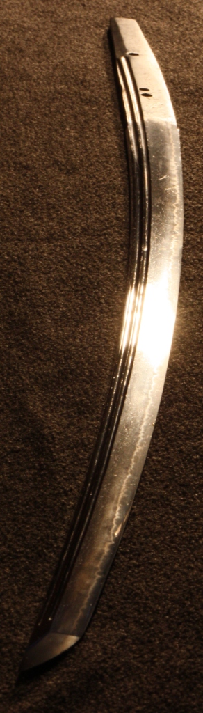

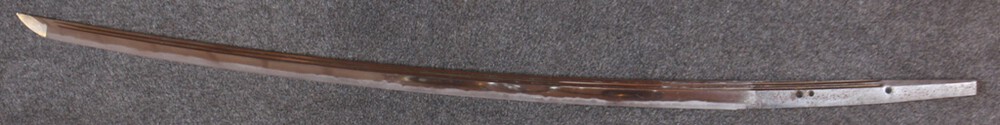

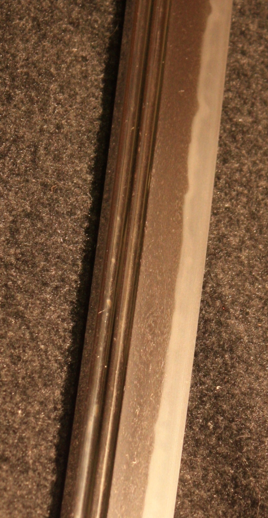

This is the blade that was inside the koshirae with the guribori fuchikashira discussed last week in the tosogu section. It is a somewhat tired blade, but it has a lot of nice details to study. I'll let people make a guess of the tradition and school before I let you know what the old green papers say (not to be 100% trusted)... Nagasa is 69 cm, by the way.
BR, Veli
Well, if we trust what the papers say (den Hidemitsu), this is a Bizen Kozori blade from around late Nambokucho period with workmanship resembling that of Hidemitsu.
BR, Veli
Hi Veli, What makes you think it is nambokucho era Hidemitsu den? Up to the 3rd generation they were respected smiths, fin c.1400 CE. Is the quality of the sword equal to smiths of that period? Whereas the school lasted until Momoyama period, 200 years after the 3rd gen. John
John, let's say that the timing of the blade in Nambokucho period is a working hypothesis, which I am ready to revise, should evidence point to a later date. Bizen Kozori group continued to early Muromachi period, but I haven't heard it reaching to as late a date as Momoyama... The blade's hamon pattern is somewhat subdued compared to mainline Bizen schools, which is one of the characteristics of the Kozori group.
If we assume that the futatsuji-hi ends roughly at the position of the original hamachi, the original nagasa has been up to 85 cm, which is rather long for a (late) Muromachi blade, but typical for Nambokucho blades. Furthermore, if you trace the curvature of the hi instead that of the nakago, you can see that originally the steepest curvature was near the original hamachi. This, I think, also points to a rather early type of sugata. The kissaki is not an O-kissaki, but still somewhat longer than average.
The blade is tired, but still displays a beautiful hada, and very few forging flaws. Also, utsuri can be clearly seen. I would say the workmanship is decent, though I would not call this a masterpiece. I would be thankful if you'd let me know your ideas of the timing of this blade.

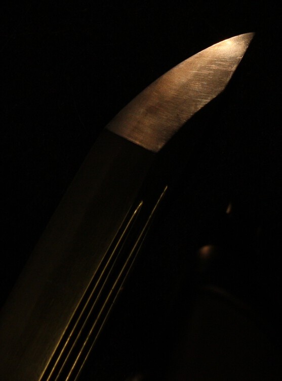

Please take a look at the picture below. There you can see the curvature of the hi being different from the curvature of the nakago.

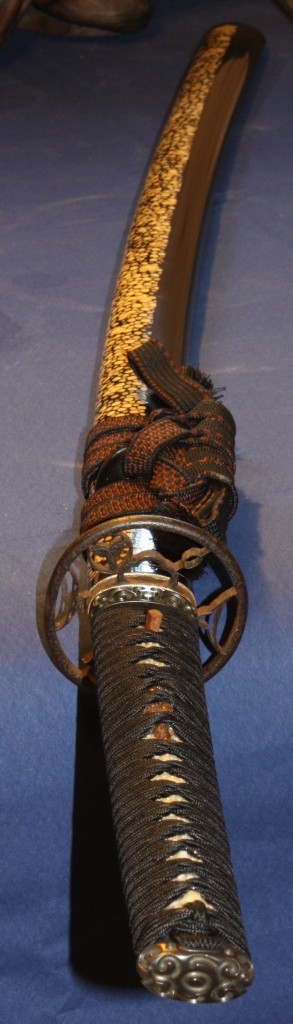

Hello Veli, thank you for the photo of the Menuki and Tsuba. It looks like a nice lion !
I am also very interested in the koshirae which looks from the first photo to be half polished samegawa and half urushi.

I also uploaded a couple of utsuri photos as well as one koshirae photo into flickr.

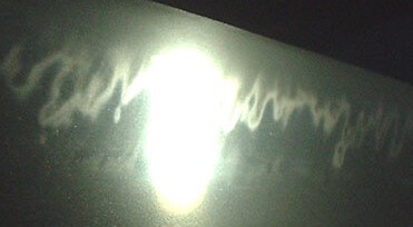

I would love to eyeball this sword myself to see that utsuri. I have read in the Kosa that shingane and kawagane from repeated polishing can create an utsuri image. I haven't seen an example before though. I include a picture of a well drawn chogi utsuri. John
John,
You expressed one of my main concerns about the quality of the utsuri: could it be the type of shirake utsuri encountered in tired blades? Two facts speak against this, however: The utsuri is brightest on the healthiest-looking parts of the blade; furthermore, the utsuri flashes into sight only under lighting conditions that are required to properly see the nioiguchi. In any case the utsuri on my blade is nothing compared to the one illustrated in the drawing you posted.
BR, Veli

I have seen quite a lot of ustsuri as many people on NMB and there is something which gives me an uneasy feeling.
On all the Bizen blades, I have seen, when utsuri exists, it always starts from the shinogi (ridge line) and runs // (whatever the kind of utsuri) to the nioiguchi, sometimes coming very close to the nioiguchi but here it seems to start in the middle of the hiraji and touch the nioiguchi quite often ... It is perhaps, also, a side effect of the picture.
I don't know :doubt:
True, the quality of the utsuri is not at the level I'd wish it to be. However, please see page 50 of Facts and Fundamentals of Japanese Swords by Nakahara!
BR, Veli
Veli,
My problem is that the Utsuri starts in your photo from mid haraji (hada) and not from the shinogi and that it sticks to the habuchi without leaving any place to the hada.
I don't say it does not exist but I have never seen the case. It is perhaps the picture.

Veli, you are thinking the utsuri you see resembles the bo utsuri in the oshigata? You are better able to decide that than us, having the sword right there. Funny, but, bo utsuri is another trait of Oei-Bizen. John
I do agree with Jean in saying that the phenomenon discussed here cannot be the midare utsuri encountered especially in earlier Bizen-to, since that is indeed supposed to start from the shinogi. However, it does have a significant resemblance to the bo-utsuri illustrated by Nakahara. The bo-utsuri (if that is what we see) seems to date this blade to late Nambokucho (Kozori group only) or Oei periods (Oei-Bizen), just as John stated.
BR, Veli
Veli, you take the Nagayama Kokan and you'll see the opposite, Bo utsuri starting from shinogi (p 87)
I would like Ted advice on this topic as he has written an article on utsuri.
Now I have seen quite a lot of blades of Oei Bizen with Bo utsuri, they all started from the shinogi. I have talked to a much more experienced collector than me about it and he agrees with me, he thinks it is perhaps a shirake utsuri.
Hada for Hidemitsu in Bizen mono is referred as mokume or ko mokume, on your picture it looks more like tachi hada
Futatsuji are rarelly seen on Bizen blades (Connoisseurs P 76) except for Chogi.
Just to add concerning futatsuji bi that they are generally associated with Soshu mono, that's why we find them on Soden Bizen (Chogi)

I cannot provide any guarantee - not even to myself - that the utsuri on my blade is proper bo-utsuri and not shirake utsuri arising from tiredness. But to state that all utsuri should reach up to the shinogi... I think this statement needs more research and references than those already discussed.
Futatsuji-hi can be seen at least in the works of Omiya school, too (Connoisseurs p. 184):

As for the hada at the position of the utsuri, please refer to 3rd picture of my 2nd mail "5_hada.jpg".
