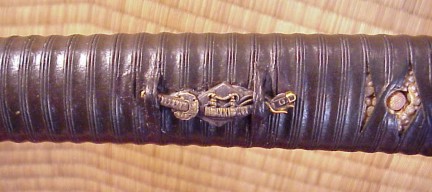

There are many examples of leather bound tsuka dating from both koto and shinto periods. there have been two recently on http://www.nihonto.com one of which had been awarded Juyo status.
Tensho mounted blades often have leather or doe-skin binding over black lacquered same. Tensho mounts were discussed at some length in a previous thread (sorry I cant find it) if you want some illustrations pm me and I can mail some images to you.

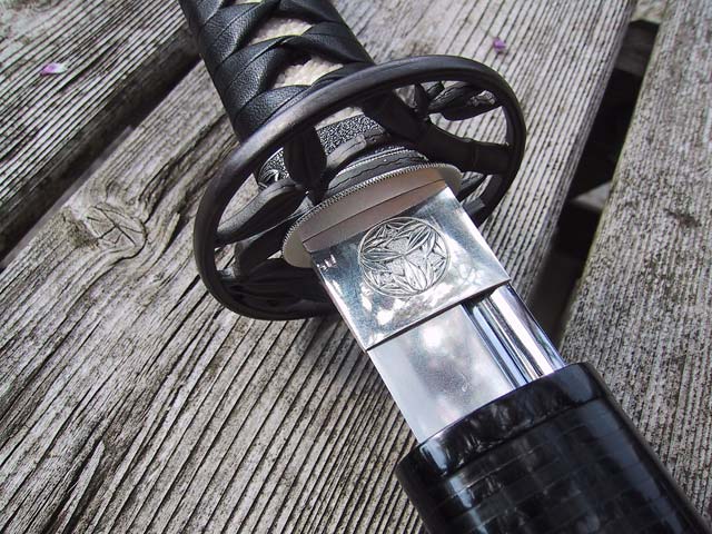

I have had many tsuka wrapped with leather for people and have heard no complaints. Talking to people at tameshigiri get togethers, most preferred leather for the wear and the fact that it tightens up nicely when done correctly. It provides an excellent grip, wet or dry....

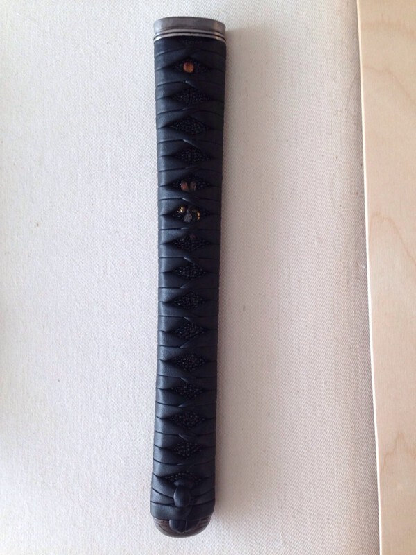

Just received my newly wrapped tsuka in black leather. ¥40000 later I couldn't be more happy! This is for my Okamoto Kazumune Katana which is used for tameshigiri and batto kata.
Cheers
Jeremy
