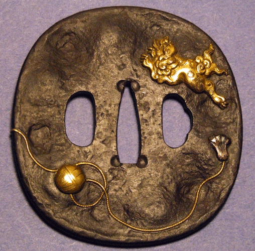

Hi Ray, If this tsuba was made during the bakumatsu or early Meiji periods I think it would look just like this. Not much patina would form as compared to 500 yr old examples. Also if it was kept unmounted and in a drawer, say. John Here is an example of one from the period.

The tsuba in question has in fact been completely stripped of all trace of patina, probably by the use of rust remover. The pewter-like colour is not unpleasant but the piece is now unfinished and vulnerable. If it was a non-ferrous piece I'd suggest Nara school, but as it's iron, I hesitate, Kinai might be a thought. In any case it ought to have a good, solid dark brown, almost black colour with a mid-range sort of gloss. In my opinion the finish on the tsuba John posted is a little suspect, (sorry John, just my feeling, based on the image.)
and with regard to any kind of D.I.Y. quick fix, there are none that are going to deliver the results you should expect. It's a bit like making souffles. You can find the recipes anywhere, but it doesnt mean you can make one to satisfy Gordon Ramsey! :D
regards, Ford
Hey Milt, I reckon he'd prefer "chef" ;)
Mike, you may be right, but then again he's rubbish at carving steel. :D
Kjetilk, I'm always pleased to help clarify these technical matters, thanks for being receptive. We all have to learn from others on this path.
regards all, Ford

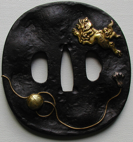

Hi Ford, The pic of the tsuba I posted was done with a scanner. I don't trust the reproduction sometimes, so, I took a new digital photo of it for you to see. I wish to know if the surface seems suspect still. I paid a fair buck on this one and if it is not right, well. The hitsuana have slight rusting and the shiny areas on the inside at the tagane marks that show a short period of mounting. The tassels show some wear to the sivering with a copper sheen coming through, though, the gold overlay seems thick and pristine. Looks good to me and is just over 100 years old but I do not want to be fooled. John
Hi John,
I'm naturally a little reluctant to offer any opinion while claiming to be infallible, particularly when unable to actually hold the item in question. But I will suggest the following;
If you look at the actual texture of the iron, not just the larger overall form of the plate, it strikes me as being rather featureless. I have to ask myself, how was this plate processed, what working methods resulted in this finish? The colour of the patina is also still a little unconvincing in relation to what one would expect on a decent Edo period tsuba. Remember, in the Meiji period there were an awful lot of unemployed metalworkers around, not all of them sword related either. There are many tsuba like objects knocking around, that date from this time, some even very good examples of art metalwork. We face a similar situation today, not every piece of metal with a nakago-ana shaped hole in the middle is a tsuba.
Another thing to wonder about is the fact that the tassles are copper that has been plated. At the time we assume this was made silver was'nt all that expensive so why resort to plating? This is often a giveaway as far as I'm concerned. You should carefully examine the Shishi too, to see if you can discern any wear, as it is also undoubtably plated. When I say plated in this context I am not refering to older methods of fire or mercury gilding but to modern electro-plating.
I'm sorry to be so blunt but I genuinely think that it is in everyone's best interests to be aware of the varieties of "tsuba" that are on offer and what they really represent. In this field we should always remember that real beauty is more than skin deep.
I hope my comments are recieved in the spirit they are offered and that they are of some use in helping to evaluate later pieces.
regards, Ford
