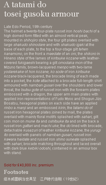

estcrh Posted December 10, 2012 Author Report Posted December 10, 2012 Here is a description of this armor from a leading auction house, notice what information is missing, they never mention kikko, Myochin, or kaga, and when they use Japanese terms there is no English equivalent added for people who do not understand the Japanese term, I think they need to hire Ian to write their descriptions...and check out that sales price. Quote

uwe Posted December 10, 2012 Report Posted December 10, 2012 Ian, I was afraid that it turns out this way :? I`ve read they were horse-bit makers in earlier times.........Those Myochin were excellent "tradesman" I had to be more careful about such early publications. Thanks a lot! Eric, I think this kind of description is with intent and quite common for auction houses. Incidentally, the asking price is "formidable" Uwe Quote
