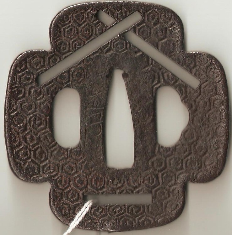

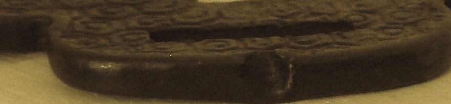

Soshin Posted December 29, 2010 Report Posted December 29, 2010 Hello Translation Assistance Forum, This is my first post of this forum on the Nihonto Message Board. I have what I think is a Momoyama period Myochin tsuba that that has a mei that is difficult to read. This I find is often the case with Momoyama tsuba that are signed. The tsuba was once owned by Skip Holbrook that I purchased on the message board. Skip's notes state the following: Quote Myochin, signed Nobuiye, crossed staffs & turtle shell kokuin, Momoyama, iron insert on kozuka hitsu-ana Well I agree about the school and time period comparing it to other works with shinsa papers but as for the mei I don't think it is signed Nobuiye (信家). From what I can determine as I often help people with translations is that the first Kanji is Kane (金) the second Kanji I am not sure on. This second Kanji character might be stylized in some way making it hard to read. This is why I am posting scans of the tsuba which clearly displays the mei. If you need me to post some higher resolution scans or photos of mei please let me know. I would just like the translation for my own research notes as I really like the tsuba and will not be selling anytime soon. Thank you so much for you help. Yours truly, David S. Quote
reinhard Posted December 29, 2010 Report Posted December 29, 2010 David, NOBUIYE is probably the wrong track here. Design is reminding of NOBUIYE-work, but the mei is definitely not "NOBUIYE". Assuming you're right with the first kanji being "KANE" (I can't tell for sure from the picture) and assuming that the second kanji is most probably "KO" (meaning "child", "son", "daughter") you end up with the common family name of Kaneko. There was a line of Kinko in Choshu province by this name. It is somewhat unusual to find the family name only for a mei. It is as if a member of the Goto family had signed his work with "Goto" only. However there's not much I could find about the Kaneko-Ke. This is what the Kinko Meikan says: regards reinhard Quote
Soshin Posted December 30, 2010 Author Report Posted December 30, 2010 Hi Reinhard, Thanks for the information. Here is a higher resolution photograph of the tsuba under normal light. The mei is I think a little easier to read in the photograph. I was generally agreeing with Skip's attribution to the Myochin school based upon the kokuin, placement of ko-sukashi above and below the seppa-dai, the very dark blackish brown color of the patina, and the shape of the mimi. The thickness is also characteristic of a earlier Myochin at 0.3 cm at the seppa-dai and 0.4 cm at mimi. Later Myochin tsuba of the middle to late Edo period would be much thicker. I wouldn't describe this tsuba as being Choshu like. Does anyone know of a Myochin armor maker using the Kaneko (金子) name around the Momoyama or early Edo periods who also made tsuba? Or any Myochin armor makers that would use the Kane (金) as the first kanji in their name? Thanks again for all the help. Yours truly, David S. Quote

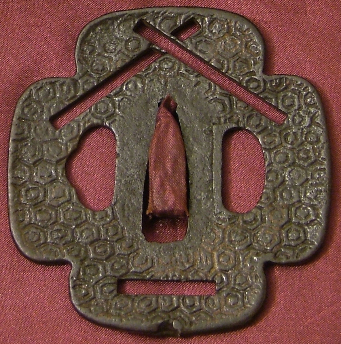

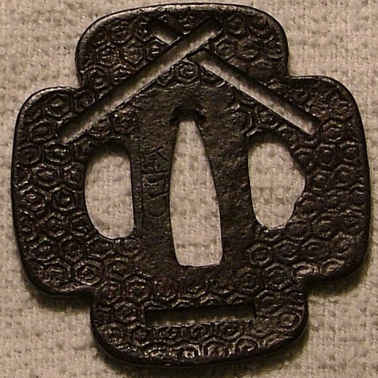

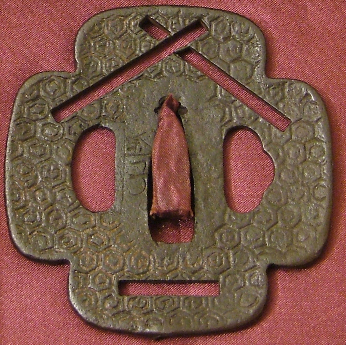

Steve Waszak Posted December 31, 2010 Report Posted December 31, 2010 David, Could you provide some further information on this tsuba? Dimensions would be useful, and I'd like to see some more images, taken obliquely, of the mimi as well as of the sukashi openings and of the nakago-ana. I am inclined to agree with Christian on his assessment of this tsuba as being a late-Edo "homage-to-early Myochin/Nobuiye" work, but the information/images I'm requesting here would be helpful in making such a determination. Some things to keep in mind, though, are that Momoyama-era Myochin tsuba are never signed (to my knowledge), and that the kikko design used here is one that Nobuiye popularized (but that the early Myochin, again, to my knowledge, did not use). However, the late-Edo/Bakumatsu tsubako often made "homage" pieces, frequently finding inspiration in the powerful works of the Momoyama period. Two of the most well-known of these tsubako were the Norisuke of Owari. I believe this is who Christian had in mind when he mentioned the Futogayama. Both of these Norisuke tsubako were active well into the mid-19th century. One of their characteristics was to exaggerate the attributes (such as tekkotsu) of those tsubako whose work they were "copying." The results often come off as a bit "unnatural" when compared to the real deal. As to the "mei" or whatever the characters might be, if you are correct that they somehow connect to an owner of the guard, this seems to me to be something one would find more in a 19th-century sensibility than in a 17th-century sensibility. If this is a Myochin work, it should be noted, too, that by the 18th century, Myochin guards are almost always signed. With a name so illustrious, it would not make much marketing sense for Myochin tsubako to complete their pieces without a proper mei (the great majority of which will have some variant of "Mune" in the mei). Cheers, Steve Quote
Soshin Posted December 31, 2010 Author Report Posted December 31, 2010 Hi Steve, Here are some new photos of the tsuba that I hope are a little better and more helpful for identification. The mei is also clearest in the photo of the Omote side. Two photos are along different parts of the mimi. Thank you for clarifying what I think Christian had in mind. The tsuba has the following measurements: 7.0 ✕ 6.8 ✕ 0.30 cm (mimi = 0.40 cm). The Owari Sukashi school only lasted until the middle Edo period but both generations of Norisuke based in Owari produced tsuba during the late Edo that were high quality for the time period. I know that at the 小道具の世界 – Kodôgu no Sekai blog http://kodogunosekai.com/ Rich highlighted a tsuba by the second generation Norisuke that is wonderful. Let me know if anyone needs any more information. Thanks again. Yours truly, David S. Quote

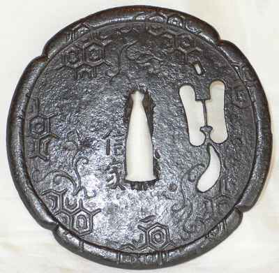

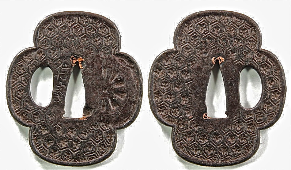

Steve Waszak Posted December 31, 2010 Report Posted December 31, 2010 Hi David, Here are a couple of photos that may interest you. The first photo here is of an "Owari Nobuie" tsuba. These really are quite different in many ways from the two Momoyama Nobuiye masters... The second photo is of a small Nobuiye work; the mei is "hanare-mei," the signature recognized by most authorities as the "first generation" Nobuiye of the late-Muromachi and Momoyama periods. Cheers, Steve Quote
Soshin Posted December 31, 2010 Author Report Posted December 31, 2010 Thanks for the comparison between the Owari Nobuie and a original Nobuie from the late Muromachi or Momoyama periods Steve. Having similar motifs in all three tsuba is very helpful. I would say that while my tsuba is not to the level of craftsmanship (specifically the mokko-gata form) of the original Nobuie I would say that my tsuba is closer then the Owari Nobuie example provided. I am drawing this conclusion based upon comparing the turtle shell kokuin design found in all three tsuba. My tsuba turtle shell kokuin on the Ji (surface) of the tsuba has a similar delicate melted appearance similar to the original Nobuie more so then the Owari Nobuie example. Yours truly, David S. Quote
