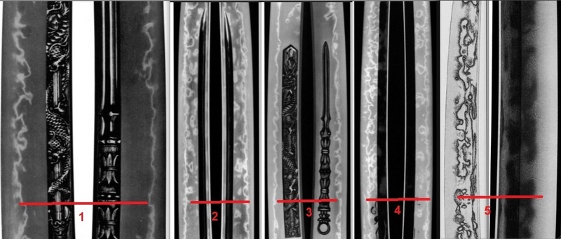

reinhard Posted December 14, 2010 Report Posted December 14, 2010 Reinhard, show me some swords and I will pick the good ones for you. :D and I'll try not to be sanctimonious. David, I can't show you any swords online, which is in the nature of NihonTo. By asking for it you are outing yourself (once more). Nevertheless I'd like to add some spice to a otherwise repetitive discussion. You see five close-ups of swords here. Tell us which one is the "good sword", and most important, tell us why. The rest of the bunch is invited to comment, of course. reinhard Quote

Lee Bray Posted December 14, 2010 Report Posted December 14, 2010 My guess would be the middle sword based on my opinion that it has the clearest, most consistent nioi-guchi. Quote
Muki Posted December 14, 2010 Report Posted December 14, 2010 Reinhard, may I take a stab at this (pun intended) :lol: Of the swords you posted I like the 2nd and the fifth. The reasons why? I like the way they looked. I dont like engravings very much personally. I like the character of the blades as you have them pictured. If something is to be appreciated as art it doesnt require one to go looking for a name on the piece. Art is for the appreciation of the one who experiences what they see or feel. If that person likes a particular sword then that is the best sword at that time in comparison to what other swords that person has experienced. To pursue names or physical properties isnt appreciation of art, its systematically analyzing a sword as a potential investment or status symbol. Well, thats how I see it anyhow. If I like the way a piece of art makes me feel then thats what I am interesting in buying. Now, the price may be too high for me to afford because of particular qualifiers based on the investment crowd in the "Japanese Art Sword" population and that's the reality of the evolution of sword collecting. Of course, I am probably wrong but thats an opinion too. Quote
Jacques Posted December 14, 2010 Report Posted December 14, 2010 Hi, I think this kind of asking is a little bit ridiculous, it is impossible (IMHO) to say something about these blades, based on one picture which shows partially the swords. I would also add "a good sword" is not in my opinion an adequate word. All swords able to kill properly are good swords, a few of them can be called art object. Quote
estcrh Posted December 14, 2010 Report Posted December 14, 2010 Reinhard has indicated many times that certain aspects of high level swords can not be viewed through pictures and have to be seen in hand and even then with out the proper knowledge you may not understand the significance of what can be seen. Quote
Guido Posted December 14, 2010 Report Posted December 14, 2010 Sword in hand is of course always the way to go, but I think the pictures show enough detail to comfortably Kantei them as Sôshû school blades. 1, 3, 4 & 5 are Nioi-based and therefore Sue-Sôshû. 1, 3 & 5 = Takahiro, Tsunamune or Fusamune 4 = Hiromasa? 2 is more "classic" with lots of Nie and other activities, i.e. Nambokuchô period. Maybe Akihiro, but more likely Hiromitsu. That's as far as I can go based on my impression of the photos (the Oshigata might be a little misleading and doesn't correspond well enough with the pic). If we define a "good" sword as one of artistic merit, i.e. an "art sword", then all five are "good swords". Personally I would pick # 2 as the best of them. Disclaimer: If I was off in my Kantei, I hereby retract my above statements and announce that it's impossible to judge swords from photos or Oshigata. Quote
Brian Posted December 14, 2010 Report Posted December 14, 2010 Guido...nice one. Yep..Soshu den, and all "good swords" Good may be subjective, but in this case it would be obvious that good swords would be swords considered worthy of preservation, and in most cases.. of a higher level than that. Ignoring the horimono, which wouldn't usually be done on terrible swords, you can tell these have had a high level polish too..which tells a lot. I am not versed enough to attempt kantei on these, but the usual high level Soshu den smiths are represented imho. Brian Quote
sanjuro Posted December 14, 2010 Report Posted December 14, 2010 Whilst I would not even attempt a serious kantei of these blades, firstly because I'm just not good enough to get a great deal of real detail out of photographs. Secondly because I like Soshu blades so much I'm just in hog heaven with the pics. Quite frankly I'd give a home to any of them. Do I see a Masamune blade there? Quote
Markus Posted December 14, 2010 Report Posted December 14, 2010 2 is more "classic" with lots of Nie and other activities, i.e. Nambokuchô period. Maybe Akihiro, but more likely Hiromitsu. I´m leaning out of the window and say the opposite, i.e. rather Akihiro than Hiromitsu, just because I have the strange imagination that a narrowing of the hamon towards the habakimoto is more common for Akihiro. On the basis of these small details, I would pick blade 2 or 4. Quote

reinhard Posted December 15, 2010 Report Posted December 15, 2010 Thank you for joining me in this little game, my friends. Apart from the fact there is no substitute for real blade-in-hand kantei, there was very little material to judge from. You did quite well. Congrats. Apart from creating a little fun eventually, I've picked these examples for a reason. They are supposed to promote a reasonable discussion about "good swords" and what makes them. These swords are (from left to right): - Katana (2/1/7), ubu, mumei, attributed to Soshu FUSAMUNE (later Muromachi period) It is published in "Meito Zukan" by the Fujishiro's, vol.11. They are saying that ji and ha are very well made. The horimono was made before the edge was hardened and horimono is of very high quality. However, there are many nioi-gire and this is probably the reason why this blade was left unsigned. According to Fujishiro's comments, nioi-gire has no effect on wether the sword is practical for fighting. Judging by its overall qualities, it was commissioned by a high ranking samurai. - Tanto/Ko-Wakizashi (1 shaku), mei: "Sagami (no) Kuni Junin HIROMITSU" with nengo: "Koan ni nen 10 gatsu hi" (1362). This is the highlight and the most precious jewel in this assembly. - Wakizashi (1/6/9), mei: KAGEFUSA (sashi-omote) FUSAMUNE (sashi-ura) This is a very rare ga-saku (joint work) by FUSAMUNE and KAGEFUSA, dating from around Eisho era. According to Fujishiro's comments, it is well made. - Wakizashi (1/5/8), mei: Soshu (no) Ju HIROMASA" A well made wakizashi, typical for this school, and with a nice horimono. It is dating from around Bunmei era. - Katana (2/3), mei: "Taira (no) SADAMORI" It was made around Tembun era in Bungo province. A nice and healthy sword. Now: What is a good sword? BTW I also intended to provide you with some mind-food about yubashiri, hitatsura, tobiyaki, shimaba and the like. There's another thread going on about this very subject. It might be interesting to know that hitatsura in Sue-Soshu style was developped out of the strong yubashiri of earlier top Soshu masters. These later approaches went over the top though, and Sue-Soshu's works are not considered nearly equal to those of their famous idols in Kamakura. HIROMITSU and AKIHIRO are supposed to be a kind of link between the outstanding qualitiies of old Soshu masters and slightly superficial Sue-Soshu style. To find out the reasons why, amongst many other questions concerning NihonTo, is one of the most fascinating roads you can go in life. It will lead you to encounters with most interesting people and lead you to great places you have never dreamt of. On the other hand you are free to insist your tired and worn ShinGunTo is still fit for "warrior's use" (as it was when it was used for decapitating POWs). Your choice. Thanks reinhard Quote

Muki Posted December 15, 2010 Report Posted December 15, 2010 Reinhard, Thank you for the posting of the 5 swords and then following up with the information as you did. Seeing the photos and then the conclusions is of great interest. Thanks! Quote
paulb Posted December 15, 2010 Report Posted December 15, 2010 Thank you reinhard for an interesting addition to the thread. Looking at your examples brought another point to mind. Just because it is a good sword it doesnt mean you have to like it. I confess that I do not generally like Soshu swords, especially later ones. Although I do not dispute the technical quaity and workmanship in their manufature I just find them aesthetically unattractive. Basically they are too loud and "blousy". Having said that I have also seen in hand swords by some of my favourite smiths such as Rai Kunitoshi that have left me totally flat, they had as much to see as a yard of pump water. The point I think I am getting to is that what makes a good sword is the material, the way it is worked and the way all the elelments come together. This can be achieved in a miriad of ways. However the resultant product will and cannot appeal to all and no matter how deep one studies the subject and how much one understands the workmanship and skill employed in the process one wont necessarily like the end result. Thankfully we are all different and such variation in taste, preference and choice is what has created the range of styles we see today. BTW if offered a Soshu blade of the quality illustrated I am sure I would not let my prinicipals stand in the way of me accepting it regards Paul Quote
