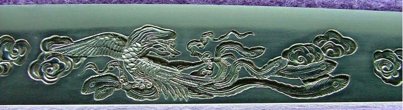

lawlord Posted December 3, 2010 Report Posted December 3, 2010 Hello, guys! Please have a look at this tanto which is said to be made by Kurihara (Akihide) Hikosaburo with horimono by his disciple Abe Akitada. Any comments and opinions are welcome! Yury Quote

lawlord Posted December 4, 2010 Author Report Posted December 4, 2010 Can you please comment on the horimono symbolic meaning? Is it a Hoo bird, and is true that by tradition not every master was allowed to picture it? Regards, Yury Quote
cabowen Posted December 4, 2010 Report Posted December 4, 2010 Yes, I think it is a Hoo bird (Japanese phoenix). Google is your friend. There is a lot of info available. No rules about what could or couldn't be used for horimono subject matter, just tradition. The Hoo bird is rarely seen on swords. Akihide/Akitada made many tanto with unusual and elaborate horimono. Quote

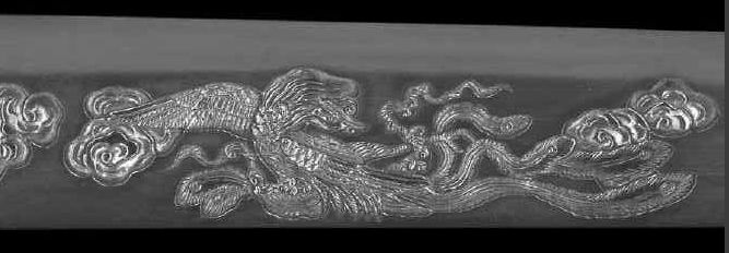

Marius Posted December 6, 2010 Report Posted December 6, 2010 lawlord said: Hello, guys!Please have a look at this tanto which is said to be made by Kurihara (Akihide) Hikosaburo with horimono by his disciple Abe Akitada. Any comments and opinions are welcome! Yury, I am sorry, but the horimono is just awful. No precision in the carving whatsoever, and the composition is a mess. And, sorry to say that, this does not seem to be just a bad photograph Sorry for being so blunt, but this is how I see it... Quote
Eric H Posted December 6, 2010 Report Posted December 6, 2010 To give justice to Abe Akitada's skill :lol: Eric Quote
Grey Doffin Posted December 6, 2010 Report Posted December 6, 2010 I'm with Mariusz on this one; this is clumsy at best horimono. Grey Quote

b.hennick Posted December 7, 2010 Report Posted December 7, 2010 Grey Doffin said: I'm with Mariusz on this one; this is clumsy at best horimono.Grey I thought that it was just me in thinking that this is a terrible horimono. I was going to say nothing as the saying "If you have nothing good to say then say nothing." But I just want to agree with Grey. Quote
sanjuro Posted December 7, 2010 Report Posted December 7, 2010 I hate to be negative but this blade illustrates quite well, the fact that a less than well done horimono can turn an otherwise desirable blade into something less than desirable. Is it likely as it would seem, that this horimono was added somewhat later than the original finishing of this blade in order to tart it up for a non samurai owner, or to hide some defect that had become apparent? I have a natural suspicion of all horimono and badly executed ones even moreso. Quote

Satsuma Posted December 7, 2010 Report Posted December 7, 2010 I think its quite charming. One must not forget that Akihide had Kasama Shigetsugu train these students and were amateurs and fresh off the boat. I would not knock it or him for this. This sword was made during the war by a twenty year old something.......not at all a bad effort. James Quote
Eric H Posted December 7, 2010 Report Posted December 7, 2010 Kurihara Akihide, known as Kurihara Hikosaburo was born at Sano in Tochigi pref. in 1879. He learned under Inagaki Masanori the Second and Horii Taneaki clan. Akihide established Nihon-to Tanren Denshusho at Akasaka in Tokyo and made efforts to train modern swordsmiths 50 strong include Amada Akitsugu, Akimoto Akitomo and Miyairi Akihira. Akihide also went into politics as a member of the House of Representatives for Tochigi Pref. He passed away in 1954, aged 76. The pictured horimonos are the same of the Akihide blade. I agree the upper one is a irritating photograph whereas the other displays the details very well. To judge it as „clumsy, horrible, badly executed“ is most surprising... well to each his opinion. Abe Akitada of Sanjo city wasn‘t a disciple of Akihide, he was an engraver as far as I have detected. The Tanto was made for celebration of the imperial year 2601 (1941). Eric Quote
