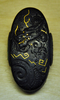

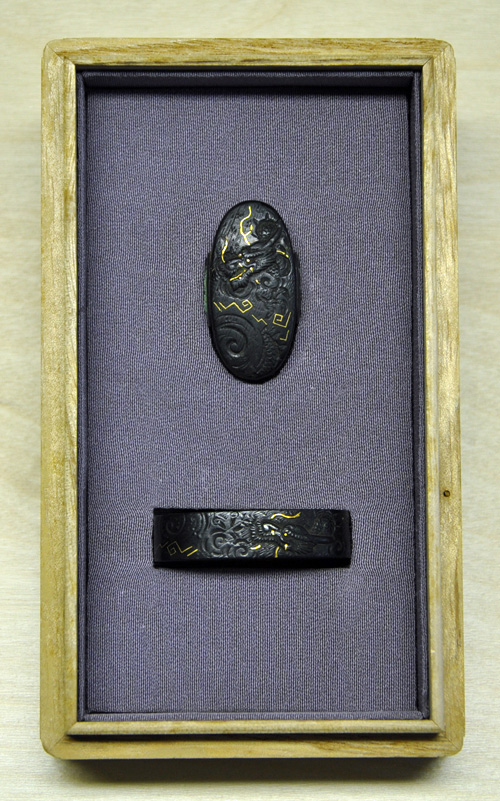

I recently bought this fuchi kashira, is done in very black shakudo of good quality and is signed "Seijo"
I have some questions:
- The signature of an autonomous artist or is a signature of a school?
- The signature is genuine?
thanks
Sergio

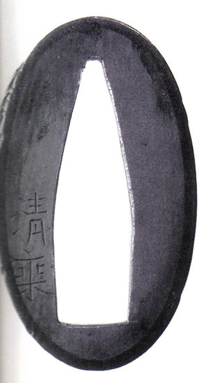

There was a family of Goto artists of the Seijo name using these kanji. 清乗 Known as the Shitaya Goto. There were 7 masters, maybe 8, but, questioned. Haynes mentions that most late work is by this 8th master? although the mei is signed Goto Seijo. These are a good set, but, I believe the mei is spurious. I have seen a few Seijo mei and none are written thus. There is a few generations, but, they do show similarities in signatures after one another. John
This is from Wakayama, pg. 191:
Haynes pg. 1610 has him as the second son of Goto Ryujo and founder of the Edo Goto Seijo school. Work is rare. The mei looks off to me, possibly gimei. If in doubt submit for shinsa. In any case they are quite nice. I like them.

The style of the fuchi kashira is exellent, much better than the pictures show.

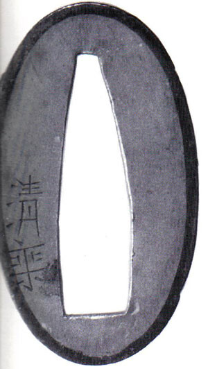

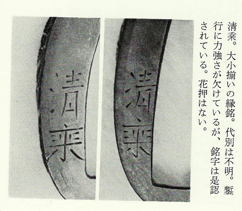

I went through all the example mei I have, shodai to nanadai, and then the Seijo that is speculative. All the 7 masters signed with Goto and various other script, but, no nijimei. This 8th? Seijo signed like the signature we see in your fuchigashira, as well he used sosho at times and occasionally Goto Seijo. None seem to have a kao for this 8th Seijo. 2 examples. Stroke order here is the deciding factor, I think. John
Thanks John,
The last two mei look very similar to my mei fuchi! but got confused, it will be the first generation or the eighth?

Until John posted those reference mei, I would have assumed the signature was gimei.
John, what text did you use to research the Seijo mei variations?
I remember trying to verify a Seijo signature years ago, but not having the necessary reference texts at the time.

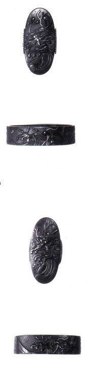

Incidentally I have seen a very nice fuchi kashira matching well one of the examples you posted. The f/k has a Yoshioka signature that doesn't look quite right and may have been added later. Interesting to see its twin as a reference example of late Seijo line work.
Hi Curran, The Studies in Kyo-Goto book. It really is helpful for the waki groups. This artist has a signature so different from the whole Seijo line that it forced me to the books. I thought the same thing too. John
