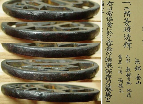

Every now and again in the discussions here, the phrase "good bones" crops up. What exactly does this mean? How do you check to see if your tsuba's bones are good or not? If a tsuba has "bad bones" is there a way to fix it?
Just trying to keep on learning.
peace.
Tekkotsu or bones are the result of the forging process. They are nodules of different steel composition in non-homogenous steel. When tamahagane is folded it homogenises the steel grades so that the carbon content becomes consistent through-out. Tsuba not requiring such a consistent homogeneity does not require such multiple folding and welding. This allows the different steels to be visible, esp. at the edges. This has become a desirable feature and a way of determining the type of tsuba. There are good bones in that they are abundant and/or easily seen, but, there aren't bad bones in the other sense. John
Can someone elaborate? I see rough spots and dimples, etc...but I still don't understand exactly what "good bones" refers to on the example picture. Maybe if someone can highlight the areas it will help.

The presence of "iron bones" the Japanese term is tekkotsu (鉄骨) was one of the deciding factor for me to acquire the tsuba for my collection. The first three generations of the Yamakichibei all had good tekkotsu. I am also leaning towards more tosho or kakushi style tsuba for my collection. I will give Gery half permission as posting photo of the tsuba was for educational and not commercial reasons.

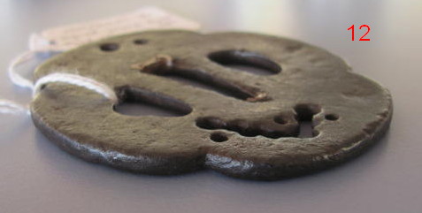

The appearance of tekkotsu is, I believe, correctly regarded as evidence of the method by which the steel was processed and the qualities of the raw material that was utilised.
As part of my own research into this subject I've been speaking at length with Sumihira Manabe and Pierre Nadeau about this. Manabe San is well known for his somewhat controversial ( in some circles anyway ) views on early steel production. He maintains that older swords that exhibit such striking differences in steel quality are impossible to replicate using the sort of standardised material that is being supplied by the NBTHK. It's this lack of character that has lead many of the leading smiths to begin making their own steel. The DIY approach is yielding some very promising results and a far better and more intimate appreciation of the material among those who make it.
Anyway, I asked Pierre to select some particular pieces of raw, second grade tamahagane and to work them only as much as was needed to create a single plate of steel without any obvious cracks or other unwelded areas. He tells me this was possible in only 4 folds and that from what he can see the slag has been pretty much eliminated. You can hear the blanks ring here.
By limiting the folding process to the bare minimum the material may remain sufficiently unhomogeneous so as to exhibit the same sorts of lumpiness that older guards show once subjected to certain finished processes.... which remain to be established :?
From what I understand though the NBTHK tatara steel is reasonably consistent stuff and large variations in carbon content are not seen in individual pieces of the sorts of sizes one would think would be used to produce a tsuba blank. It may be a matter, as some have suggested, of smaller lumps of higher carbon tamahagane being working in between larger plates of much lower carbon steel....I'll try all the options :D
I'm expecting delivery of 2 of these plates this week. I'll be sure to report on the results of our experiments and any successful replication of iron bones will be seen here first.

As I recall, he made the point that the bones tend to be on the lower left of these guards as you face the front, since that is the region that comes in most contact with the kimono for a right handed samurai.
This would beg the question, how were all the tekkotsu on the face of Kanayama guards rubbed into prominence and how do we explain the lumps where it's clear the tsuba didn't rub against the hakama. I'm sorry but this notion simply doesn't stand up to even superficial scrutiny. To allow that it may be a possibility requires far too many other aspects to be ignored as inconvenient.
