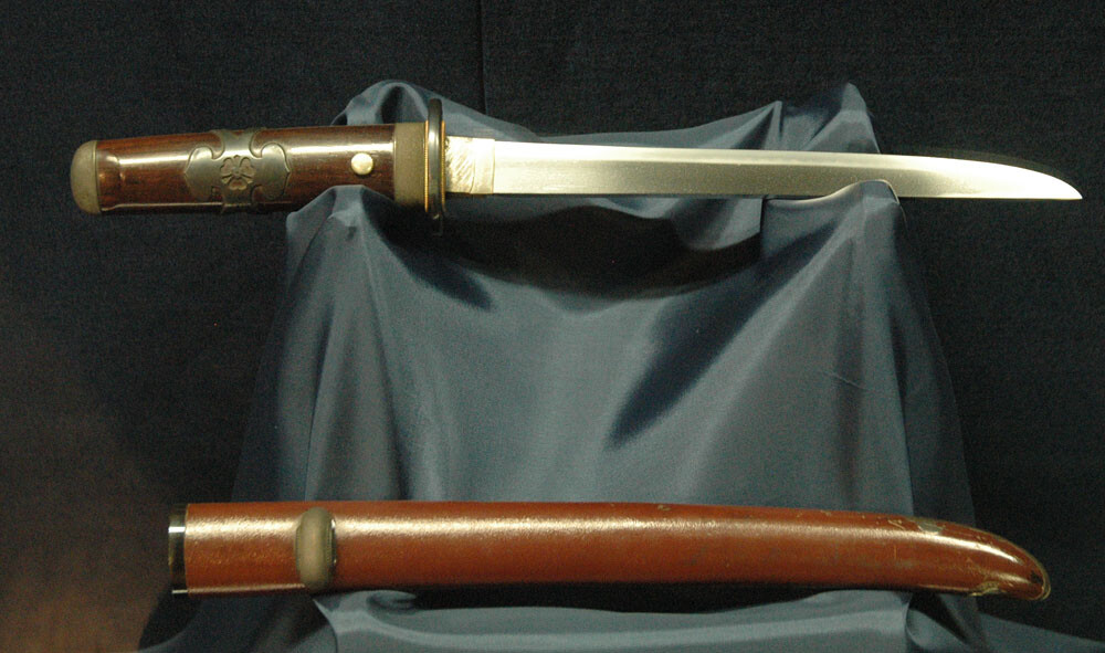

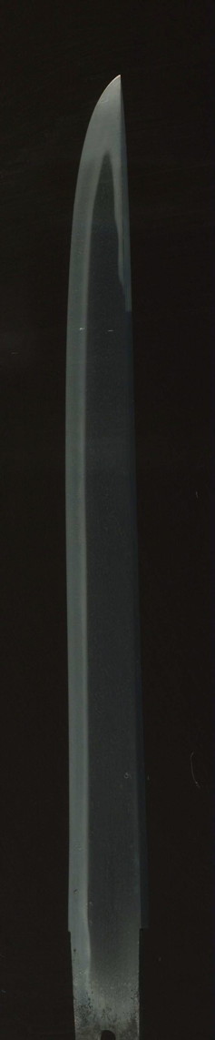

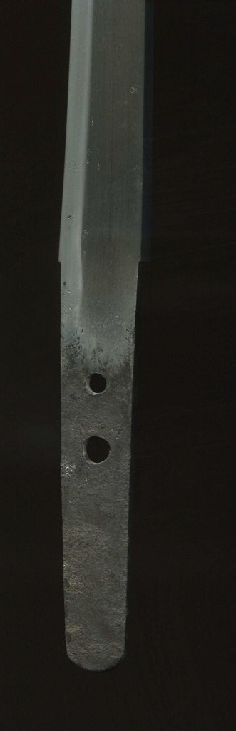

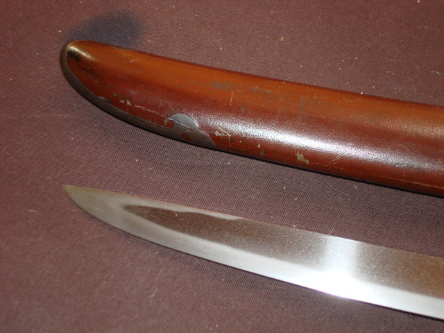

Marius Posted November 18, 2010 Report Posted November 18, 2010 Dear All, I have gone recently through my shrinking nihonto collection (I am moving more into tsuba and need funds to fuel my lust for early Owari), and I have found an interesting tanto (in Higo koshirae). I don't quite know what to make of it. The blade is a hira-zukuri takenoko-zori shape tanto. The forging is tight ko-itame/ko-mokume, hamon is suguha made of bright ko-nie with regular, short ashi. I think I can see bo-utsuri, and it is more visible in the area closer to the hamachi. The tanto seems to have been polished quite a few times, still rather thick, with a ~1/4" (6mm) moto-gasane. At the rsik of making a complete fool of myself, I would say (or my gut-feel would) that this tanto is a: Sue-Bizen Nagasa: 8 7/8" (22.55 cm) width 7/8" (2,23 mm) motogasane ~1/4" (~6mm) sorry for the pics, if the sword is interesting for you and any more are needed, I'll take them with great pleasure. Quote
cabowen Posted November 18, 2010 Report Posted November 18, 2010 I think your guess is a good one...I would go a step further and say maybe Kiyomitsu would be a place to look further.... Quote
Marius Posted November 19, 2010 Author Report Posted November 19, 2010 I think your guess is a good one...I would go a step further and say maybe Kiyomitsu would be a place to look further.... Chris, many thanks Anybody else to agree/disagree? I should have posted better pics, I know, but I don't have them at the moment... Quote
Jean Posted November 19, 2010 Report Posted November 19, 2010 Same as Chris, just add Sukesada and Tadamitsu in the list Quote
Eric H Posted November 19, 2010 Report Posted November 19, 2010 further: Bizen... Katsumitsu Munemitsu Norimitsu Tadayuki Eric Quote
