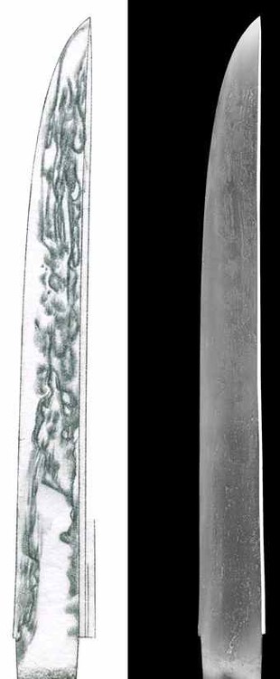

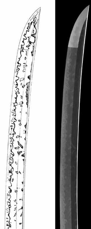

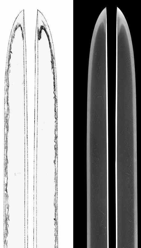

Eric H Posted November 20, 2010 Report Posted November 20, 2010 Anthony said: As per the photography, as I stated... I love viewing great pictures of blades. Yet there is something different about viewing a hand-drawn illustration I have always been fascinated by masterly executed oshigata. The details shown can hardly be seen in a photgraphy though scanner pics are quite good. When I look at my Tanto with hitatsura hamon I imagine how difficult it is to make an accurate drawing. All oshigata are performed by Kazushige Tsuruta. BTW there is a oshigata on a Tanto by Etchu Norishige Eric Quote
