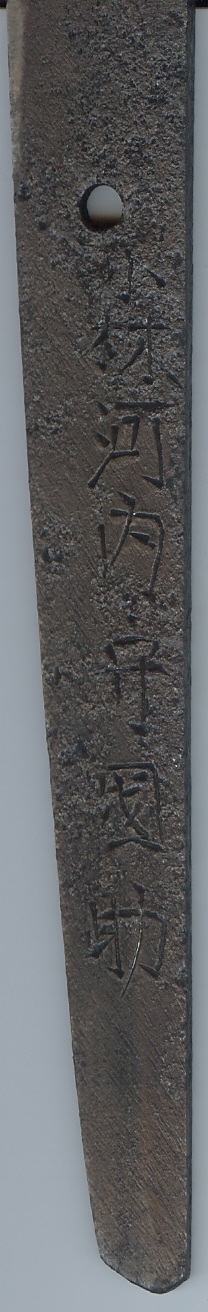

Sorry but it looks like neither to me. :doubt: There's quite a few discrepancies in the mei. The "kuni" is especially suspicious in form, but others lack in form and confidence as well.
Is it a papered piece?

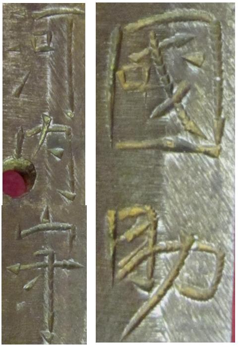

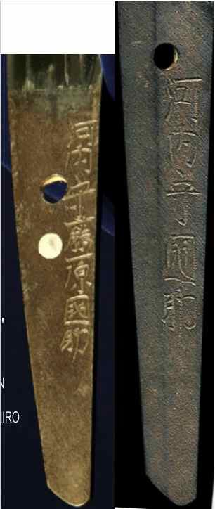

To my German co-members:forget the "Schnaeppchen" (good/very good deal).The Katana at the Lempertz-Auction to come has a Gimei (I got an extra pic with the Mei from them).The faker didn't even try to chissel the Mei exactly like the ones from Shodai or Nidai (or Sandai or Yondai).Look at the pic ,where I have put together all the Kanji in 2 rows.I am very familiar with the first 2 gen.Kawachi no Kami Kunisuke,because that theme was part of our Conundrum some years ago.Ludolf
