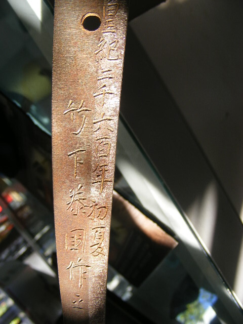

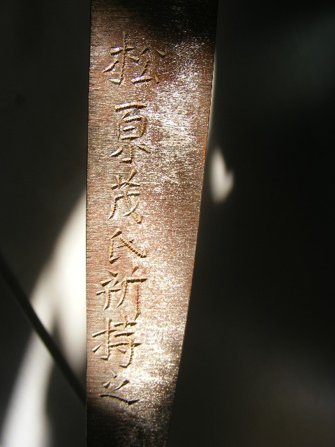

LeeVanSpleef Posted November 10, 2010 Report Posted November 10, 2010 Thanks in advance for any assistance. I own a little gun shop and just took this in from the grandson who brought this home with him from the war. I have spent the past two days trying my own hand at it, and this is what I've come up with - Yuki Masa Yasu Kuni Saku Kore. Of course, I could be way off but I am pretty sure this came from the YasuKuni Shrine. The right side (first picture) I believe to be the date, and the right hand inscription on the left side (second picture) I believe either to be a patriotic message or the person who polished the blade. My brain went a little haywire after getting as far as I did so I thought if there is anyone out there who could take over I would appreciate it. I will be putting this up for sale when I get a solid identification on this, so yes there is some commercial interest in this. Once again thanks! -E.V. Sandberg Quote
cabowen Posted November 10, 2010 Report Posted November 10, 2010 carried by Mr. Matsubara Shigeru Koki 2600 Nen Shoka (early Summer, 1940) Takeshita Yasukuni kore (o) saku (made by Takeshita Yasukuni) Special order gendaito....Any pictures of the blade? Edited to add: No relation to the Yasukuni Jinja.....He was a rikugun jumei tosho and lived in Hakodate city in Hokkaido.... Quote

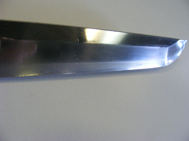

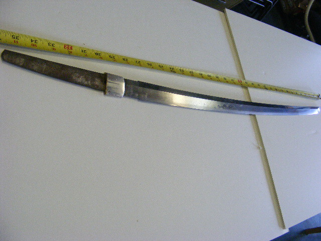

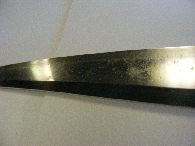

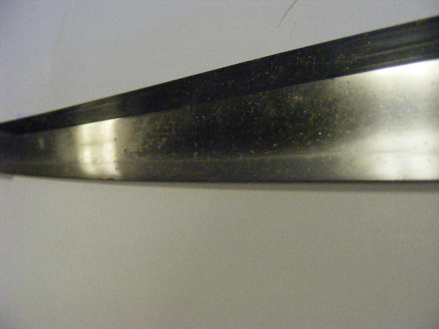

LeeVanSpleef Posted November 10, 2010 Author Report Posted November 10, 2010 Ok it is NOT related to the Yasukuni school? Blade has old oil and some "handling"? marks. I tried to get pictures that would illustrate that need for a professional cleaning. Quote
LeeVanSpleef Posted November 10, 2010 Author Report Posted November 10, 2010 More .. I also have pictures of the military fittings, all marked "45" Quote

Brian Posted November 11, 2010 Report Posted November 11, 2010 Hi...E.V? Pity I am unable to easily ship some of my antique pistols to the USA. I would like to oneday start clearing the few I have and trading them for Japanese swords. Anyways.... Just wanted to emphasize that this one has nothing to do with the Yasukuni Shrine at all. It is purely the fact that the Smith's chosen name was the same as the shrine. But there is no further tie in. This looks to be a decent Gendaito in need of a polish oneday. I personally don't see any need to paper it, as they are just going to tell you what you already know...it is made by Takeshita Yasukuni in 1940. Little chance of a fake signature here...so not too much need to paper it or confirm the mei. Afraid it won't fetch the (inflated) prices that many of the Yasukuni-to fetch, but still a nice item IMHO. Regards, Brian Quote
