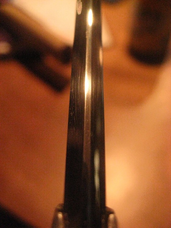

b.hennick Posted November 6, 2010 Report Posted November 6, 2010 Here is a picture I took of the sugata of the blade. Judge for yourself. I had a composite photo of the other side and put the two sides together so that you could see the matching hamon on both sides of the blade. Quote

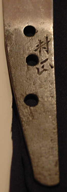

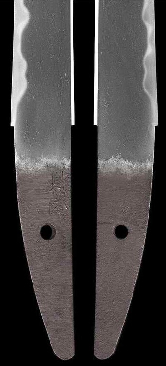

Curran Posted November 6, 2010 Report Posted November 6, 2010 Jim, Barry, Eric, Micha, I'd like to ask some questions here if you guys can field them. My intent is purely to understand, as I have a harder time with blades than fittings. I have a particularly hard time being sure of the authenticity of signatures.... mostly with some shinto and shinshinto swords. Not sure why my brain is so Yin vs. Yang on why the ability to reliably vouch for signatures in fittings doesn't transfer over to blades. I've hesitated to ever tackle the topic of Muramasa signatures, due to the sheer number of gimei out there. Q1: Are the Aoi Arts tanto and Barry's suppose to both be the same nidai signatures? If so, can you explain to me the differences in the signature? By this I mean some of the atari appear to me dramatically different. Are there several accepted verions of his signature? Q2: I like Barry's tanto better. In the Aoi Arts photos, it looks like the hamon runs clean off the blade for a stretch in the middle, even the nie gone in that region, but that it has been painted for continuity. I'd heard or read that the hamon often ran off before the hamachi and that this was to be accepted in some Muramasa blades? But in the middle? Anyone else think the hamon runs off the Aoi Arts one? If I'm just "talkin crazy", it is fine to say so. There is also a Muramasa up at Ginza Choshuya now. These do seem to come in waves. At one point I would have liked to own the Muramasa house yari Darcy had. Koshirae was a dead match to a tanto koshirae I own and love, and legend of Muramasa blade in a house yari had added aesthetic appeal. Hozon papers or not, don't know what to make of the Aoi Arts tanto. Quote

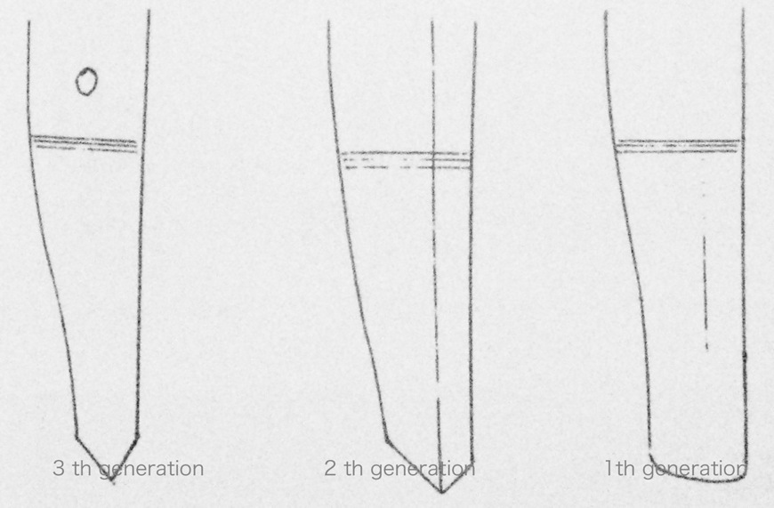

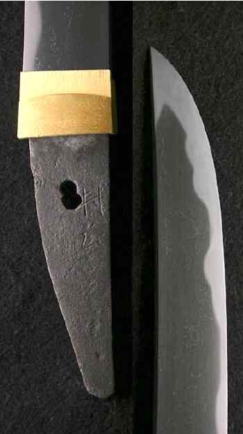

micha Posted November 7, 2010 Report Posted November 7, 2010 Dear Curran, Good questions. Mostly you can see it on the nakago jiri if it concerns tanto blades. I've add a picture that speeks for itselfs. M. Quote

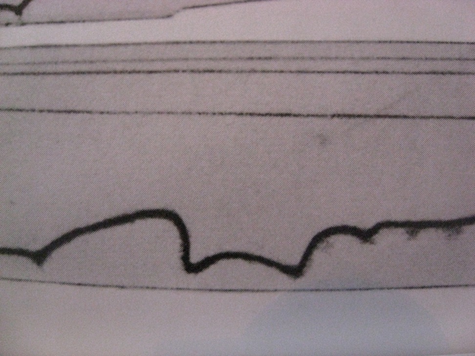

micha Posted November 7, 2010 Report Posted November 7, 2010 The difference in the signature is explained in Satô Kanzan sensei's 'Ise no Tôkô'. MURA-caracter (1) & (2) are found in signatures dated 1501 (3) & (4) are found on blades dated 1504-1521 (3) & (5) are found on blades dated 1573-1592 Caracter (3) is found in all periods and you should be carefull, almost all of the fakes have this caracter. The tanto of Mr. Tsuruta seems to me the 5th version (i've made a layered picture, see below) M. Quote
micha Posted November 7, 2010 Report Posted November 7, 2010 SORRY this was the MURA-caracter ofcourse. Quote
Jim P Posted November 7, 2010 Author Report Posted November 7, 2010 Greetings ! Curran I am with you to my untrained eye the signature looks different the one at Ginza Choshuya does not show the mei can not tell if hamon runs off the blade I will leave that call to someone with more experience it does have that polished a lot look Quote
micha Posted November 7, 2010 Report Posted November 7, 2010 MASA-caracter (1) 1501-1504 (2-5) 1504-1528 (5-6) 1532-1555 (7) 1573-1592 ( unclear but estimated around 1570-1573 In the Aoi- blade the masa carater is not very clear but I found an oshigata of the second gen. that fits almost perfect (see picture). Quote

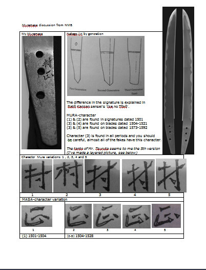

b.hennick Posted November 7, 2010 Report Posted November 7, 2010 I have been enjoying this thread. I took the opportunity to work on the images presented and to make a little summary. I could not upload a Word document so I took screen shots of the two pages and am uploading them a pictures. If you want you can print them out as a quick summary. Quote

Brian Posted November 9, 2010 Report Posted November 9, 2010 A big thank you to Barry and Micha for the Muramasa document, which I have uploaded and converted to .pdf. It can be viewed here: http://www.militaria.co.za/articles/Muramasa.pdf Brian Quote
micha Posted November 13, 2010 Report Posted November 13, 2010 Hi all, Although I posted the picture of the nakago-jiri, I think 1th and 3th generation should be switched. This is my opinion after many many oshigata and pictures I've been looking at the past weeks. My apology to mr. Kataoka Ginsaku who made the picture I posted before. This is my personal opinion. Micha Quote

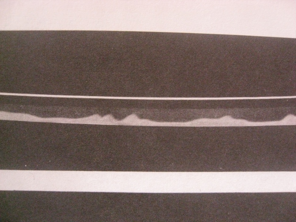

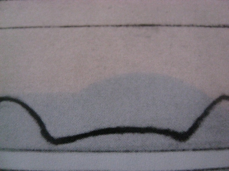

Jim P Posted November 14, 2010 Author Report Posted November 14, 2010 Hi all, I thought I would post the answer to the last question I asked. I found this in( facts and fundamentals of Japanese swords- page 91) A hamon that runs off in the Tani (valleys) are caused by polishing and repairs and it is not a desirable condition, Muramasa blades often have this characteristic and if it was some other smith most would hate it. Also Micha has said that 1th and 3th generation should be switched. is that the consensus of the board ? thanks Quote
cabowen Posted November 14, 2010 Report Posted November 14, 2010 Hi all, I thought I would post the answer to the last question I asked. I found this in( facts and fundamentals of Japanese swords- page 91) A hamon that runs off in the Tani (valleys) are caused by polishing and repairs and it is not a desirable condition, Muramasa blades often have this characteristic and if it was some other smith most would hate it Why do you think that there aren't those that hate it in Muramasa blades as well???? Quote
