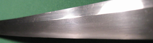

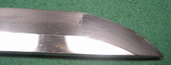

Mumei, maybe O-suriage, but some don't think so - I happen to think it was cut down tachi ?-
That said I dont think it was ever signed - hope not !~ It is out for polish - will re=post new pics but this isn't too bad a blade and whomever mounted it agreed, I hope it may be a late apprenticeship situation as it is late kamakura - early muromachi. Mumei or not - I still like it!
Looking at the nakago and boshi, I would be tempted to believe it is a bit later than early Muromachi-Late Kamakura.....more like Mid Muromachi at the earliest....
A few questions about suriage. Most of the pics I've seen that were suriage the nakago was cut straight off and the ana were left empty. But the one in the previous post is rounded on the end, as mine is. Also the old hole was filled with copper on mine. Was there a certain time period when they were shortening blades that it was the norm to round the end off after cutting it down? And why were some holes filled? ((Love that blade btw.)
I love having the opportunity to read through threads like this one. You guys rock!
Wasn't my call - but when returns from polish - should be soon will re=take pics and maybe see if anyone can give it an attribution other than the one I have which is NaoeShizu.
Does it not look suriage to you though?
