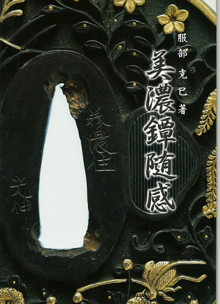

Pete Klein Posted October 30, 2010 Report Posted October 30, 2010 I found a very similar example in the Japanese book on Mino Tsuba. It is from mid/late Edo Jidai: Quote
John A Stuart Posted October 30, 2010 Report Posted October 30, 2010 That helped Pete. The signature on your tsuba close-up is by 光伸 Mitsunobu, 天吉 Tenkichi, died around 1650. He may be the same artist as 光仲 Mitsunaka. Maybe this is what I've misread the posted tsuba should be read as. The last kanji was hard to see a little. It is nice to see a signed mino-bori tsuba in any event. John Quote
