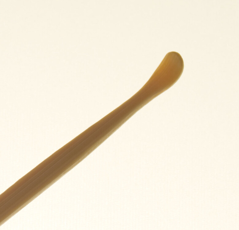

Re the mimi kaki (as found on a kogai): This may sound a little silly but I have always had some reservations about it being an ear cleaner. Have you ever tried to clean your ears with one? I have, and it is the most ill suited tool for the task. Its about as useful for that particular purpose as a flywire canoe would be for towing a water skier.
Could it be that the mimi part of the name only refers to the shape of the thing (being a small ear-like shape, and its similarity to the ear cleaning toll of the same name), and all it really represents is a handy projection by which it can be lifted out of its slot in the saya. I dont believe for one moment that samurai as a group were so afflicted with excessive ear wax that it would require a special tool to be at hand and carried around constantly. I mean how often do you really need to clean your ears out during the course of a day?
I think perhaps the theory of the kogai being a sort of general purpose handy tool makes a great deal more sense. The term Kogai has and is of course used for the long pins that Japanese women decorated their hair with, so the association with a hair dressing implement is well established.
Edit: Line one and four, edited for clarity.
Just from seeing the different styles of kogai, from wari to plain, I think it was a multi purpose tool. it was used for feeding, hair, and probably 100 other daily tasks. I think it was the Samurai equivalent of a spork.
Thanks Guido....... The real deal as in your pic has a nice long slender stem, ideal for the purpose. The stem on the kogai version is much shorter so that it cannot function as efficiently in this capacity (unless of course you want to ram the broad end of the kogai into your aural canal....... Not recommended). Hence my observation.
(unless of course you want to ram the broad end of the kogai into your aural canal.......).
There are quite a few people in Japan who pay good money for exactly those kinds of kinky intrusions into their orifices ... maybe you're on to something here ... :rotfl:
