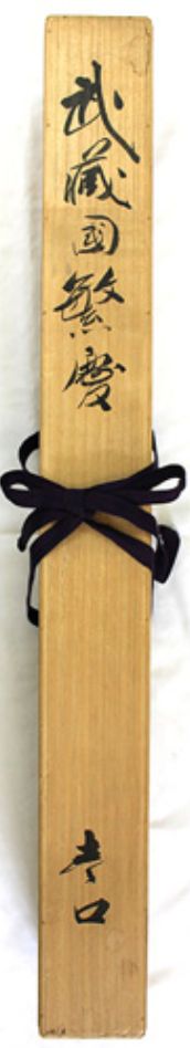

Jim P Posted October 16, 2010 Report Posted October 16, 2010 Hi all, Can some one enlighten me on this presentation box. what is on the box ? this is the link. http://www.nipponto.co.jp/swords/JT988958.htm Thank you
cabowen Posted October 16, 2010 Report Posted October 16, 2010 My best guess is that the top says Musashi no Kuni Shigehiro Hankei (is correct) The inside says that it is a niji mei blade that belonged to the Mito Tokugawa with a showa date and signature of Kanzan (Sato). No doubt our Japanese members will correct the above as necessary.... edited to correct....
k morita Posted October 16, 2010 Report Posted October 16, 2010 Hi, Yes this blade is Hankei. *Musashi no kuni Shigeyoshi.(known as Hankei) *The 22nd ,Registered as juyo-token. A niji mei blade that belonged to the Mito Tokugawa. Showa 51 nen shogatsu (January,1976),signature of Kanzan (Sato) wrote.
Jim P Posted October 16, 2010 Author Report Posted October 16, 2010 thanks guys, so would you call it a Sayagaki ?
k morita Posted October 17, 2010 Report Posted October 17, 2010 where is the blade? Didn't you see this link? http://www.nipponto.co.jp/swords/JT988958.htm
Jim P Posted October 17, 2010 Author Report Posted October 17, 2010 Thanks Chris,Morita san, So its a hakogaki and is a guarantee of the object’s value and provenience ? does the NBTHK do this ?
Jean Posted October 17, 2010 Report Posted October 17, 2010 So its a hakogaki and is a guarantee of the object’s value and provenience ?does the NBTHK do this ? No, it is written opinion done by an expert, It is not a guarantee as it has no refund policy in cas of error :D NBTHK does not do it. They issue certificates which are also written opinion, not on Boxes but on paper.
Jim P Posted October 17, 2010 Author Report Posted October 17, 2010 Hi Jean, I got( hakogaki is a guarantee of the object’s value and provenience) from (http://wiki.chado.no/Hakogaki) and thought that as it was by shinsa judge Kanzan Sato maybe it was something like a Sayagaki so NBTHK. Thanks for the info
cabowen Posted October 17, 2010 Report Posted October 17, 2010 Normally a hakogaki, like a sayagaki, is an attribution to a maker and/or attestation of the veracity of the item contained. It can also include comments as to value, quality, provenance, age, physical description, etc. It is usually done by an authority or expert in the field. There are many fakes and forgeries of hako and sayagaki, naturally. In this case, it seems the blade has been awarded Juyo status by the NBTHK, thus once can feel fairly confident that the signature on the blade is genuine, regardless of whether or not the hakogaki is authentic. Odds are though that the hakogaki is indeed authentic....
