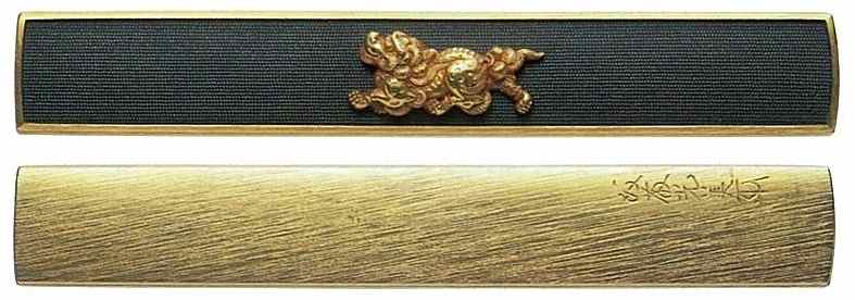

Marc BROQUIN Posted October 13, 2010 Report Posted October 13, 2010 Hello all, :D Please find herewith the mei of a fuchi, I had to determine for a friend of mine. It seems to be from Goto Senjo, the certificate (tokubetsu kicho) also says that. Any idea to confirm or not ? Thanks by advance. Best Marc Quote

John A Stuart Posted October 13, 2010 Report Posted October 13, 2010 Crazy, I forgot I had "Studies in Kyo-Goto" by Kasihara & Akimoto '88 and there are some examples of Senjo's work, pg. 195-197. There are minute differences in the mei, but, the kao is quite different with Senjo's looking very much like a plum. It has a triangular set of strokes in the interior not rectangular as the above specimen. Your's has a certificate, so who am I to counter it. Still though.......? John PS, I still like it too, Curran Quote
Curran Posted October 14, 2010 Report Posted October 14, 2010 John: I'm not actively collecting any more, but did always want a good Kaga or Kaga Goto piece. You and I talked about your before, and I haven't looked at it in a while. I'm glad to see it again and find my reaction is the same. I hope you enjoy that one for many years. Marc: I initially followed Mark's Kyo Goto book lead and must say the signature *does not* look good to me. My confidence interval on Goto is lower than others, - for a variety of reasons. But there are too many strokes just the wrong way or not right given the comparison mei in the Kyo Goto book. This morning I got out of storage some of the other Big Goto books and am going through them now to make sure there isn't something in the Waki-Goto that might be a fit. I've tried several times to get a working knowledge of the waki-goto uploaded into my memory, but it doesn't stick well. Let me try to dust off and see if there is anything in the waki goto. Quote

Brian Posted October 27, 2010 Report Posted October 27, 2010 Marc, Instead of a close-up of the mei, I would love to compare a close up of the work itself. How is the nanako and workmanship? I expect even if the papers are older and maybe not as reliable, it must be very good work to have gotten them in the first place. Brian Quote
Marc BROQUIN Posted November 11, 2010 Author Report Posted November 11, 2010 Hello all, :D Thank you first to all who made research and answered to my little request I just come back from the DTI where we went with Jean and more than 20 of our friends from the french KOKUSAI TOKEN KAI. We missed you a lot. I begin to emerge from my jet lag and take back the discussion about this FK. For John, you will find Shibui Swords in the Japanese Sword Index. His name is Elliot Long and he his member of JSS/US and NCJSC. His address is PObox 2103, Gresham Oregon 97030. Related to the main discussion, First of all, when you look at the various books, you find out that GOTO SENJO had a lot of variations in signature and kao. Despite the green paper attesting this FK to GOTO SENJO, I share also the thought that it can be a forgery. The pictures are certainly not good enough to look correctly at the work presented here. Some of his signatures and kao look like this one but some variations lead me to doubt this to be SHOSHIN So thanks again for your help and sharing ideas. Kind regards Marc PS : I will try to get some more pics of the work itself from my friend. Quote
Marc BROQUIN Posted November 14, 2010 Author Report Posted November 14, 2010 Hello all, :D I post herewith some new pics of this FK. It is more and more obvious the signature is not good. The nanako is not a Goto nanako at first and furthermore the takazogan is not so good to be Goto. I let you judge of that matter. Anyway best regards. Marc Quote
