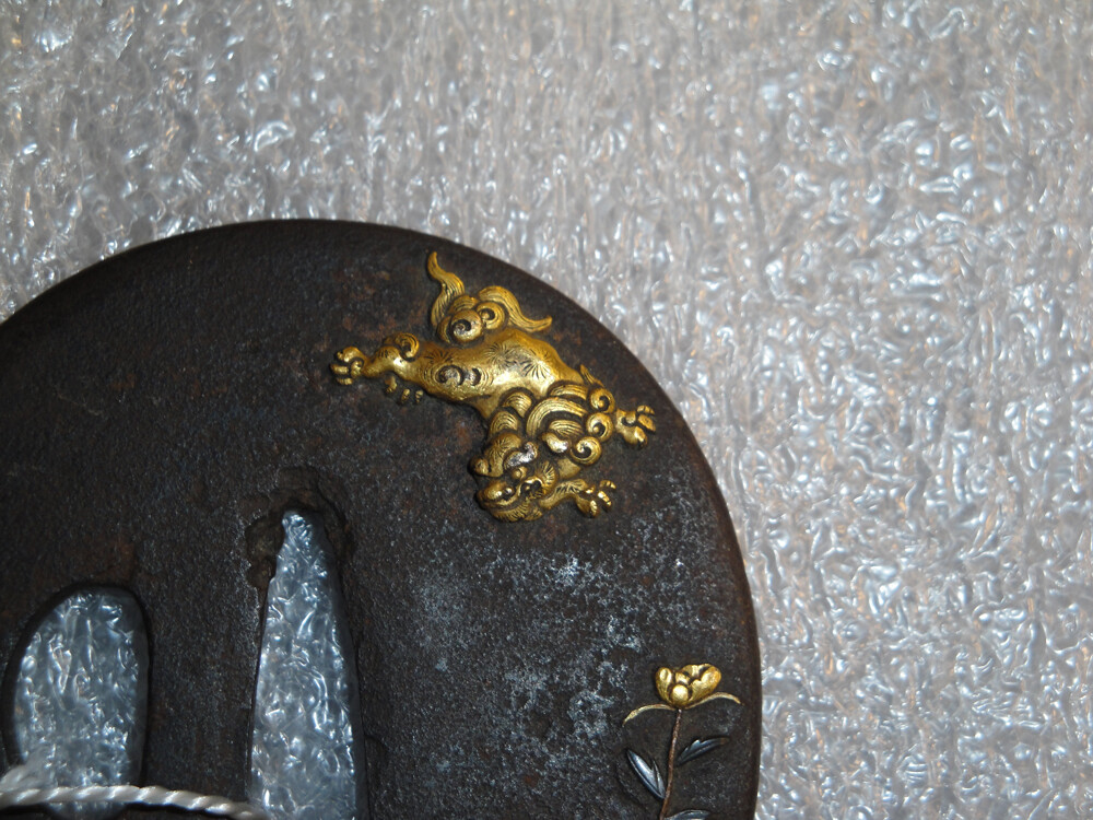

tiarnol Posted October 11, 2010 Report Posted October 11, 2010 I am an anthropology student who is doing a museum display case full of Japanese swords and i am needing some assistance in identifying and learning about some of their tsuba. All of these swords and tsuba are from our university museum. I have two tsuba and i have no idea where to start on figuring out what their designs represent or would have meant to the wielder of the sword it used to be attached to. One of them is depicting samurai on horseback and the other has a flower (not sure which kind) and a Fu dog(?not sure if i'm right). I'm also not sure how to find out about the time period they came from or what material they're made of. I would appreciate any help or suggestions i can get! Thank you so much! ~Tiffany Quote
Stephen Posted October 11, 2010 Report Posted October 11, 2010 Tiff IMHO both tsuba are worth more than all the swords you have, ill let the experts tell you about them, the first is Soten style and could use a light cleaning, qtip or light brush work with some oil. Both look to be iron with gold inlay. Two really nice tsuba. Quote

Curran Posted October 11, 2010 Report Posted October 11, 2010 Tiffany- You came to the right place. Post and ask about specific items (swords, fittings, etc.) and people should give you some very serious answers once this thread catches fire. Have a little patience with us at first. Too many people come here asking questions just so they can sell the items on ebay or elsewhere. The Soten tsuba looks nice, but is very much in need of a restorative cleaning before it deteriorates further. Quote
Marius Posted October 11, 2010 Report Posted October 11, 2010 The Soten tsuba looks nice, but is very much in need of a restorative cleaning before it deteriorates further. I agree with Curran. Unfortunately none of these tsuba is a masterpiece The Soten-style tsuba lacks detail, the soft metal inlays are quite messy. Signature is messy, too. The tsuba with the relief inlays of a shishi and a peony is in bad shape. I can't see any patina, only rust and dimples. The inlay work is mediocre and nothing special. Still, it is a tsuba wworth preserving. I must stress here that that both tsuba are GENUINE and worth preserving. Rust MUST be stopped, please read the following posts before you get your hands on the tsuba. It is easy to irreparably damage a tsuba: viewtopic.php?f=2&t=8087 viewtopic.php?f=2&t=7868 DO NOT proceed without having read them, lest the kami of the tsuba will haunt you at night Quote

Marius Posted October 11, 2010 Report Posted October 11, 2010 I have two tsuba and i have no idea where to start on figuring out what their designs represent or would have meant to the wielder of the sword it used to be attached to. One of them is depicting samurai on horseback and the other has a flower (not sure which kind) and a Fu dog(?not sure if i'm right). I'm also not sure how to find out about the time period they came from or what material they're made of. I would appreciate any help or suggestions i can get! You are right about the Fu (it is a shishi or kara-jishi, a Chinese guardian lion). The flower is a peony. The inlays are made of: shakudo (black colour), an alloy of copper and gold, brass (gold colour), and suaka = copper (red-brownish colour). The base is iron in both tsuba. The motif of the Soten tsuba is hard to tell. I see a samurai commander holding a fan (gunpai), a mounted samurai with a bow (yumi) and a standard bearer. What story this relates to, I cannot say. The meaning of the shishi is buddhist - it is a beast of Monju Bosatsu (http://www.onmarkproductions.com/html/monju.shtml), while the peony symbolizes wealth and honour. What the Samurai scene means depends on the story behind it. Quote
outlier48 Posted October 11, 2010 Report Posted October 11, 2010 I find the "shishi and peony" tsuba quite impressive. However, maybe because of the condition of the "soten" tsuba (rust, lack of detail) or the missing 製 kanji we would normally find in the mei of such a piece, I do not find it a particularly good example of a soten tsuba and am wondering about its authenticity. Anyone else feel this way, or am I really off track here? Charlie Brashear edit: spelling Quote

Soshin Posted October 12, 2010 Report Posted October 12, 2010 Mariusz,Very informatiove website on Japanese Buddhist statuary. Thanks for that. I would agree I have used this website before it is very informative about Japanese Buddhism. I have used it to identify Buddhist designs and motifs in my tosogu. As well as identity details about some of my other Japanese art outside scope of this forum. To discuss the topic at hand I really like the second tsuba with the shi-shi and the peony. What school would it likely fall in to? I was thinking Nara but I could be wrong. As for the Soten tsuba (i.e. first tsuba) this school went into near mass production during the late Edo. The early tsuba of the Soten were masterpieces. Yours truly, David Stiles Quote
