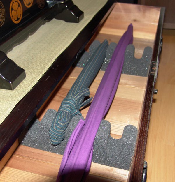

Guido Posted October 12, 2010 Report Posted October 12, 2010 Tom's photos show a traditional rack (which most of the times doesn't come with antique Katanadansu), so I used a non-traditional rack made of foam rubber that holds almost any kind of sword, being it a Shirasaya or full Koshirae. Tokugawa Art (Sanmei) used to sell it for Yen 2,000 or so, but they don't have it on their website anymore: Quote

Carlo Giuseppe Tacchini Posted October 12, 2010 Report Posted October 12, 2010 so I used a non-traditional rack made of foam rubber that holds almost any kind of sword, being it a Shirasaya or full Koshirae. Tokugawa Art (Sanmei) used to sell it for Yen 2,000 or so, but they don't have it on their website anymore: Guido, first alchool instead of uchiko, then foam instead of wood... you're destroying all my myths. :lol: This is a better idea than wood for a fireproof safe. Shape seems easy to be worked out from large pieces of foam, fixed with velcro to adjust the length when collection changes and it fits even non-Japanese scabbards, either more fat or slim. Think I'll give it a try... Quote
Ken-Hawaii Posted October 12, 2010 Author Report Posted October 12, 2010 Guido, that's a great idea! I never would have thought about using foam rather than cedar, but it's a darn sight easier, & we have both foam & velcro. If you ever get out here to Hawaii, I owe you a pitcher of mai tais!! (Beer, too.) Carlo, good guess on the bare blades. I can't afford Benson more than once or twice a year for togishi services, & have just started working with another local togi. Those blades are indeed behind safety glass in a locked case & with a dry-rod. 1 Quote
